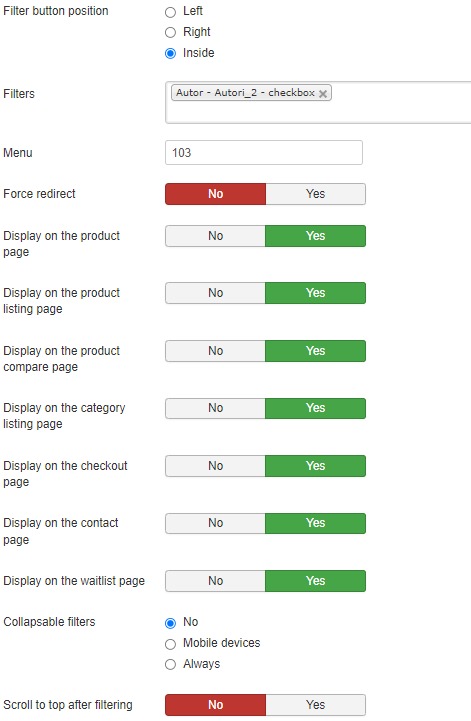

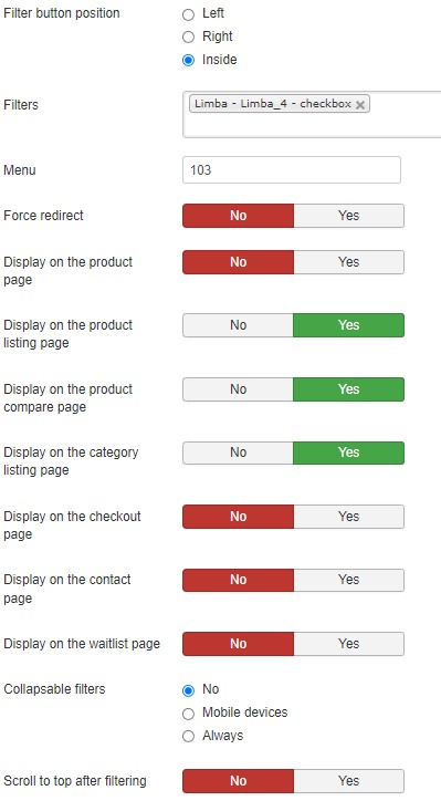

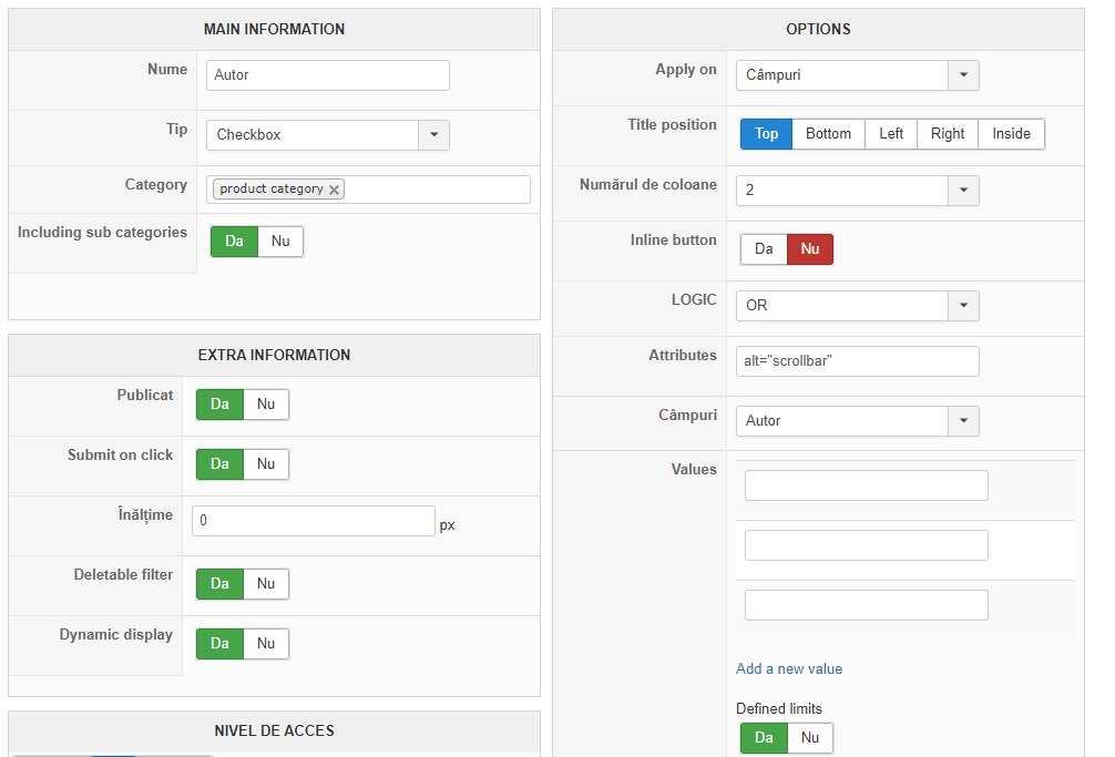

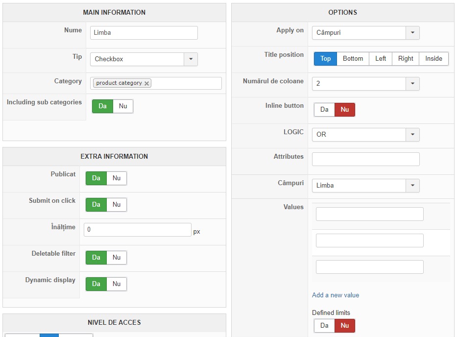

I have a similar problem with filters.
1) First, I select "author", after that I select the "language".
2) I remove 1 filter and both are " cleared"
3) I select language filter and both are back selected.
You need to play a bit with the filters, check and uncheck / remove filters to get this error.
This are the settings for filter "author" and module.
And this are the settings for filter "language" and module
  • Posts: 86080
  • Thank you received: 14188
4 years 6 months ago #339719
I think that the issue happens because you have your filters in separate filter modules and the system is made to update supposing that the filters are in the same module.
Delete one of the two modules and select both filters in the remaining module and it should hopefully work properly.
