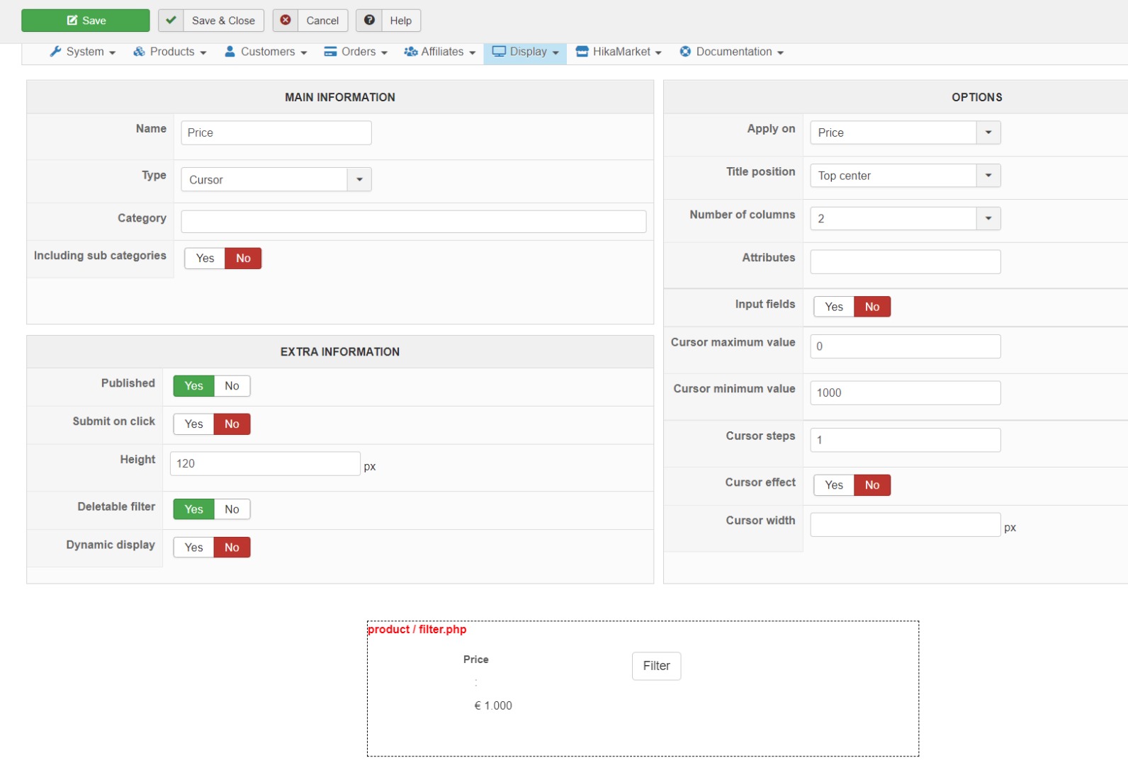

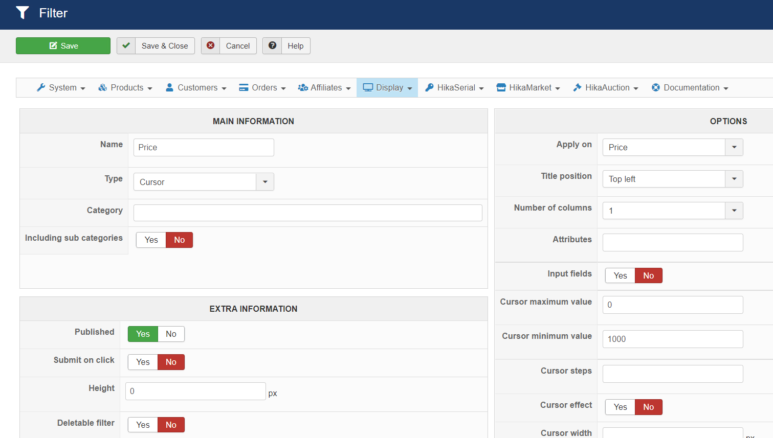

There is a bug with the cursor type filter
In the empty page, if Cursor maximum value = 0, I no longer display the maximum value.

  • Posts: 152
  • Thank you received: 11
4 years 11 months ago #335673
I'm building my first site with HihaShop. I'm still on the localhost
  • Posts: 86080
  • Thank you received: 14188
4 years 11 months ago #335678
Maybe it's because you didn't enter a value for the "step" input field ? I would recommend entering 1 for now.
Also, how after configured the other options of your filter, like the "dynamic display" setting ? Maybe changing the dynamic display setting might help.
  • Posts: 152
4 years 11 months ago #335685
Cursor steps> 1 or blank
Deletable filter > Yes or No
  • Posts: 86080
4 years 11 months ago #335689
From your screenshot of the problem on the frontend, it looks like a javascript error issue.
On the page, there must be a javascript error (which could potentially come from a conflict with another extension or a bug in another extension), which lead to the cursor not being initialized.
Fixing the javascript error, that you can look at in the console of your browser, should automatically fix the problem.
Could you provide the URL of the page so that we can check what javascript error you have ?
  • Posts: 152
4 years 11 months ago #335712
Localhost + Joomla 3.10 + Protostar template + Only HikaShop.
No javascript error in the console of browser.
As soon as possible I will try on a web server and not on localhost
  • Posts: 152
4 years 11 months ago #335768
Now it is clear!
In the HikaShop filter module the cursor maximum value = 0 option works only if Dynamic display = YES
If I associate HikaShop filter module with a NO HIKASHOP menu item, the Dynamic display option does not receive data and therefore does not display any maximum value.
  • Posts: 86080
4 years 11 months ago #335769
Well, you should enter 1000 in the maximum value and 1 in the minimum value.
Having 1000 as minimum and nothing as maximum is indeed not possible. I had overlooked that on your screenshot.

  • Posts: 86080
4 years 11 months ago #335808
Well, I don't know what you're selling. If the minimum is 1000, then ok, but you need to specify a maximum higher than the minimum.
