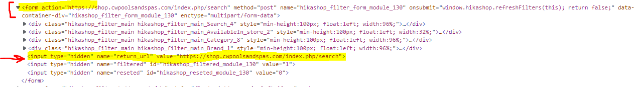

My filter module includes a long list of Brands that I'd prefer to collapse into a dropdown. But when I change the brand filter from a checkbox to dropdown the "enter key" no longer submits the form from the text field. The entire filter fieldset still works if the user clicks the "filter" button but a user should still be able to hit enter after entering text to submit the form.
I inspected the page and noticed that when a filter is changed to dropdown the form element and a hidden element are different
(No dropdown filter and enter key works fine)
<input type="hidden" name="return_url" value=" shop.cwpoolsandspas.com/index.php/search...&filter_Brand_1= ">
(With dropdown filter, enter key stops working)
<form action=" shop.cwpoolsandspas.com/index.php/search " method="post" name=hikashop_filter_form_module_130" onsubmit="window.hikashop.refreshFilters(this); return false;" data-container-div="hikashop_filter_form_moduel_130" enctype="multipart/form-data">
<input type="hidden" name="return_url" value=" shop.cwpoolsandspas.com/index.php/search ">
Any suggestions would be appreciated. Thank you.

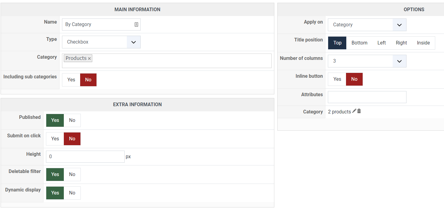

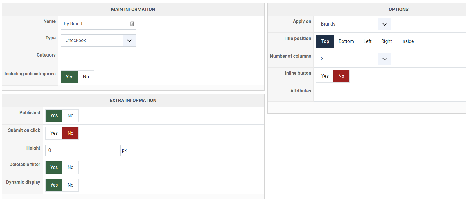

3 years 11 months ago #343411
First, check that in your Filter entry that you have activated the Submit on click option in the EXTRA INFORMATION part.
This option have to trigger the search just after a selection in your filter entry (dropdown or not)
If this option is activated, there are an issue, then provide these elements :
- your entry settings screenshot
- An Url link where we can experience your issue (with the dropdown activated)
Awaiting your elements to progress on your subject.

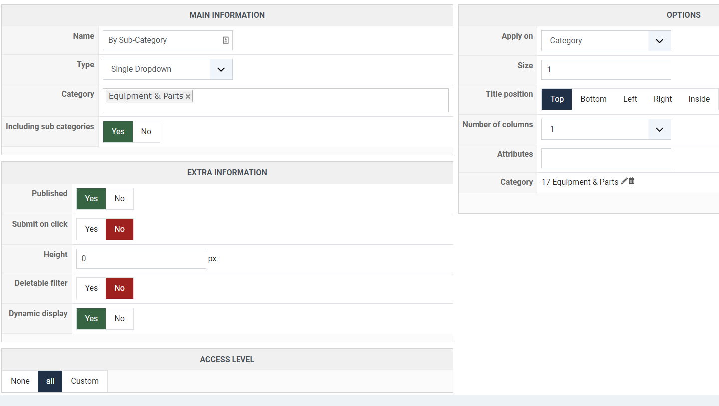

Working URL: (typing in the search field and then hitting enter submits the form)
Broken URL: (typing text in the search field and hitting enter does nothing)
shop.cwpoolsandspas.com/index.php/cat/6
The only difference between the Hikashop Filter Component is on the broken URL the "By Sub-Category" dropdown filter is visible. If I changed the "By Sub-Category" to a checkbox then it'll work on the broken page.
3 years 11 months ago #343431
hello,
Did you process the test with your filter "By brand" with the "Submit on Click" option activated ?
And as previously requested, we need to see your page with the dropdown as it's the condition to see your reported issue otherwise solve your issue will be hard.
Please, you must stick point by point to our indications, except for one reason or another that is not possible.
We have specific ideas in mind, but for that, be specific in your feedback.
Last edit: 3 years 11 months ago by Philip.
  • Posts: 16
  • Thank you received: 4
3 years 11 months ago #343438
Yes, the "By brand" "Submit on Click" is now activated and the results are the same for the page with the dropdown. When I type in the text field and hit enter key nothing happens.
