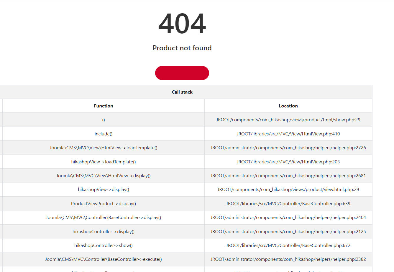

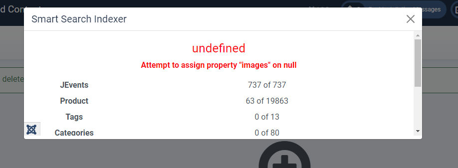

Hi, I cannot get 'search' to work in J4 and guessing its because J4 wont index products and stop at 63 every time?
I have followed a link to one that has indexed and the gives a 404 error?
See attached

I'm not following you. You're saying it doesn't display any error message.
But on your previous screenshots, I see the "Undefined Attempt to assign property "images" to null". That's an error message. Do you mean that you don't see that message anymore ?
Normally, with the debug activated, that message should display more information like the file path where the error is happening.
And that "Attempt to assign property "images" to null" should be logged in your PHP error log.

3 years 11 months ago #345069
Hi, No that message is still there, that is the only one shown on screen even with the setting at max. The next message I sent is what looks like information refering to this in the error in logs/error_log

Thank you for the access. I was able to do some debugging to understand the issue and made a patch.
The issue is that you have a variant pointing to a product which doesn't exist anymore in the database and the smart search tries to index it instead of ignoring it. This leads to a PHP error which would previously only generate a warning, but since you're on PHP8, it stops the process. So it's not really linked to Joomla 4, but to PHP8.
The patch fixes the issue on your website. We've included it on our end and it will be in the next version of HikaShop.
