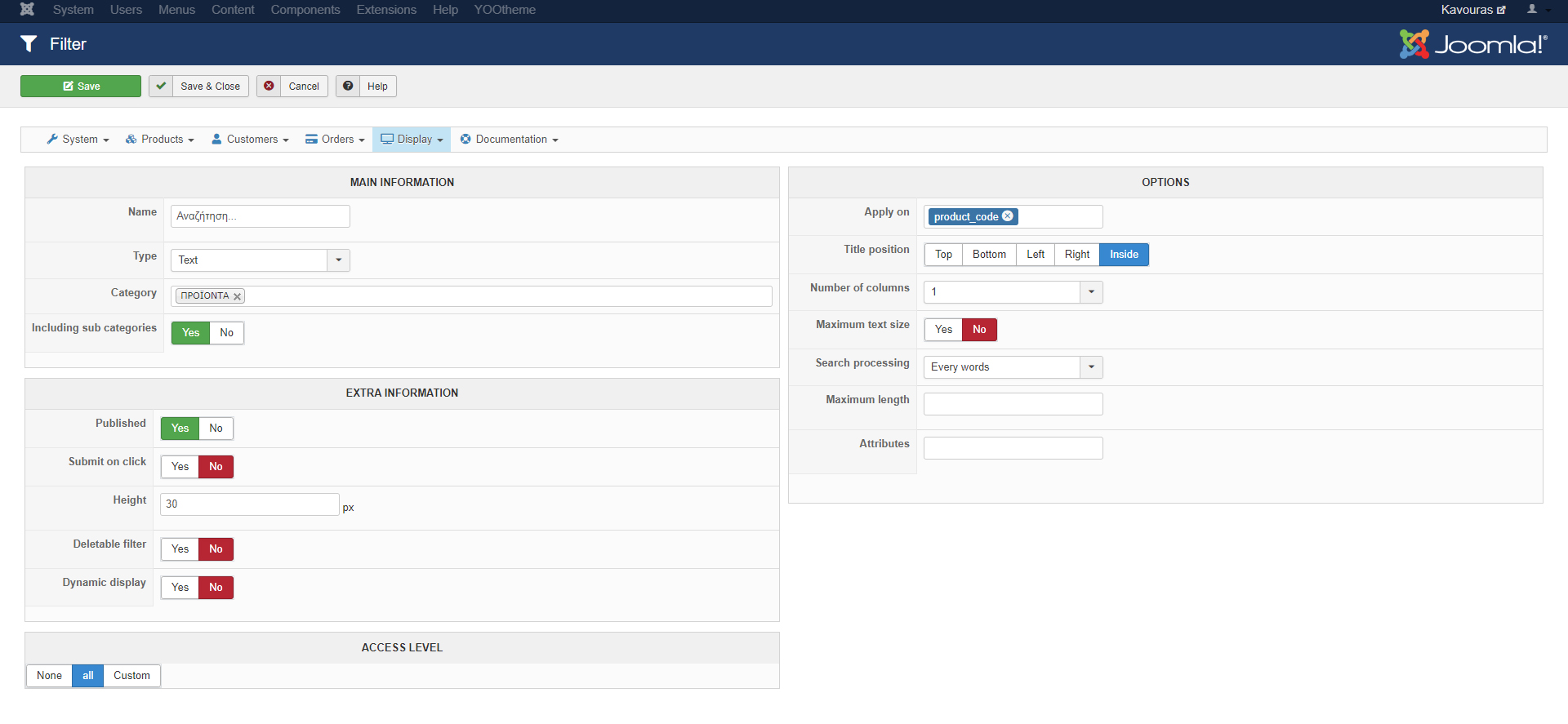

2 years 10 months ago #355632
Take a look on my screenshot, and especiallt red bordered part, this should get you what you need:
Last edit: 2 years 10 months ago by Philip.

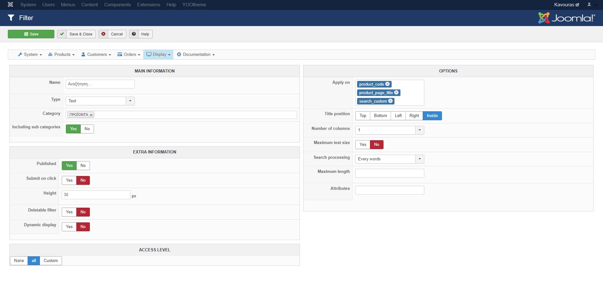

  • Posts: 1184
  • Thank you received: 13
2 years 10 months ago #355664
Hi!
I did it but it's not working. I need the search filter to apply to titles also not just code.
Thank you
  • Posts: 86080
  • Thank you received: 14188
2 years 10 months ago #355667
There is no option to dynamically apply modifications to the texts being searched.
What you need to do is to create a custom field of the table "product" and of the type "text" or "textarea" where you can enter the product code without the dashes. Then, in your filter, also select that custom field and you'll find results for the product code without the dashes.
And you can also create a mass action to automatically fill the custom field with the product_code without the dashes with a mass action of the type "update the values" on the column of the custom field with the "operation" mode and the value:
replace({product.product_code},'-','')
(not tested)

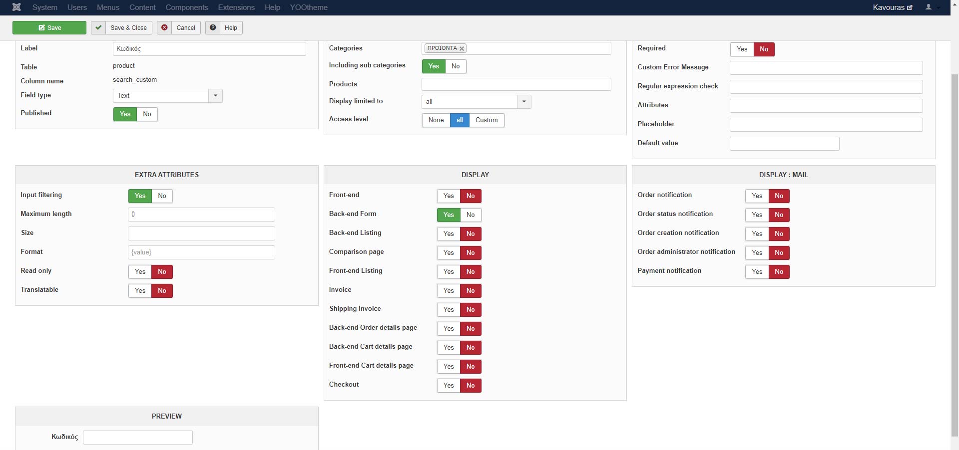

  • Posts: 1184

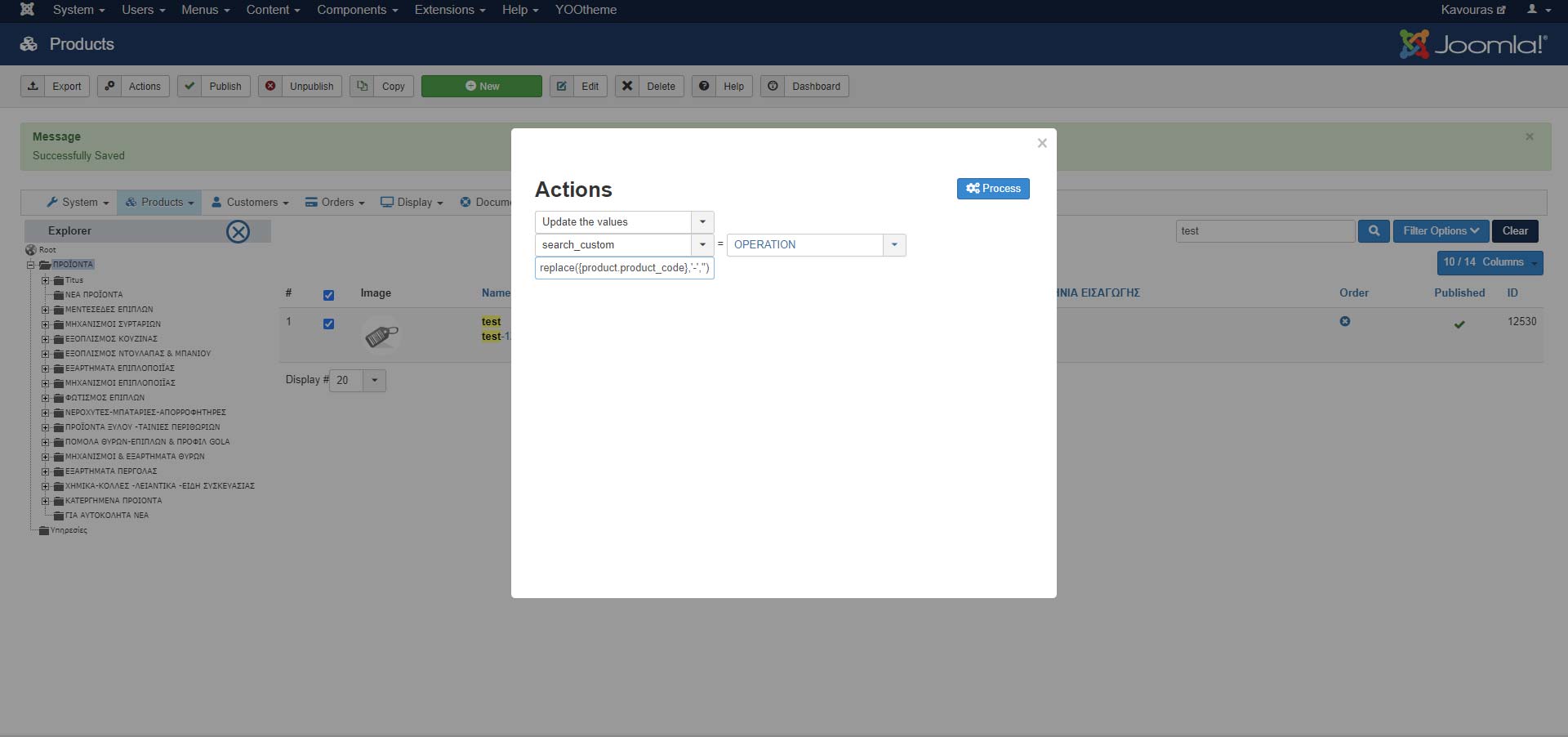

2 years 10 months ago #355719
Hi!
I created the custom field and did the filter as you said but the mass action didn't work.
The value of the custom field after i ran the mass action is 0.
Could you check the screenshots if everything is correct?
Thank you!
  • Posts: 86080
2 years 10 months ago #355725
I would recommend doing it with a normal mass action (with a filter on the product_id to target only one product first) and see if you get any error when you run it.
Otherwise, you could also try running a MySQL query directly in the database via PHPMyAdmin. Something like that:
UPDATE #__hikashop_product SET search_column = replace(product_code,'-','');
