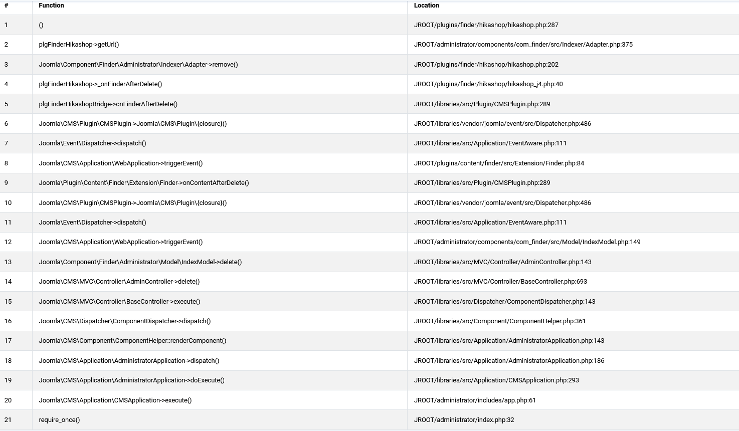

I just updated to the lastest version. I wanted to delete the index but I have a new issue, I can't delete it, it returns an error "Call to undefined function hikashop_get() "

2 years 4 months ago #360211
Hope it can help

2 years 4 months ago #360212
Thanks !
Add the line:
$this->setup();
before the line:
parent::__construct($subject, $config);
in the file plugins/finder/hikashop/hikashop_j4.php and it should fix the problem.
We'll add the patch on our end too.

2 years 4 months ago #360217
Thanks Nicolas.
Thanks yo your fix, I've been able to delete the index and rebuild it.
