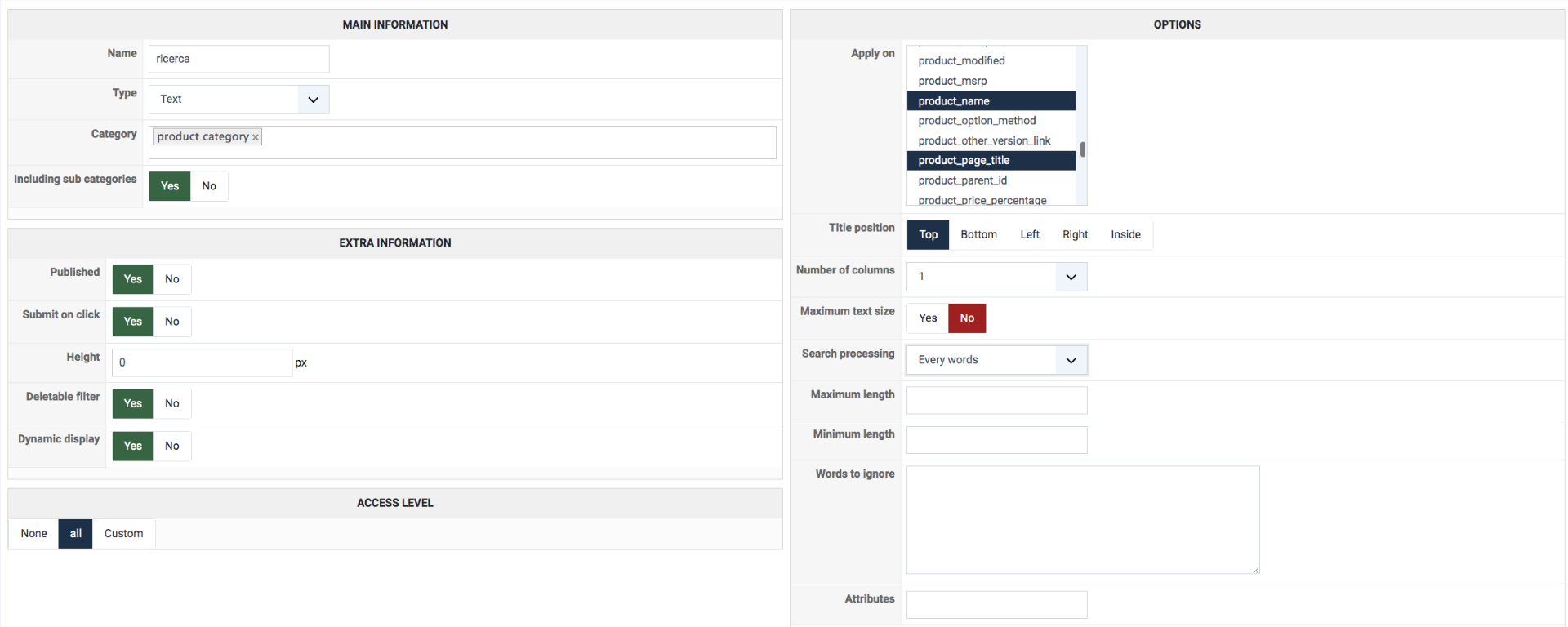

I'm trying to make a search field (text filed) that have the following behaviors.
i.e.
In a book shop there is a book with title "The Lord of the Rings"
If I search for "Lord Rings", at first will be displayed all books with both words (i.e. "The Lord of the Rings - The two towers" "The Lord of the Rings - the fellowship of the ring" etc.) in the title, than all books that contain any word ("lord" and "rings").
How is it possible?
Thank you
