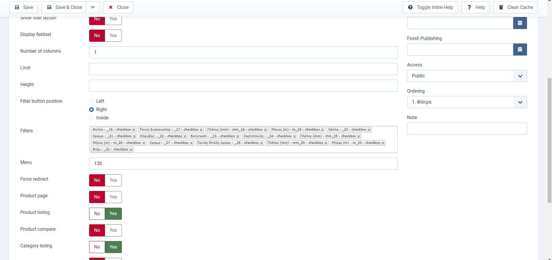

Hi!
How many filters can i add in a filter module? Cause i have to create many for every category so i don't know what is the best way here.
Can i have one module for all filters and categories? Or i have to create different filter modules for every product category?
Thank you

1 year 10 months ago #364010
There must be a limit cause i have 50 filters in my module and i cannot add more, every time i save the rest of them disappear.
I would prefer one module for all categories and display filters dynamically but it seems like that's not possible.

1 year 10 months ago #364015
Try changing the line:
$limit = 50;
in the file administrator/components/com_hikashop/classes/filter.php
We can change it to 100 in order to allow for more filters if that solves the problem.
