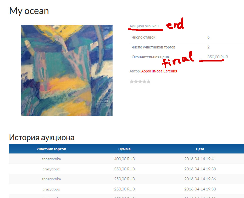

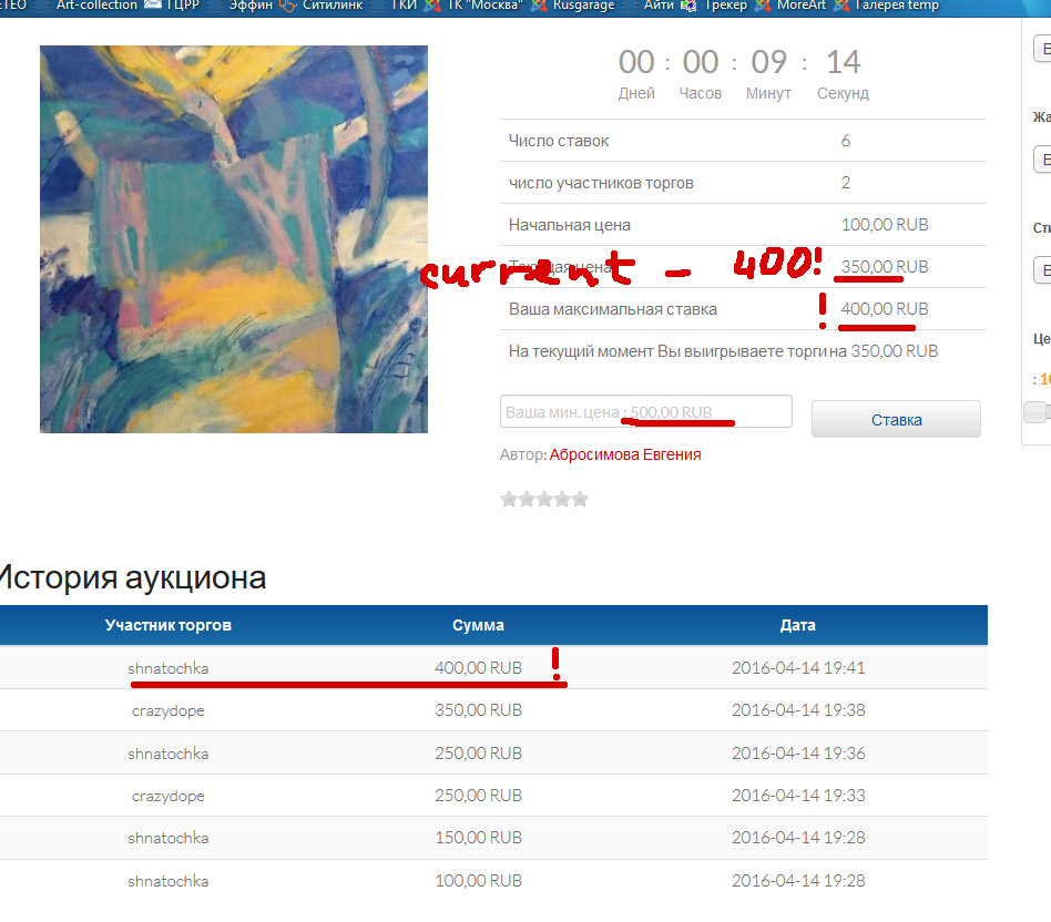

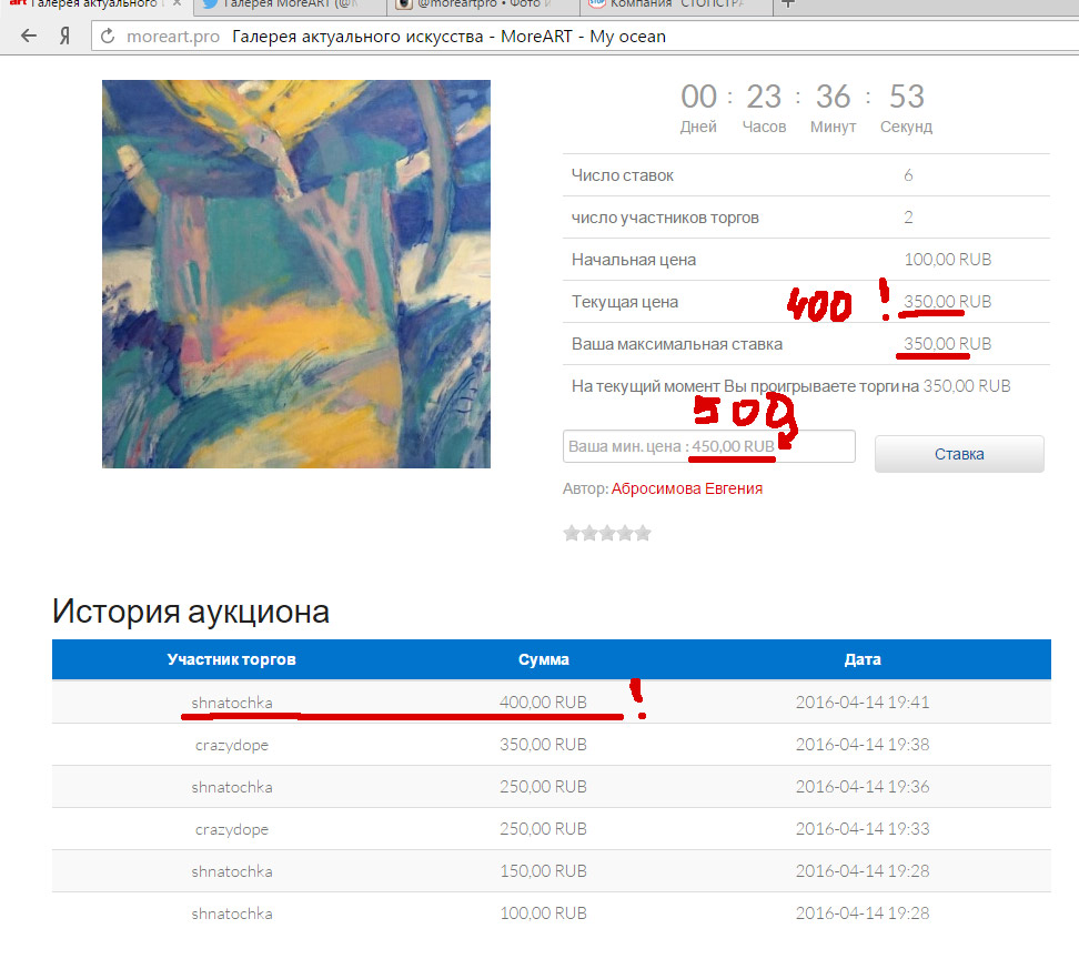

I changed the code .But the auction is not working properly. The current price is wrong, the minimum bet is wrong, the final price is wrong, but at checkout the price is correct. Th у first screen is from user Crazydope, the second is from Shnatochka a the one moment.

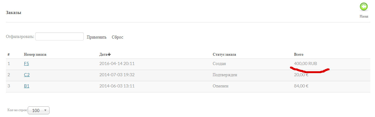

1. I only gave you the code that will enable you to change the value of the final price through the validation link, but for other location as :
- Current price
- Final price
That are displayed through your auction page, you'll have to edit the code of the "show_default" file of the "productauction" view via "Hikashop->Display->Views". For the Final price you'll have to change these lines :

Hello! Yahoo! I have done it even without knowing php! Thank you, Mohammed for your support.
To change the price of the auction you don't need to do the changes described in the previous messages. When the setting of the auction mode "Free bidding" you'll have to edit the code of the "show_auction" file of the "productauction" view via "Hikashop->Display->Views". You'll have to change these lines :
$current_price = $this->currencyHelper->format($current_price_amount, $this->element->prices[0]->price_currency_id);
by
$current_price = $this->currencyHelper->format($max_bid, $this->element->prices[0]->price_currency_id);
