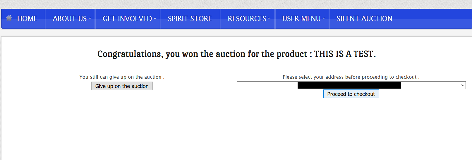

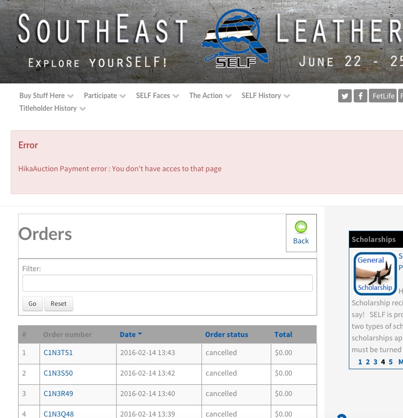

9 years 8 months ago #256195
I'm having a similar issue. I click the link provided in the email and end up with this. Please see screen shot 1 & 2. I am logged in and link goes to screen shot 1. When I click and go to screen shot 2, I haven't been asked for a credit card. The auction doesn't appear in my account history either. The winner appears in the history of the auction but not in the user account or the user order list.

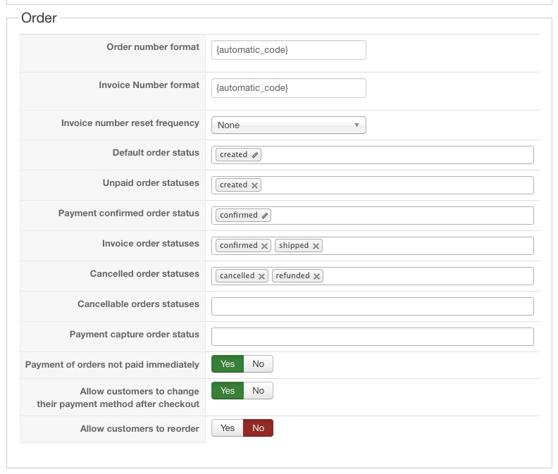

Are you sure that you have accessed to that link while being logged in with the Auction's winner account ?
Can you give us more information about your configuration order configuration via "Hikashop->System->Configuration->Main->'Order'" through some screenshots for example ?
Also, can you tell me which payment method you're using on your shop and if you have enabled the Hikashop "Payment of orders not paid immediately"* option via "Hikashop->System->Configuration->Main" ?

  • Posts: 65
9 years 8 months ago #256329
Yes, winners account is logged in. Payment of orders not paid immediately is enabled. Payment method is USAePay Plugin. See screenshot.
