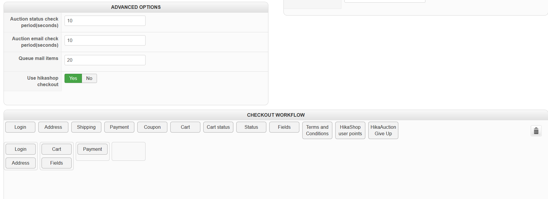

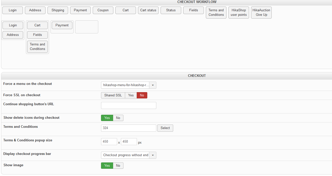

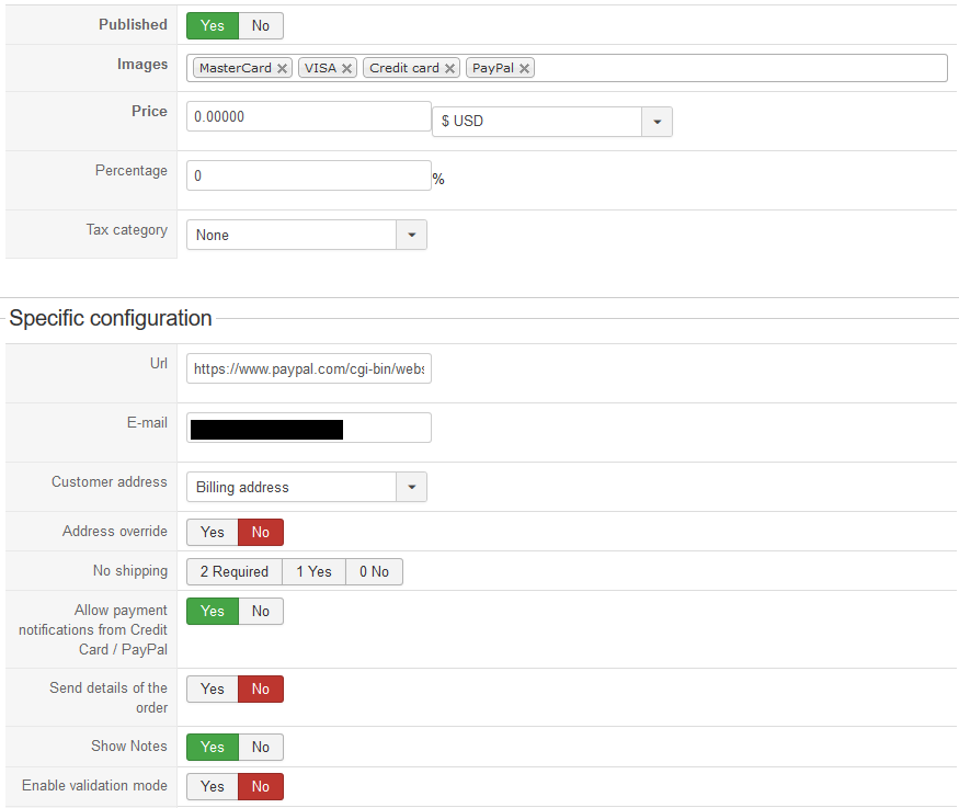

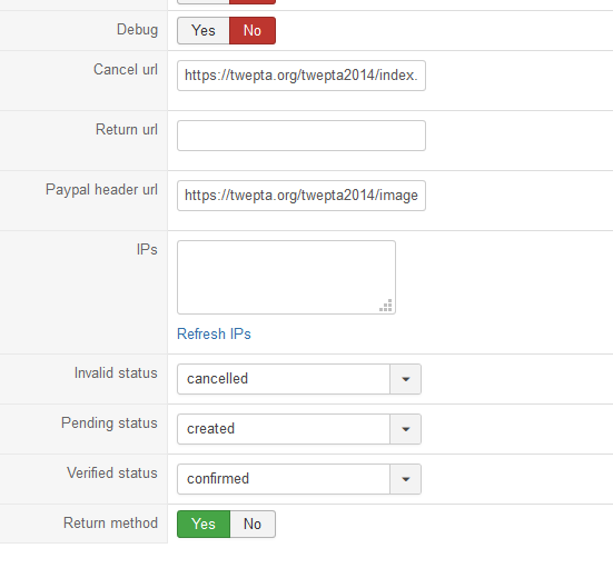

8 years 9 months ago #280950
Hi Mohamed,
Here's the workflow of hikashop
Payment setup for paypal (I had to remove the return URL so HA would redirect to paypal)
HA workflow
8 years 9 months ago #280978
Thanks for these information.
We'll try to reproduce it on our end and fix it but the "Return URL" option of your PayPal payment method is only supposed to affect where your customers will be redirected after paying for their order through PayPal platform.
  • Posts: 105
  • Thank you received: 9
8 years 9 months ago #281019
Agreed. The return URL should only affect where the user is directed after the payment at Paypal. But when trying to pay for an item thru Hika Auction, after clicking payment method of Paypal and proceeding, I was not redirected to paypal, but instead went directly to the the return URL address. Hopefully this helps :) Please let me know when you figure out this one! Would love to be able to put the return url back in.
