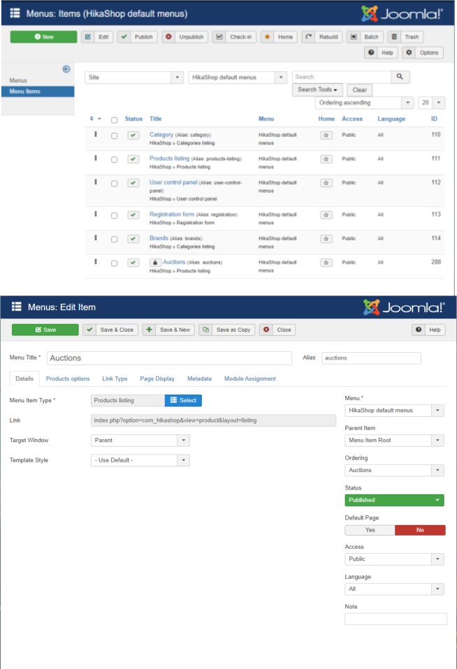

The Auction Menu that I am using is:
* Hikashop default Menu that is generated called Auction.
I added the CSS for the page called auctions.
So far, as I said in my email below, every thing is working as expected and the auction page is working as well with the expected styles, but when you click on the button in the Checkout page to Give Up Bid it brings you to the page:
index.php/component/hikaauction/?ctrl=auction&task=cancel_auction&product_id=
When that page comes back it doesn't pick up the auctions style, so all of the Modules that I have used are all showing on the page.
I just want to know how I get that ' cancel_auction' page above to attach to the Hikashop Default Auctions menu so it fixes the module and style problem.
Hope that is enough for you to help. I have added the Hikashop Default Menu screenshot
Thanks for your time.
Kind regards
Jennifer

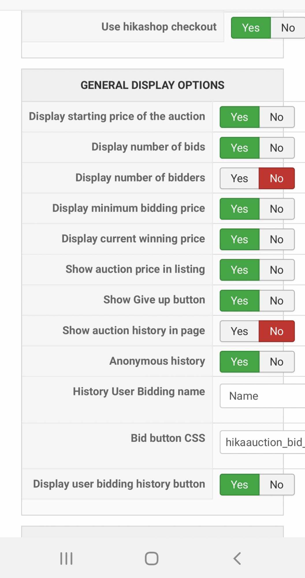

Note that you can also set the "Use hikashop checkout" option to YES through "HikaAuction->System->Configuration" and configure your Auction checkout workflow which should fix all of your issue.
Kind regards,
Mohamed.
  • Posts: 46
5 years 11 months ago #322058
