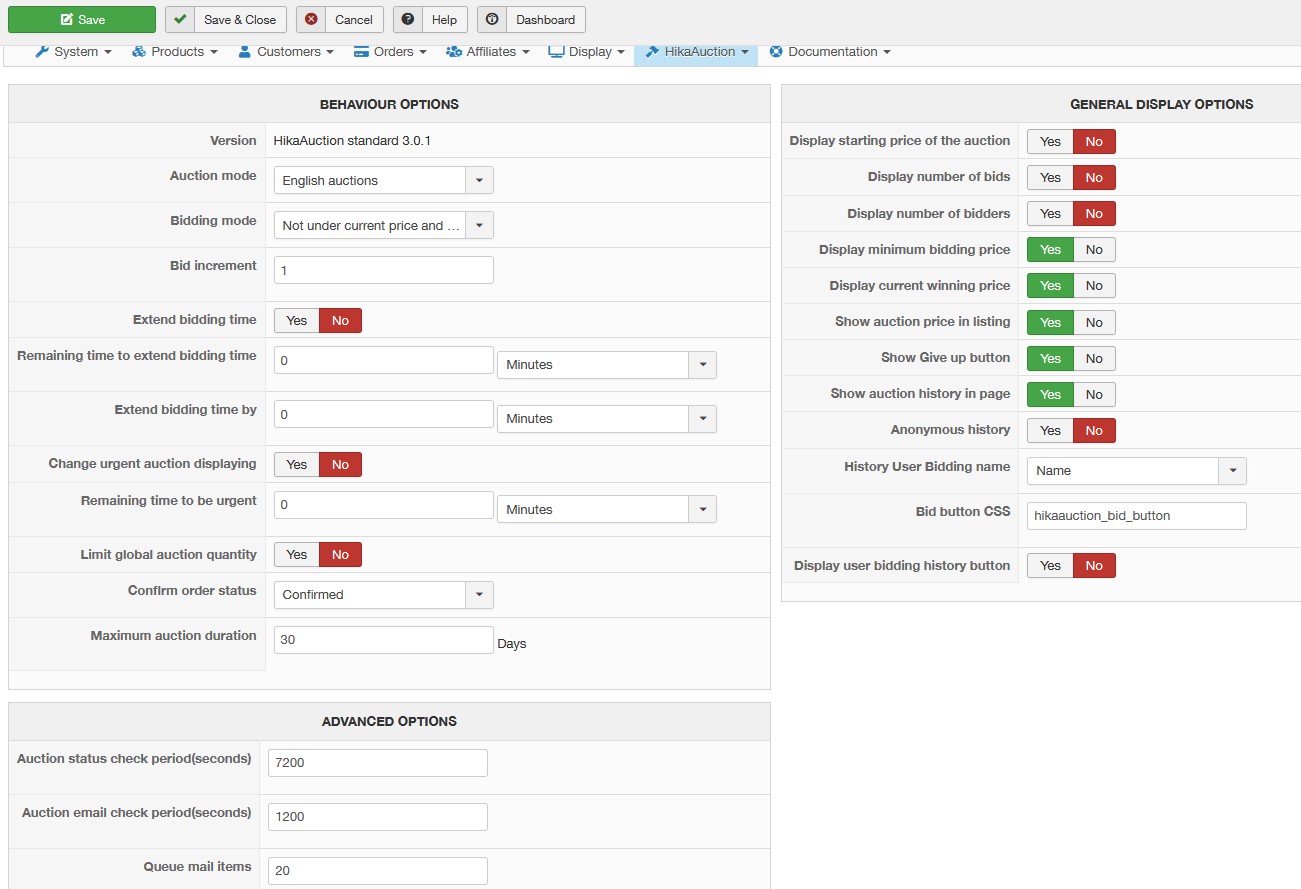

Firsly can you show us how you configured your HikaAuction options via "HikaAuction->Configuration", so that we can reproduce and debug it on our end ? Especially "Bidding/Auction mode" options.
Kind regards,
Mohamed.
  • Posts: 30
5 years 7 months ago #325966
Here's the config page.

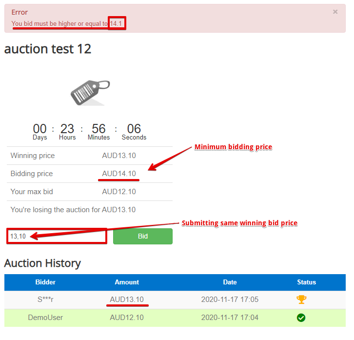

That's weird, here is what I get when I test it with the same configuration :
We'll need step by step instruction to reproduce it.

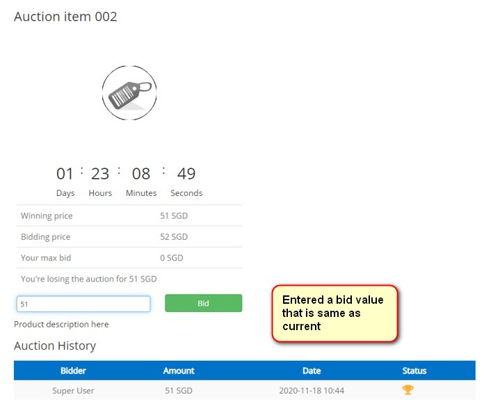

Oh this is a good error message to have but it does not appear for me...
For me, the page will just reload to the top upon clicking the Bid button if bid is lower than Bidding price.
Is there a setting to enable this?

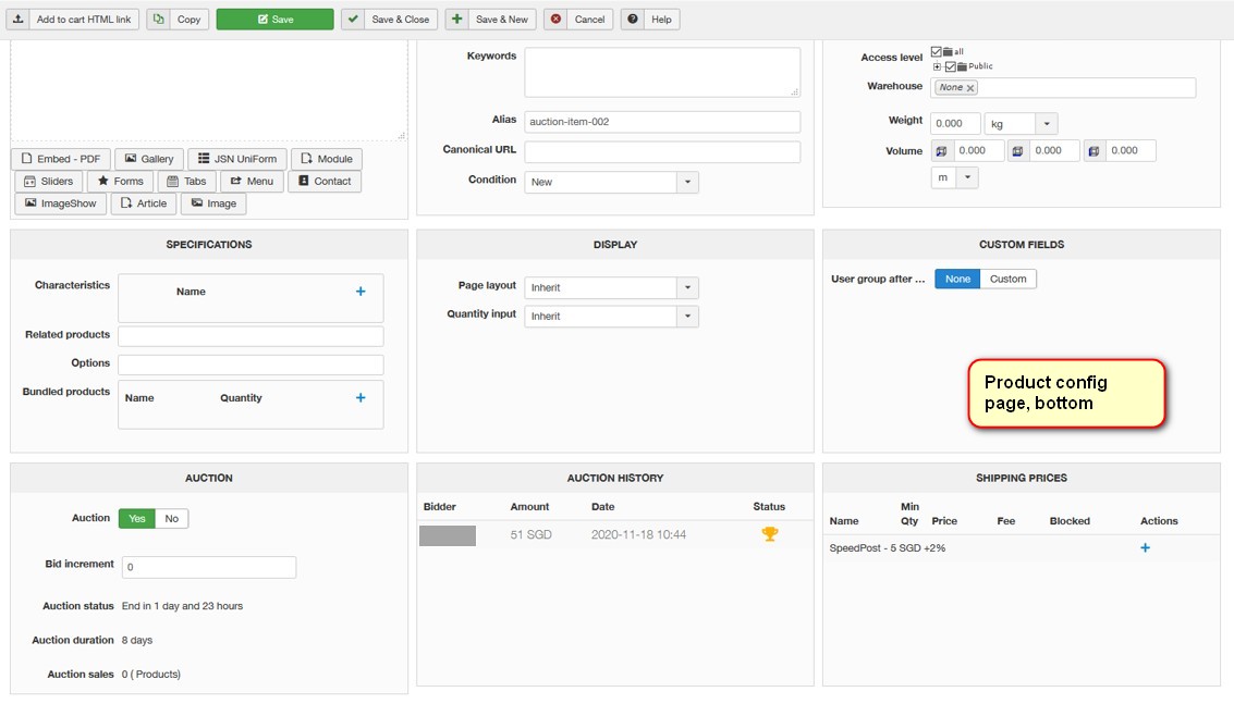

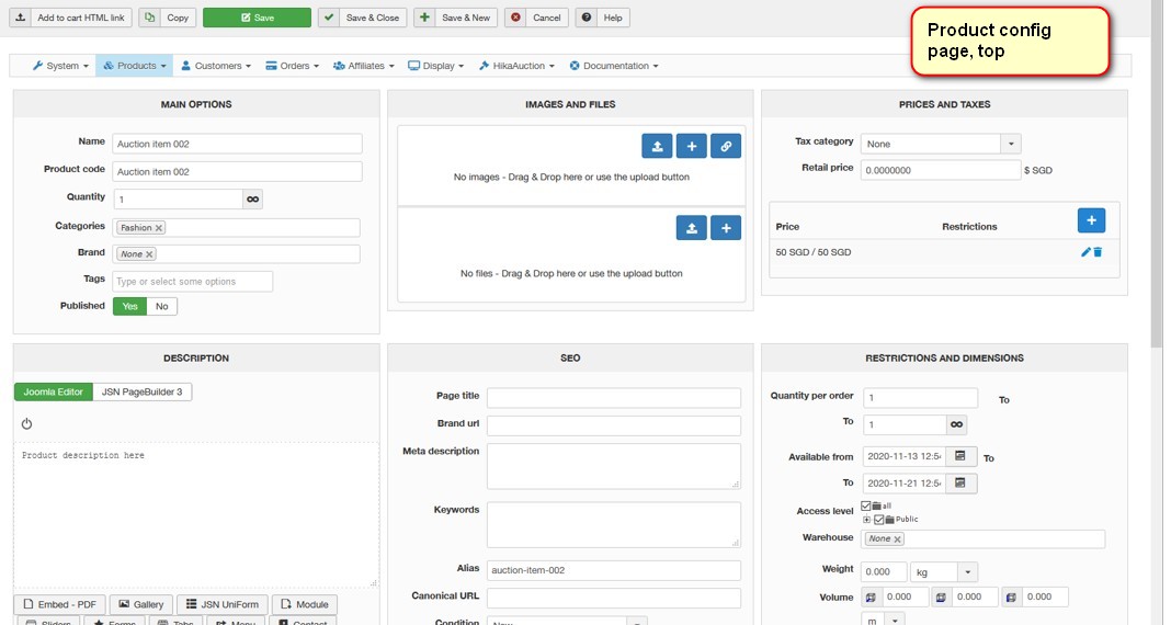

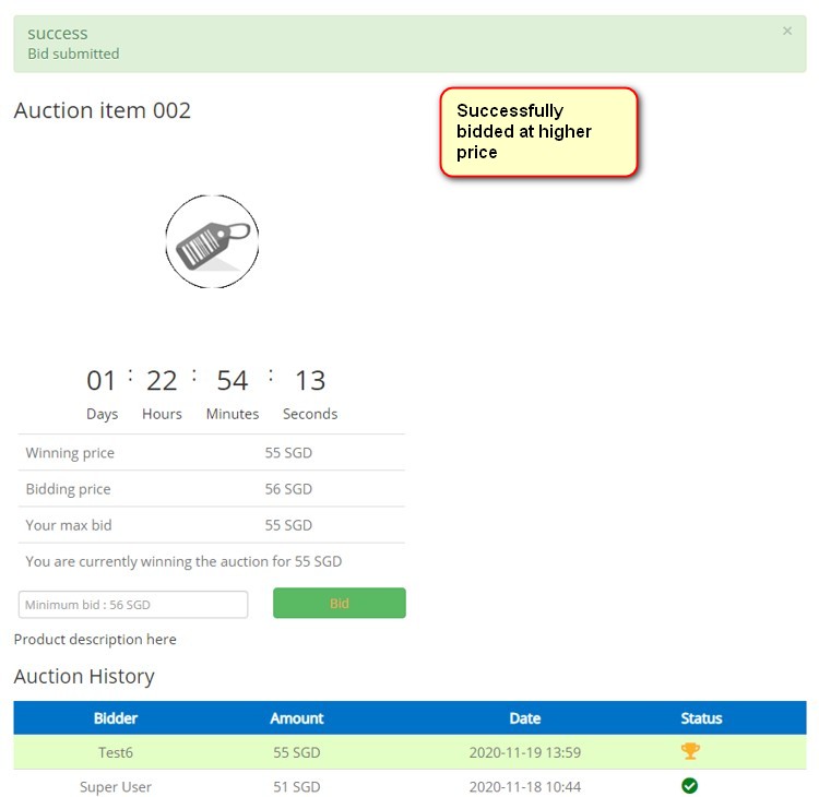

Can you show us screenshots of the issue through your auction page with the amount entered (like my previous screenshot), and also of your auction product configuration page, so that we can properly reproduce that issue ? Thank you !
Kind regards,
Mohamed.
  • Posts: 30

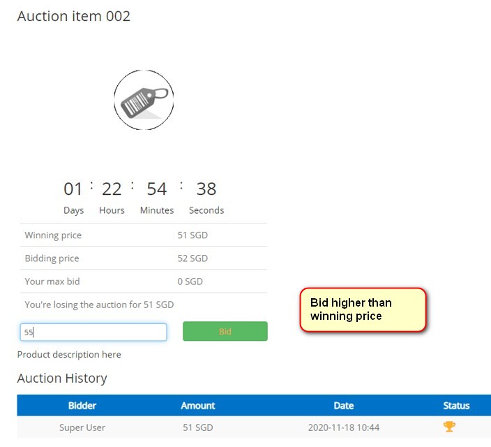

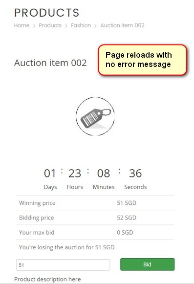

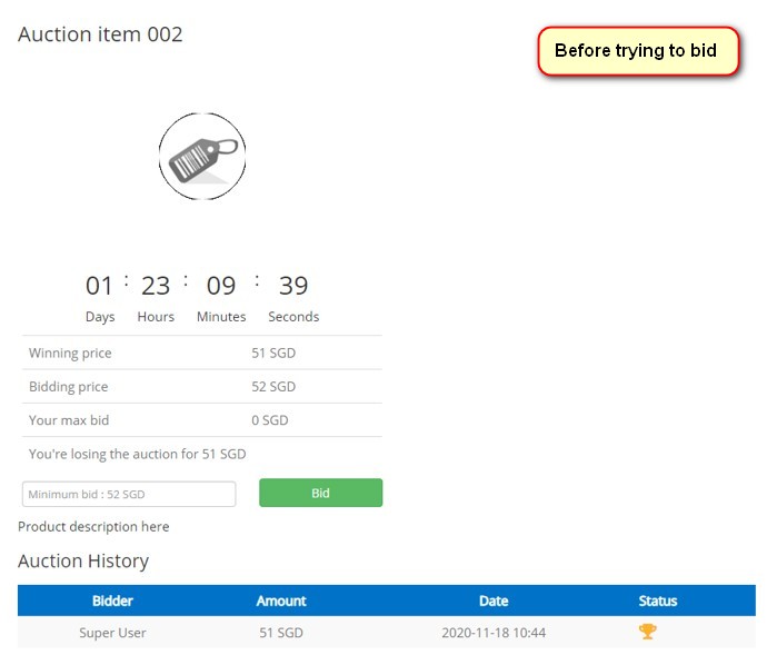

5 years 7 months ago #326088
Ok have uploaded 7 images.
Let me know if you need anything else to help. Thank you!
