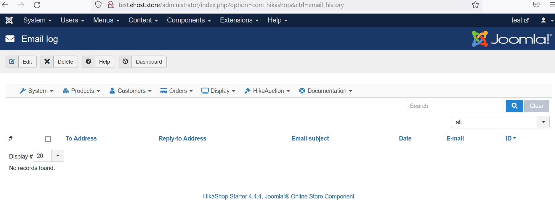

If you're still not receiving emails, can you check the menu "Hikashop-> Customers-> Emails history" to tell us if emails are sent ?
If yes, then HikaShop/HikaAuction sent them to the email server but the email server was not able to send them to the recipient email server.
So you'll have to check the logs of the email server to understand why this is happening.
You'll probably have to contact your hosting support with a screenshot of the details of one email from the history that wasn't delivered so that they can tell you what's wrong.

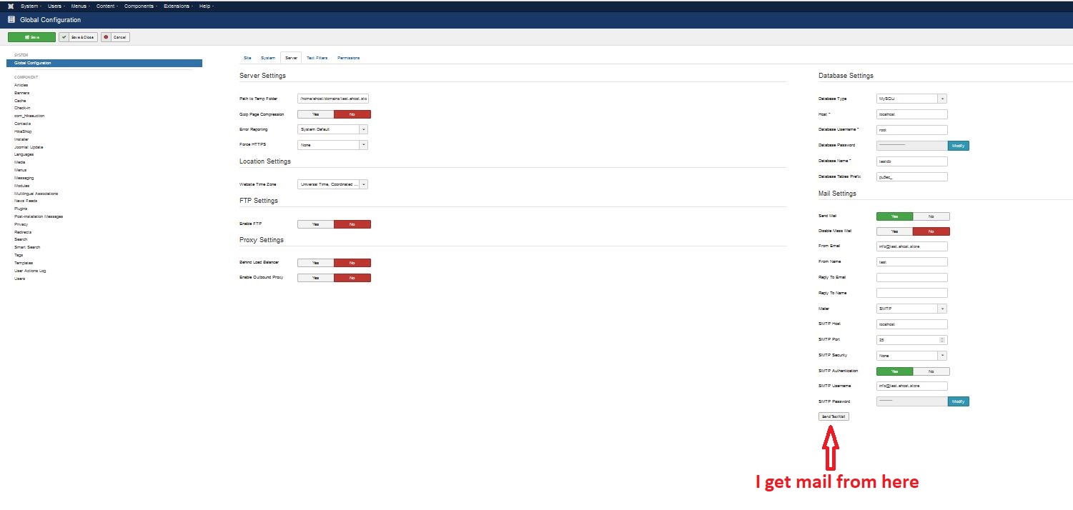

I'm using a Linux server and I did the settings exactly as you said Cron ist install, hikashop -> Email notification ist on, Customers -> Email-history ist empty, SMTP is adjusted and sends test email! , but the system does not send any emails.
You can see some screenshots in the attachment.

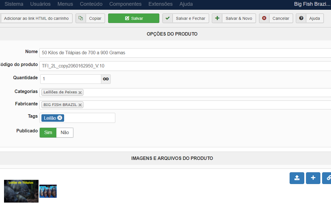

3. Using this page: bigfishbrazil.com.br/shop/index.php?opti...ron&task=executeCron I receive that error message:
3.1 1146 Table 'jpvicsuj_joom217.#__hikamarket_vendor' doesn't exist
But the vendor is there: prnt.sc/3qU6XpWg18Oc

  • Posts: 4
4 years 5 months ago #339854
eneasneto wrote: Hi! Greetings again, answering that:
I use Rochen Servers, the best for joomla
1. Joomla! version 3.10.6 is the current version. Your website is up-to-date.
2. I added the Cron job too at server
The Interesting Part:
But that is present: prnt.sc/3qU6XpWg18Oc to see the image on a browser...
What shoul'd I do? Please...
  • Posts: 86058
  • Thank you received: 14183
4 years 5 months ago #339855
This indicates that some of your products with the auction mode activated have a vendor id linked to them even though you don't have HikaMarket Multivendor installed on your website.
This shouldn't happen normally.
What you can do is to go in the menu System>Mass actions of HikaShop and create a new mass action. There, select the data type "product" and add an action "update the values" with the "product_vendor_id" column selected, the mode "int" and the value 0
Finally, press on the "process" button and it will remove any potential link to vendors in your products.
That should prevent that error message when the cron is being run and thus it should allow the emails to flow.
