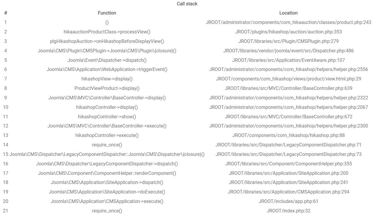

-- Error-message(debug-mod must be tuned on) -- : Call to a member function getUsersWithMaxBid() on null
I just migrated my website to Joomla 4 and have set PHP to 8.1.
In the backend all goes well but on the frontend when I call one of the finished auctions I get an error.
Hope this can be solved. Should you require login details please let me know.

  • Posts: 10
3 years 7 months ago #349071
Hello Philip,
Hereby the screenshot of the errors.
Kind regards,
Marloes

3 years 7 months ago #349073
Thanks. That's a strange error.
I'm not able to reproduce it on PHP 8.1 and Joomla 4.
Also, I checked the code and as far as I can see, the only way to get that error is if the file administrator/components/com_hikaauction/classes/auction.php would be missing or empty or something like that.
Could you check on that ?
Could it be that the file was not transferred properly at some point while you migrated your website ?

  • Posts: 86105
  • Thank you received: 14206
3 years 7 months ago #349091
The issue comes from an override.
You have the file /templates/yootheme/html/com_hikaauction/administrator/classes/auction.override.php
This file tries to load the file administrator/templates/isis/html/com_hikaauction/administrator/classes/auction.override.php which doesn't exists on Joomla 4 since the backend template changed.
So it's a customization problem, not a problem in HikaAuction.
Delete the file /templates/yootheme/html/com_hikaauction/administrator/classes/auction.override.php and it will work normally. Now, this means that you had a class override so it also means that you'll lose the customization. You would have to get the file administrator/templates/isis/html/com_hikaauction/administrator/classes/auction.override.php from your old website on Joomla 3, to see what it had... Maybe you need to redo the override.
