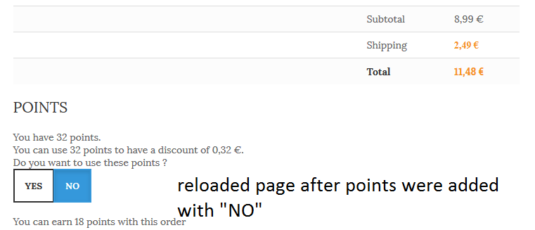

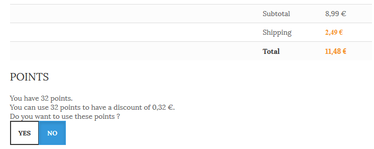

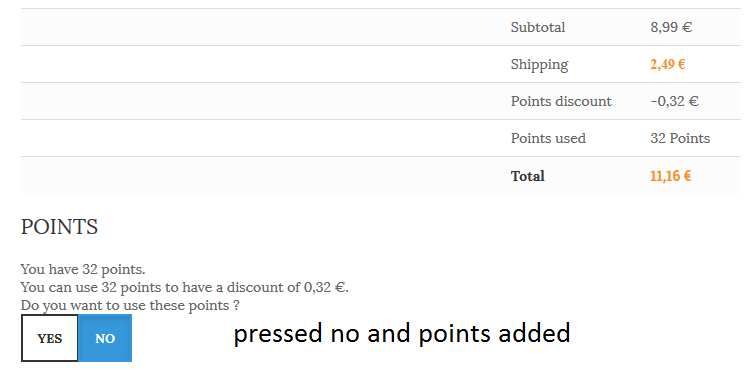

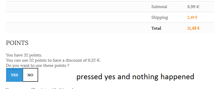

1. Will it be any updates to this plugin so it will use new checkout? I still see some issue with user points buttons.
This is what happening.
a. I come to checkout page which has user points. By default button is set to "NO" and all looks good.
b. To use points i press "YES" and points are used.
c. I press "NO" points are still used.
d. I press "YES" points are removed. ( if i refresh page here points are added again here ).
e. I press "NO" points are used.
This is happening with default protostar template.

1. 4. Could you provide some screenshots of the issue and of how you've configured your checkout and advanced settings and the user points plugins settings so that we have a clearer look at what you have on your end ?

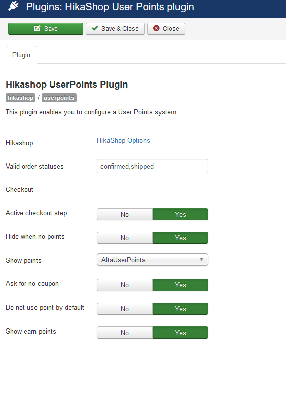

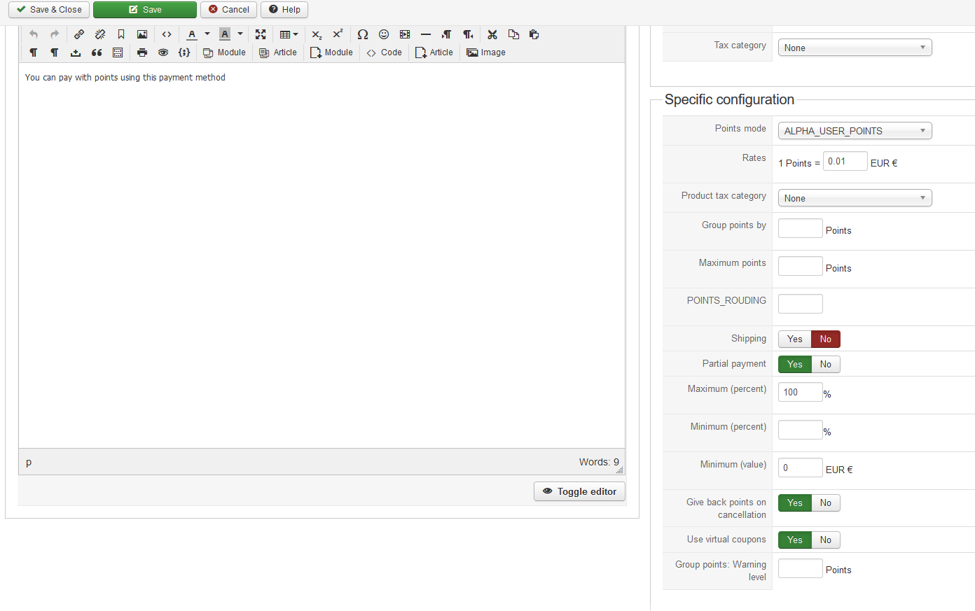

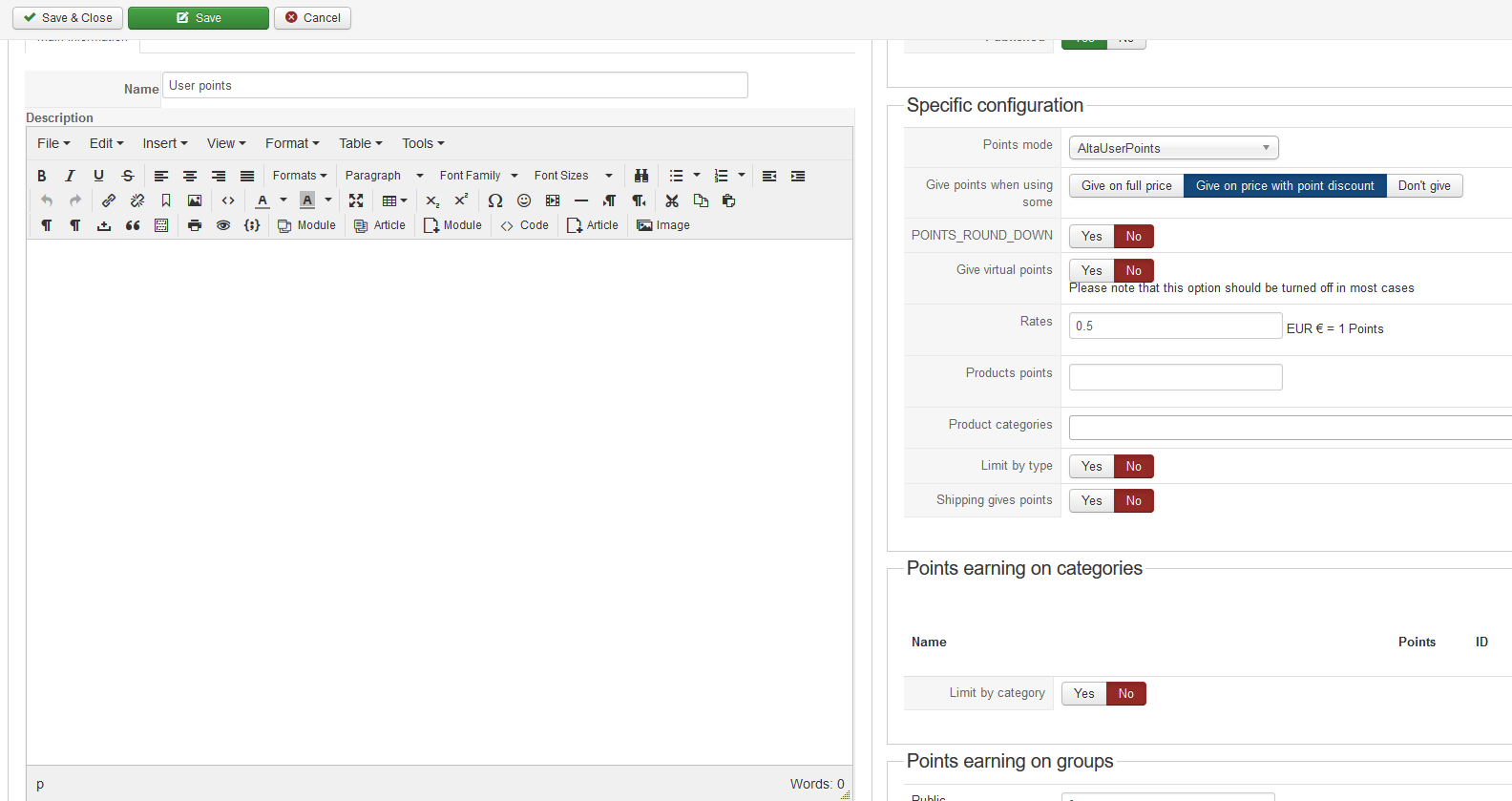

1. I have tried to be more clear as possible with my images. This for user points on checkout issue

9 years 8 months ago #257702
Couldnt add all images in one replay....
So here are they.

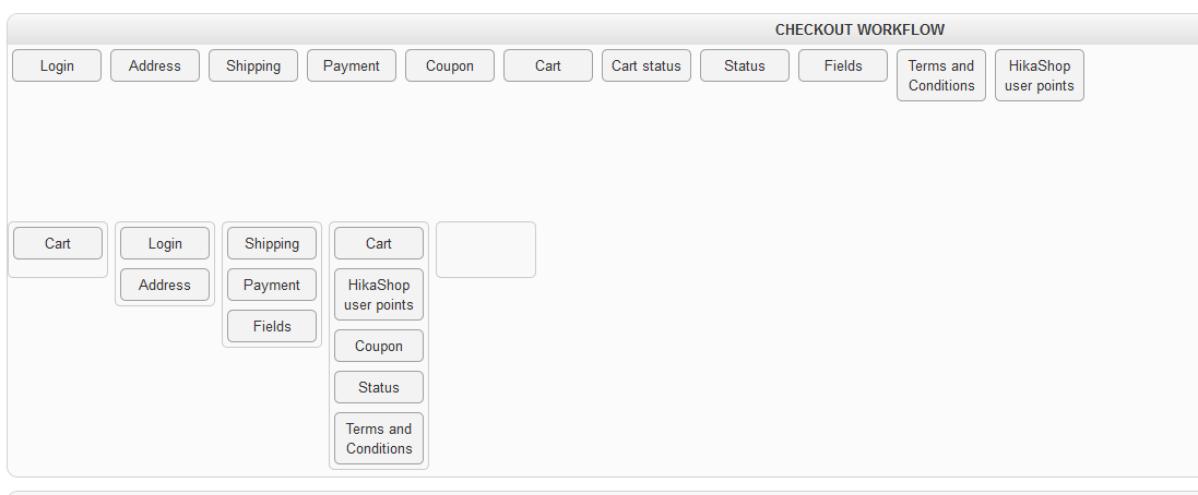

5. My checkout workflow is set up like this: Cart-> login, address-> shipping, payment, fields->cart,userpoints,status,terms->end
I am not logged in. I add product to cart, go to checkout and I am in cart view, press next I see login form, I LOG IN here, I see address form, trying to press edit icon it gives me invalid token (address form hidden, only next button shows), I press next and I see blank page with "invalid token" on the top left corner, pressing browser button back and all works fine. I can edit address. I have tried many times and always same result...
I can give back end access of test site if it would help to resolve it faster for you Jerome.
Kind Regards

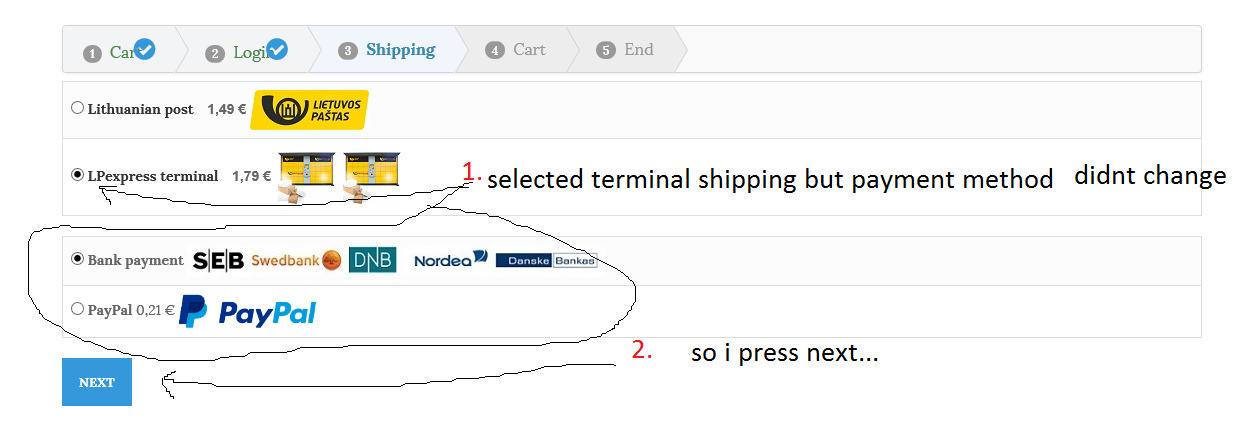

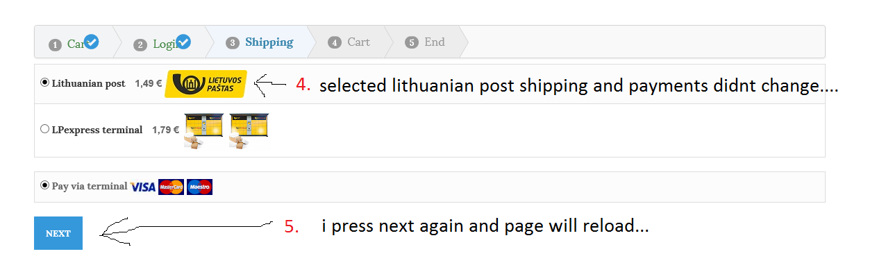

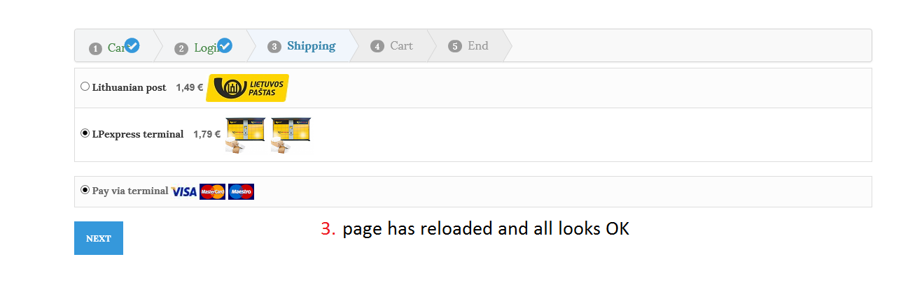

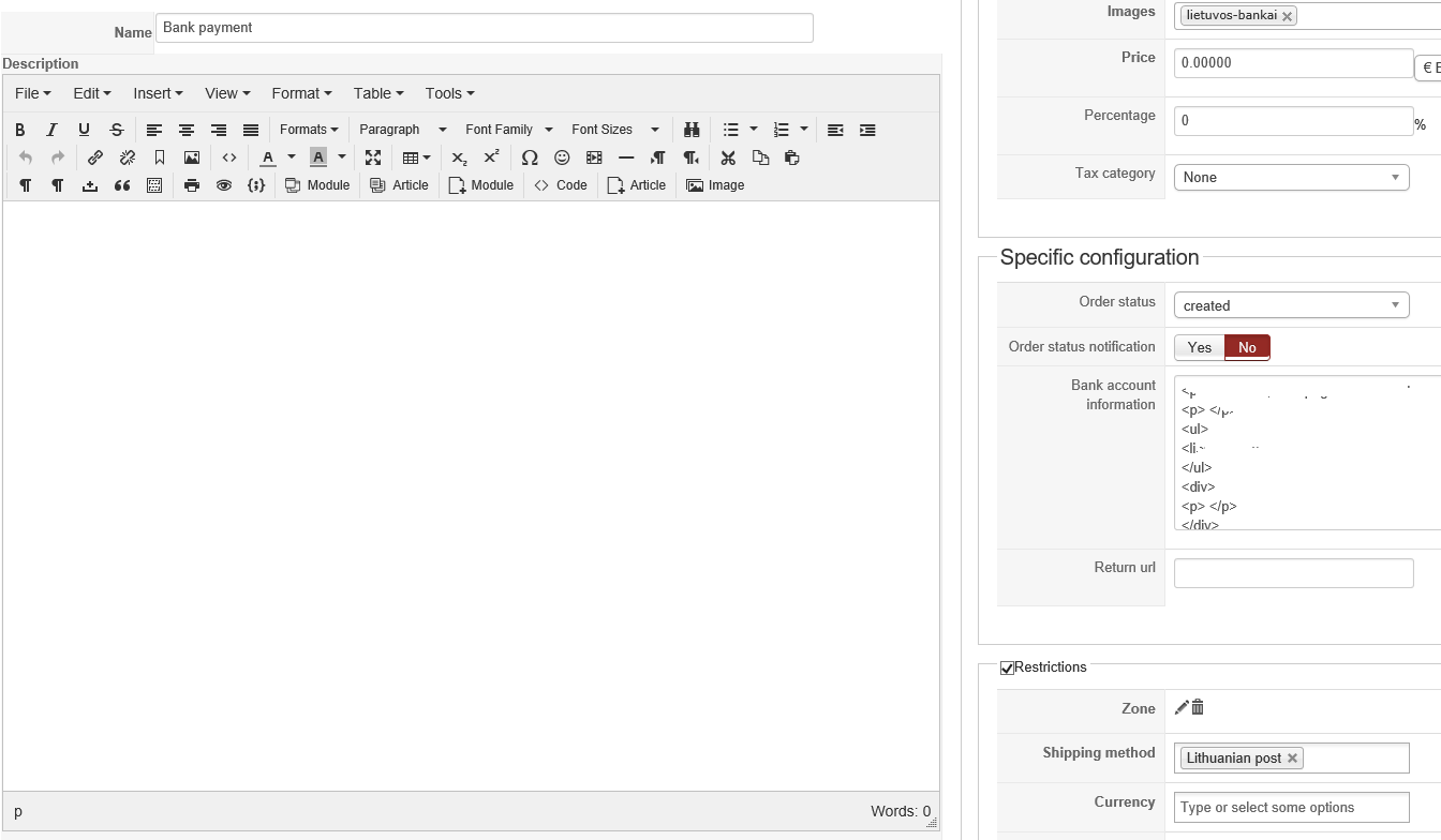

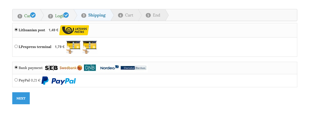

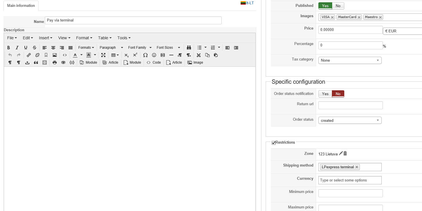

2. So I have 2 shipping methods and 3 payment methods.
Shipping methods: 1.Lithuanian post, 2.LPexpress terminal
Payment methods: 1. Bank, 2. Paypal, 3. Pay via terminal
Bank and paypal payment are restricted to Lithuanian post shipping method
Pay via terminal payment method is restricted to LPexpress terminal shipping method
Screenshots attached....
Please take a look at screenshot named "shipping" you will see what is the issue...
3. Ok, I see. Will check it later after finished version.
5. Great!
Kind Regards
9 years 8 months ago #257813
I have just update the beta package with some fixes and improvements.
It contains elements to fix your issues : 2 & 5.
For the issue 1 ; I still have to take a look at it, it's in my list :)

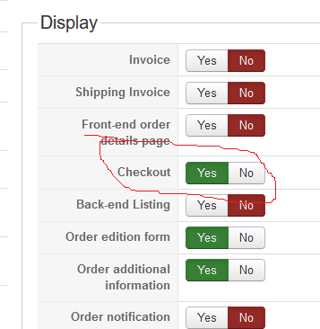

For point 3 i am confused. Should i set it to display in front-end to YES? If i set it to yes it shows in checkout but problem is that i would like to show some fields based on shipping method selected.

9 years 7 months ago #259463
Yes, that option must be turned on.

1. So it looks like the settings are a little bit different with hikashop 3. Why you have removed checkout display option in custom field?
I have set option display in front-end to YES and it is working fine with old checkout but it seems i can't get it work with new one.
After witch line i should add that code? As for now i have tried after lines: 10,11,12,13 and couldn't get it to work as it should.

9 years 7 months ago #259512
1. I've removed it as we now use the "frontend" setting instead.
