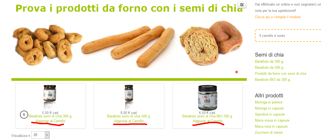

  • Posts: 281
9 years 8 months ago #258067
Hello jerome Yes i know that is beta versione infact i am using that just in a copy of the web site ;)
However i solved the problem about buttons changing the setting in configuration>display Style of web site from NO to default
Now i see the buttons, but after that now the product in the list are displayed in one column and not 3 as before.
You can see here :
bachecaviaggi.altervista.org/
What do you think about that?

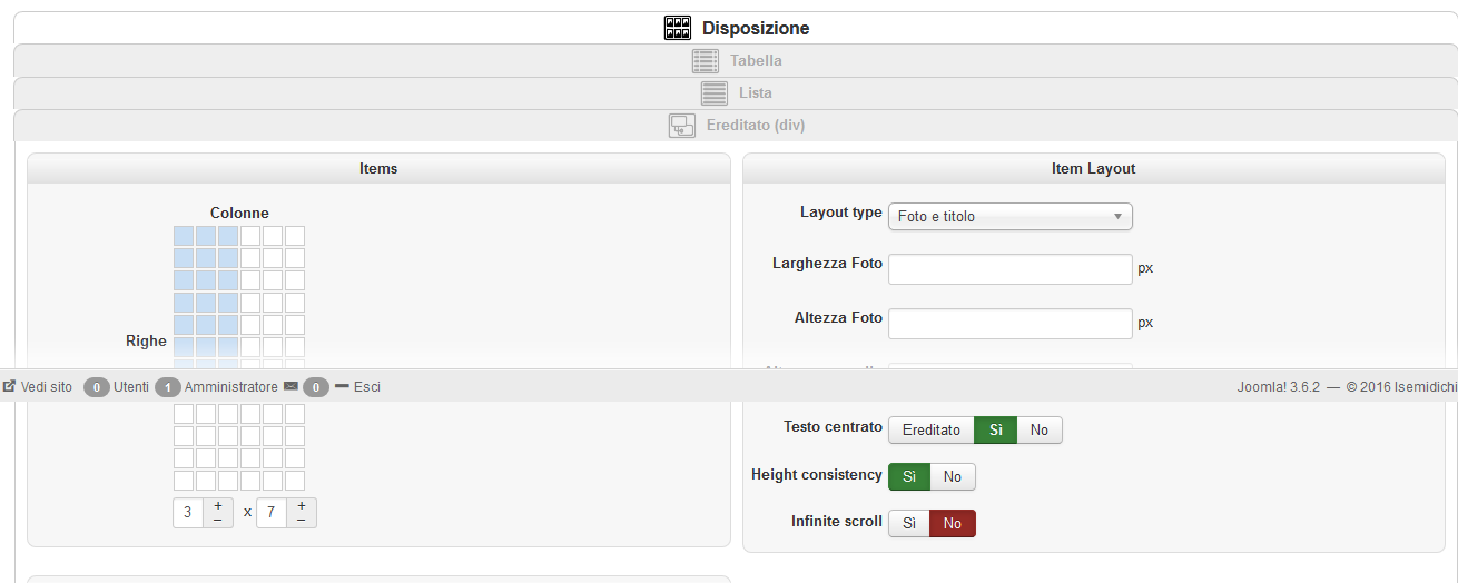

  • Posts: 281
9 years 8 months ago #258107
Hello
Yes it is already setted in that way you can see in the screen shot.
But it is strange couse if I change again the style of website from default to NO, the products are displayed in the correct way on 3 column.

  • Posts: 281
9 years 8 months ago #258425
Hello
Following the first point of jerome now the buttons "add to cart" are dis displayed.
The only one that is still not visible is "go to checkout" in the cart module:
You can check same url here:
If I chose No in "Checkout legacy" when i try to delete or increase the number of product in the checkout I receive an error page:
You asked for bachecaviaggi.altervista.org/pagamento/c...85a26767-1/tmpl-ajax
Thank
Frank
