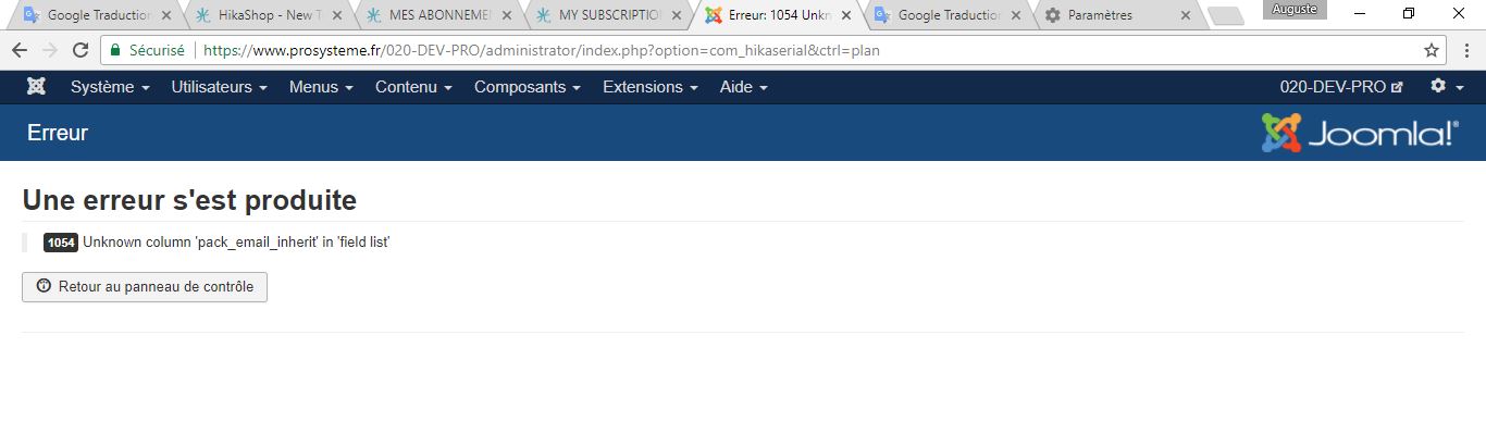

-- HikaShop version -- : You have the latest stable version of HikaShop Business: 3.1.1
-- HikaSerial version -- : You have the latest stable version of HikaSubscription: 2.0.0
-- Joomla version -- : Joomla! 3.7.3 Stable [ Amani ] 4-July-2017 08:03 GMT
-- PHP version -- : 7.0.7
-- Browser(s) name and version -- : Version 59.0.3071.115 (Build officiel) (64 bits)

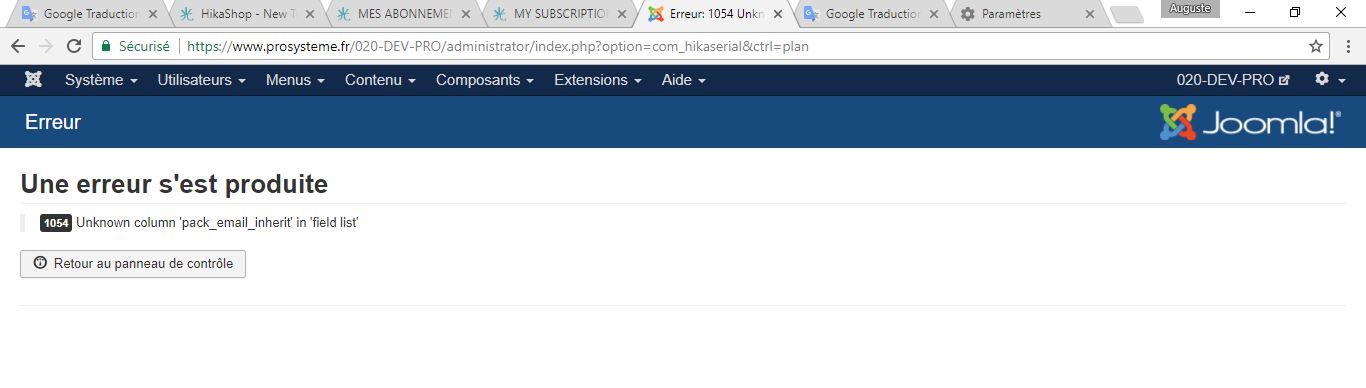

-- Error-message(debug-mod must be tuned on) -- : 1054 Unknown column 'pack_email_inherit' in 'field list'
Hello
I have been waiting a long time for this hikaserial subscription after successfully using akeeba subscription, emerald.
First quarter of an hour of discovery:
1) Installation OK
2) Dark blue menu bar with invisible controls
3) Unable to create a new plan.
Message:
"1054 Unknown column 'pack_email_inherit' in 'field list'"
Tank You
Some research but I could not create a new plan !!!

8 years 11 months ago #274036
Can you please perform a "check database" via your HikaShop configuration screen ?
I will fix the SQL query for the table creation during the installation ; but the SQL file should be good and the "check database" should fix it.

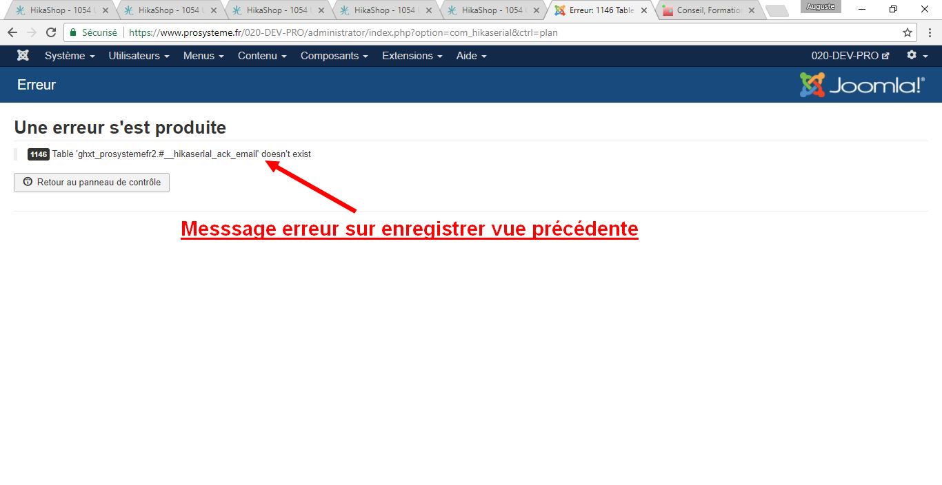

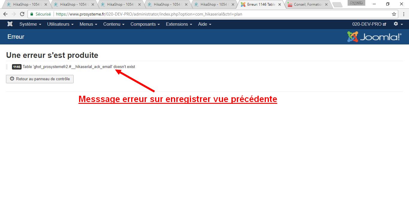

Another point now appeared:
4) In the view of the "Plan emails" tab
here is the error: 1146 Table 'ghxt_prosystemefr2. # __ hikaserial_ack_email' does not exist
Tank you
  • Posts: 26365
  • Thank you received: 4069
8 years 11 months ago #274065
You can re-download the beta package to get the fix.

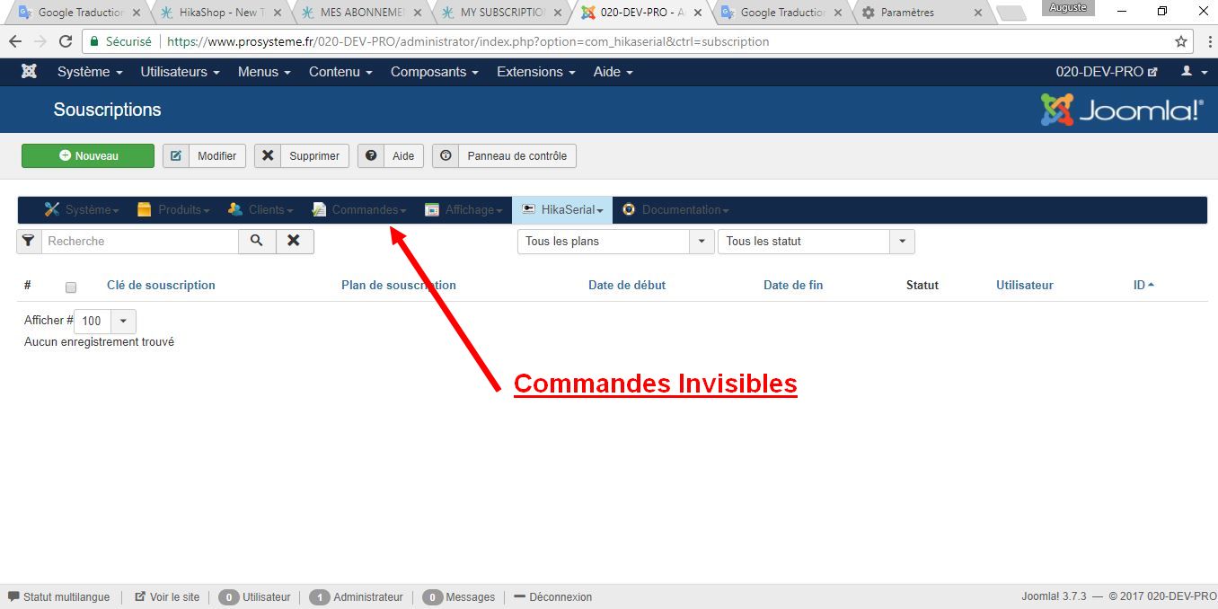

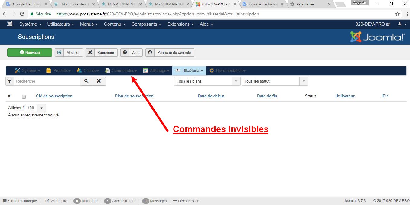

Point 2) Dark blue menu bar with invisible controls
Je ne comprend pas ta réponse :
PS : Your backend menu color is not related to HikaSerial. There is indeed some CSS to handle menus in HikaSerial but that's for the legacy menus, since a long time HikaSerial is using the HikaShop menu and so its CSS.

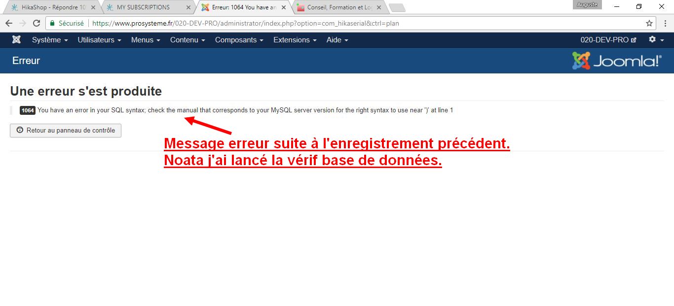

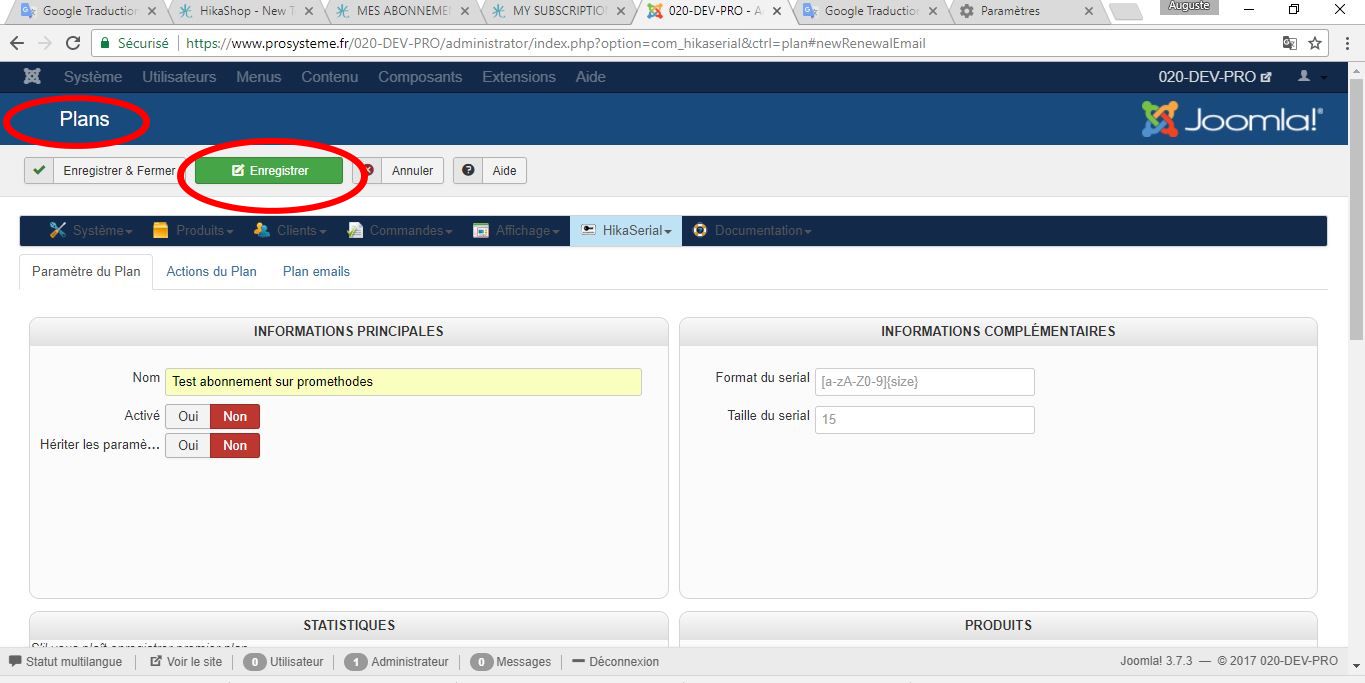

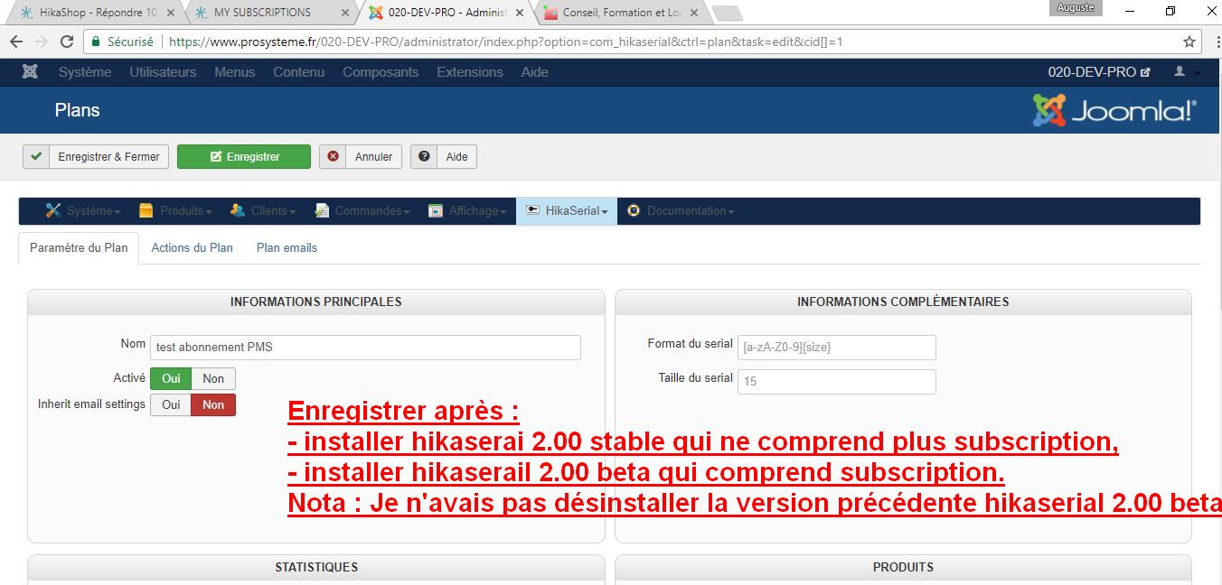

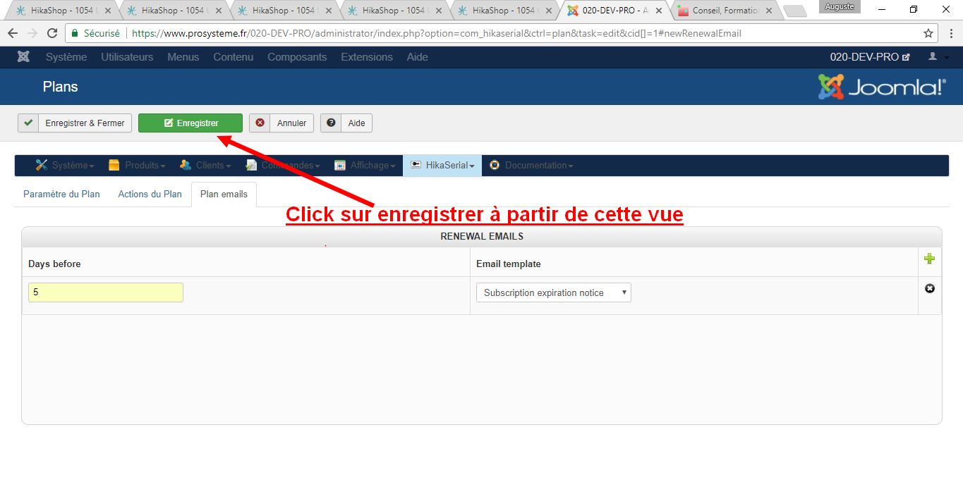

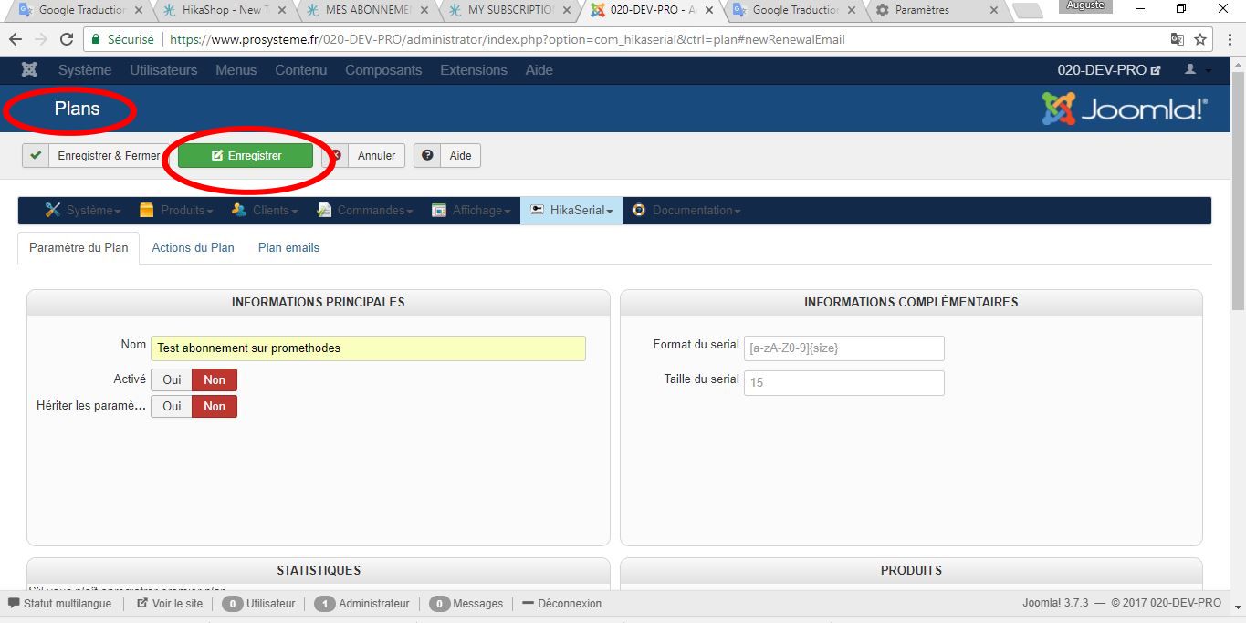

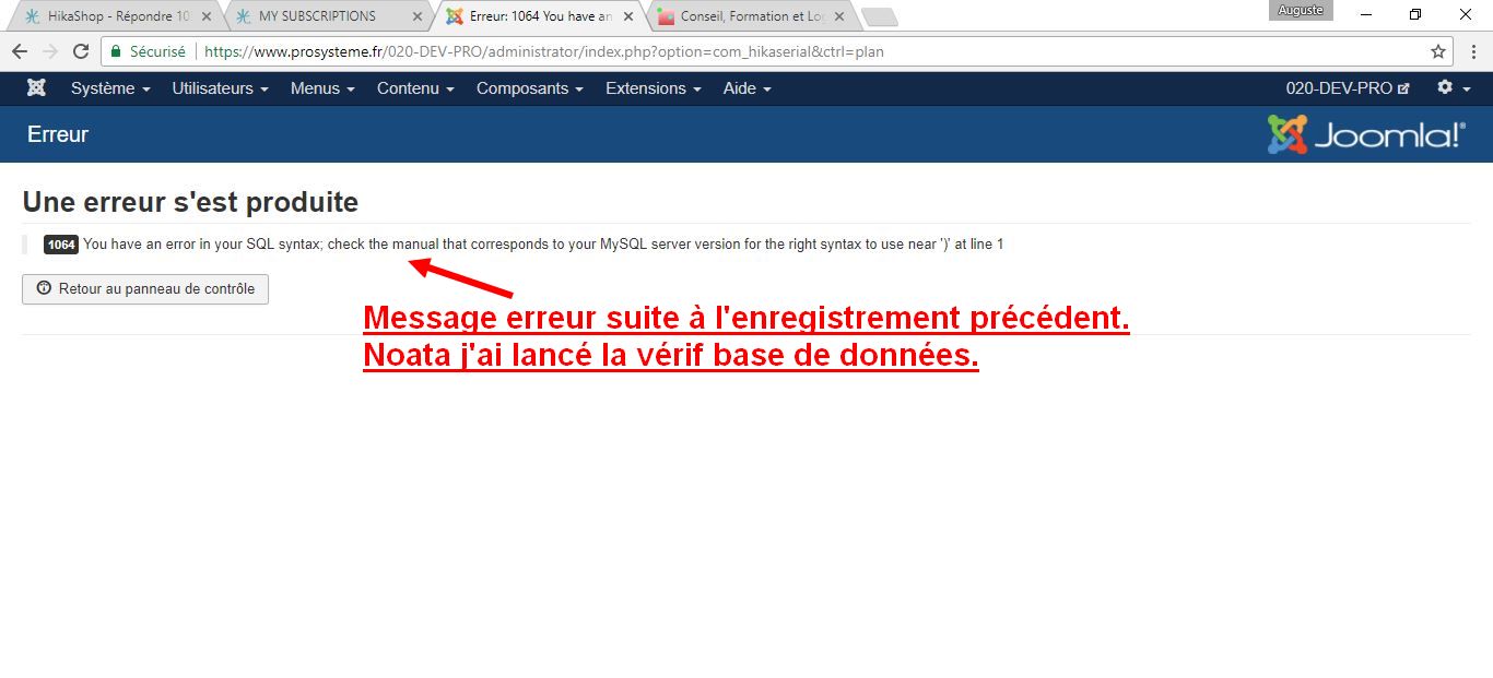

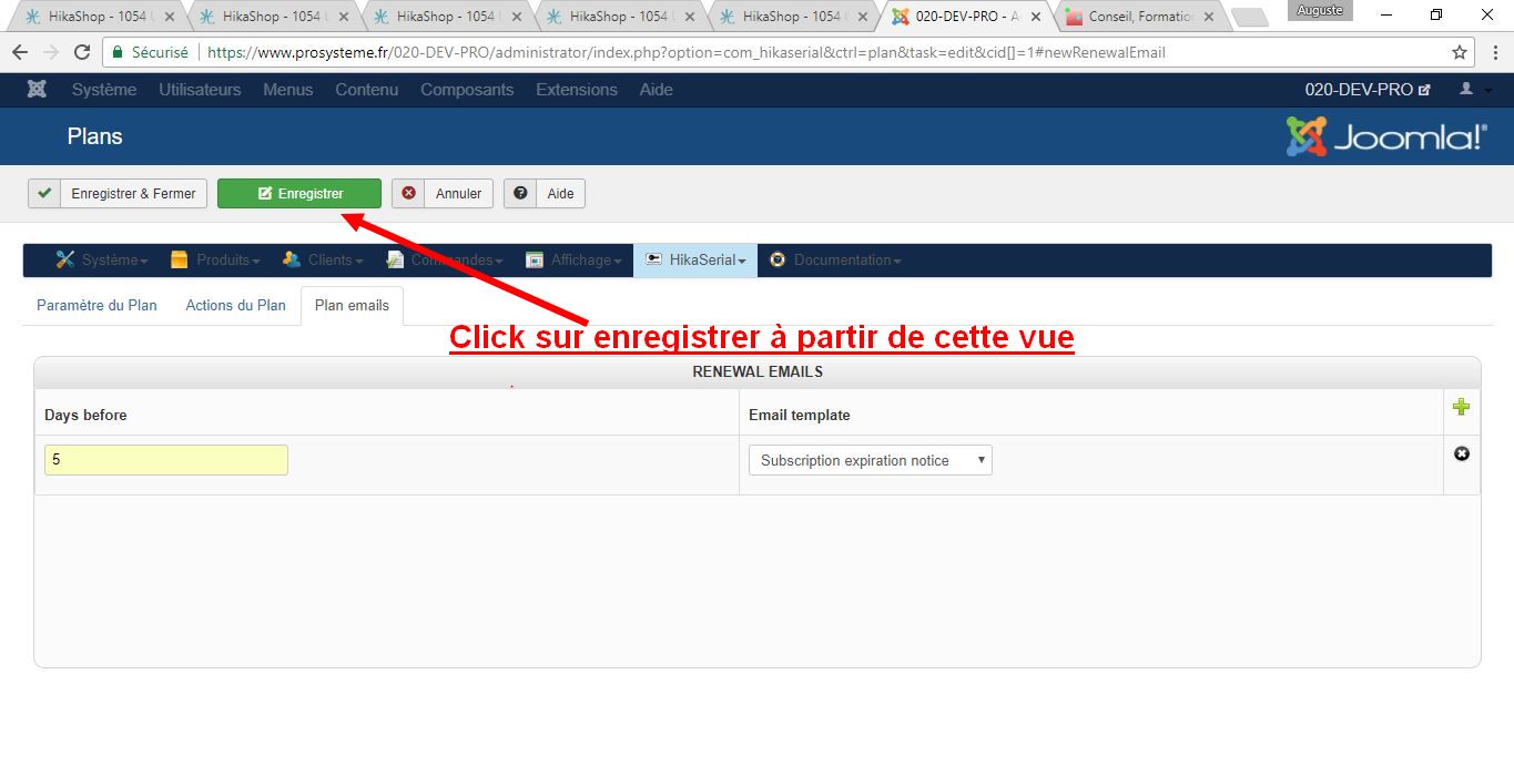

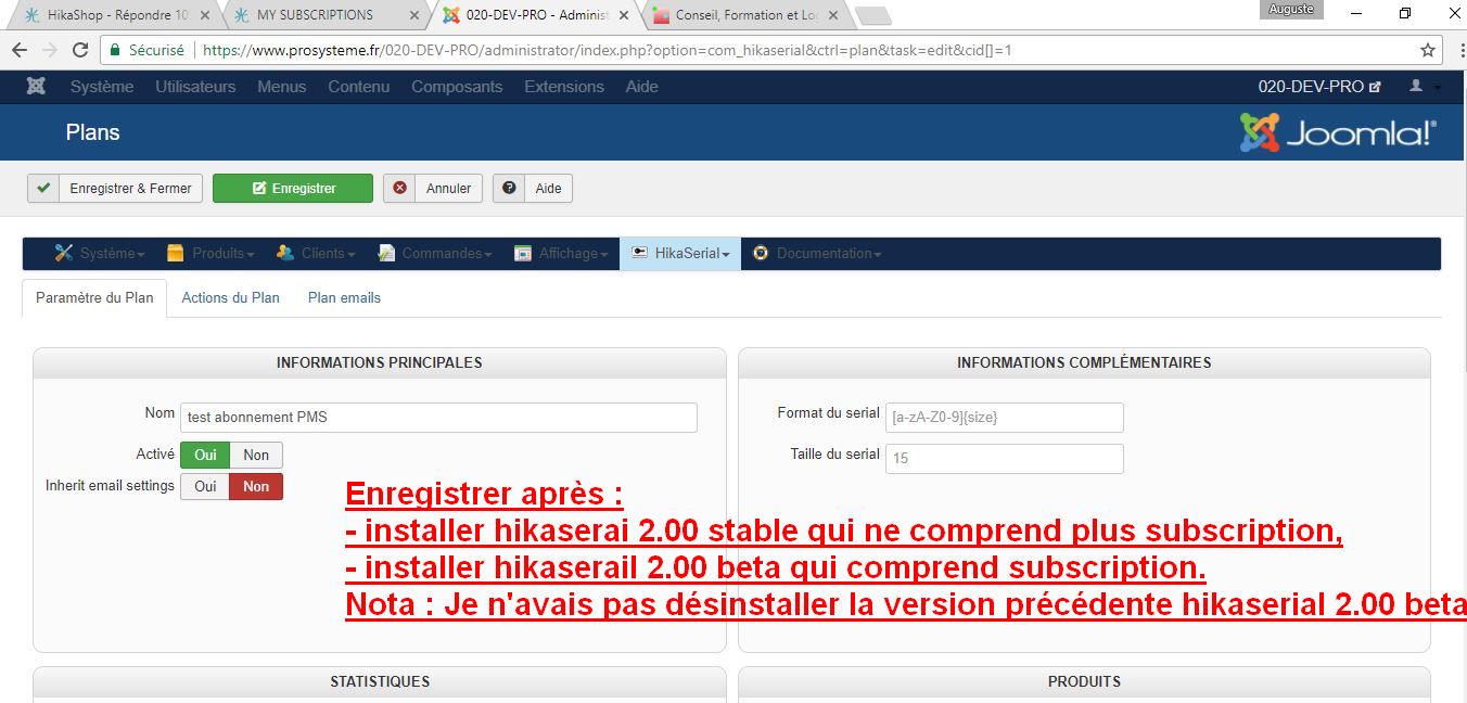

5) Erreur sur enregistrer suite à modification du plan :
Je modifie le plan et je click sur enregistrer :
Voici l'erreur:
Heureux de vous aider et bonne journée
Nota: Je suis très intéressé par cette extension que j'attend depuis longtemps pour simplifier les abonnements suite à l'acquisition des produits à télécharger sur hikashop.
  • Posts: 26365
8 years 11 months ago #274095
This thread has been started in English ; please stay in English.
Otherwise you can create a new one with a French title ; but it won't be easy for other users if you change the language in the middle.
Thank you for your understanding.
About the SQL error ; I hope that Joomla will fix soon the error display and re-introduce the SQL query detail (or at least an option to do it otherwise debug is impossible).
I was able to reproduce your issue by installing HikaSubcription beta on an HikaSerial 2.0.0.
So I made a patch and updated the package.
For your backend menu ; it's not related to HikaSerial. That's all.
  • Posts: 276
  • Thank you received: 17
8 years 11 months ago #274160
Ok resolved => 5) Error on recording due to plan modification:
I just tested all the basic commands:
New plan, Edit and Delete and everything looks OK
Remainder Error Item 2) Dark blue menu bar with invisible controls
I do not know what to do ???
Have a good day
Last edit: 8 years 11 months ago by Teophile.
  • Posts: 26365
8 years 11 months ago #274181
2 - You can check your CSS rules
www.hikashop.com/support/documentation/1...the-display.html#css
