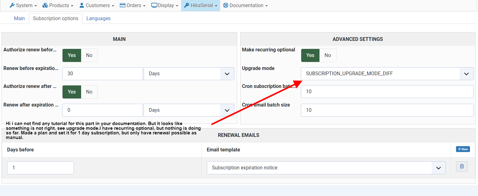

I have the hikasubscription made a plan and product for it. Put the product on create and renewal after 1 day. Als rewrote mollie plugin for recurring payments, but nothing happens and i only can renew manualy via customer subscription page. Also i missing tutorial for one part in your documentation.
Can you help me how to set the renewal correctly on recurring?

Thanks for the directions to make the mollie plugin recurring, but in the subscription options i see: SUBSCRIPTION_UPGRADE-MODE-DIFF and SUBSCRIPTION_UPGRADE-MODE_EXTEND what does it mean? i think it is a language string failure.
Mark
1 year 11 months ago #363699
Yes, the translations are missing ; I will check these.
The "mode diff" is a "differential mode", where the the end date become the maximum between the current expiration date and the "current date + upgrade duration".
The "mode extend" is the "extension mode", where the end date is being increment by the "upgrade duration".
An example.
You have an upgrade with a duration of "1 year".
If a customer A buy the upgrade and its subscription ends in one month.
- In diff mode : the new expiration date will be in one year.
- In extend mode : the new expiration date will be in one year and one month.
