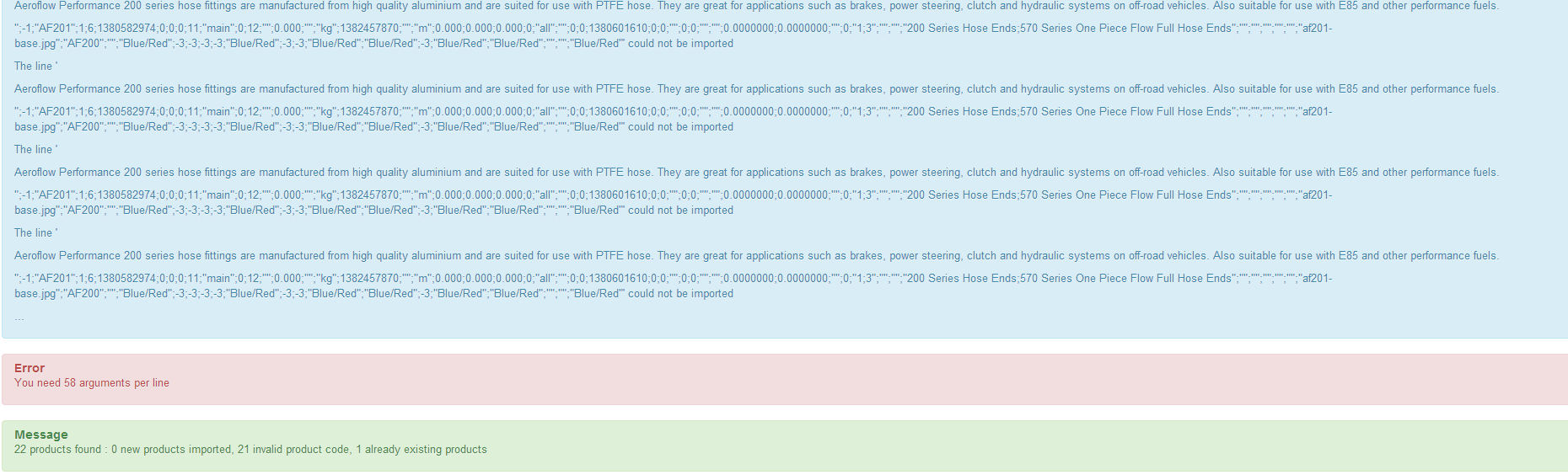

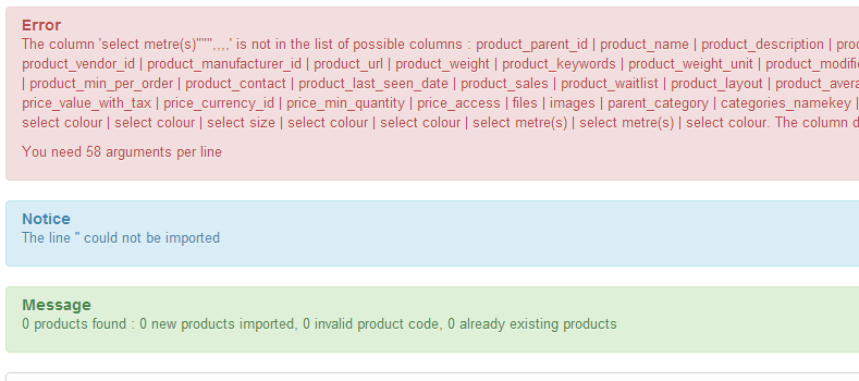

You need 58 arguments per line
Notice
The line '' could not be imported (see hikashop_import.png) for error.
If you do an export of the products in one category (hikashopexport.csv), delete the unwanted lines (category info) and just import the the original lines (hikashopexport (5).csv). You get the error.
The product has multi price options (3) and I am wanting to do an import rather than a manual update to products x 40 variants x 3 prices.
I did a simple export and import of the the same file as a test, even the hikashop simple export doesnt create the file correctly, so what hope do I have to fix that prior to an import ???

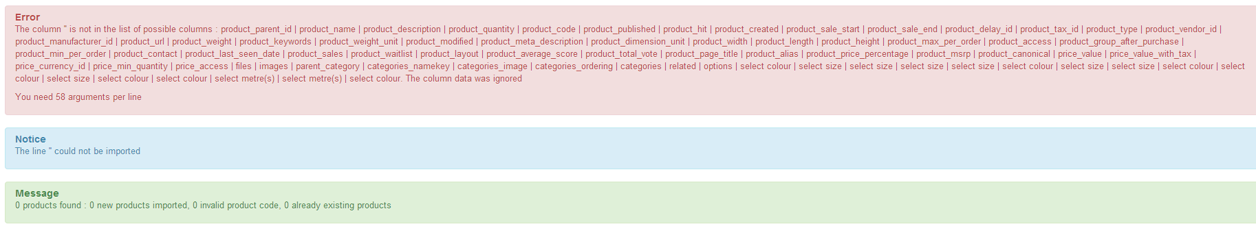

Ok installed v2.2.2 Business.
Exported
Removed all lines except the price different test product variant.
Did Import, same error.
Mark

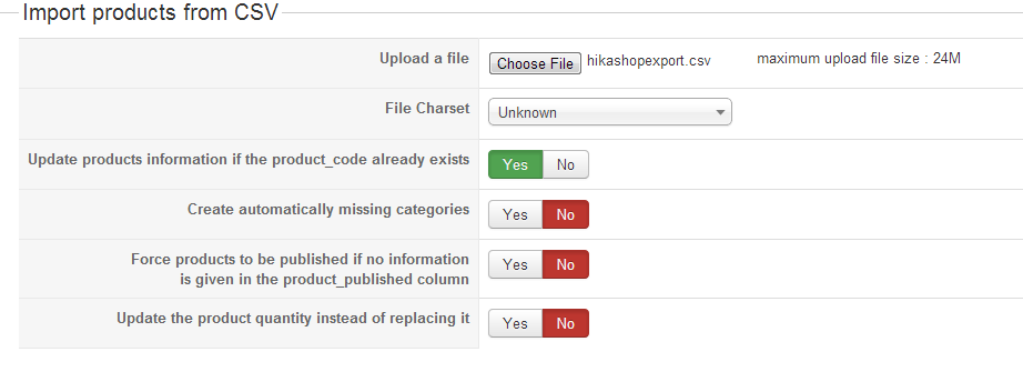

Ok, I have done nothing with csv file.
I simply went into the products section, selected my product, did an export and created this file.

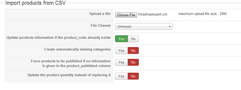

I then went to product import and selected the file (untouched) with these options
It then fails.
This is what I am saying the export / import does'nt even work..

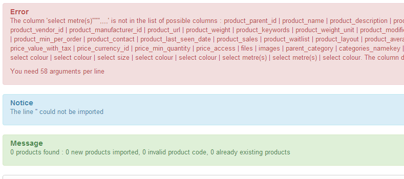

12 years 10 months ago #129363
Hmmmm
It seems that the 12 latest columns are duplicated columns of the 3 columns before.
Thanks to delete these latest columns thanks to excel for example.

12 years 10 months ago #129497
Sorry. Yes it's adding more columns than expected.
Example:
product_code,product_name,product_width,product_height (4 columns)
1,name,200,400,400,200 (6 columns)
Here there is two columns that must be removed, because the data is corresponding to nothing.
In your csv file the last twelve columns need to be removed.
