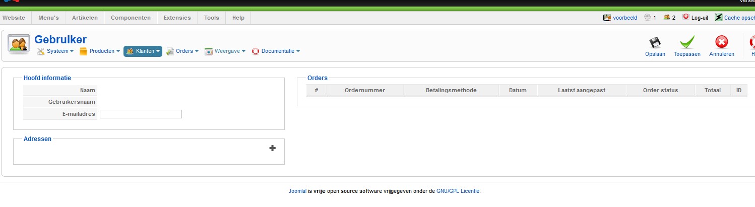

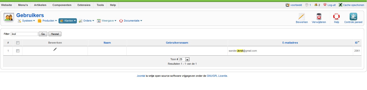

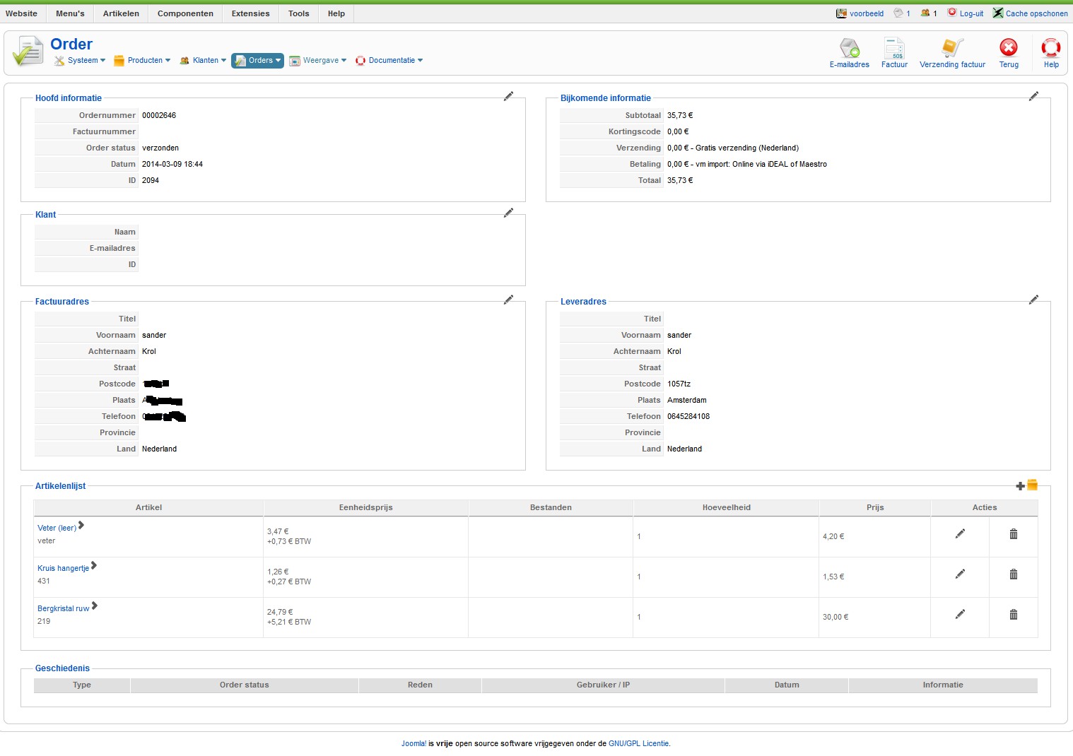

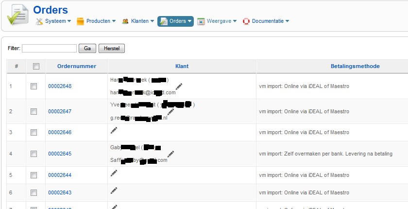

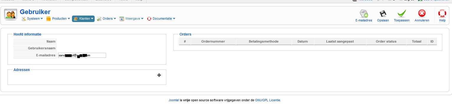

12 years 5 months ago #148469
Attached are some screen shots about the way non-registered customers are shown (anonymised).
* screen1 shows the order list (missing: no name of the non-registered customers)
* screen2 shows the order details of a non-registered customer (missing: mail address, id)
* screen3 shows the user details after clicking in the order list (missing: name, mail address, order)
* screen4 shows the user list, selecting only this user (missing: name)
* screen5 shows the user details after clicking in the user list (missing: name, order)
I hope this information makes clear what's going on.
regards,
Udo
