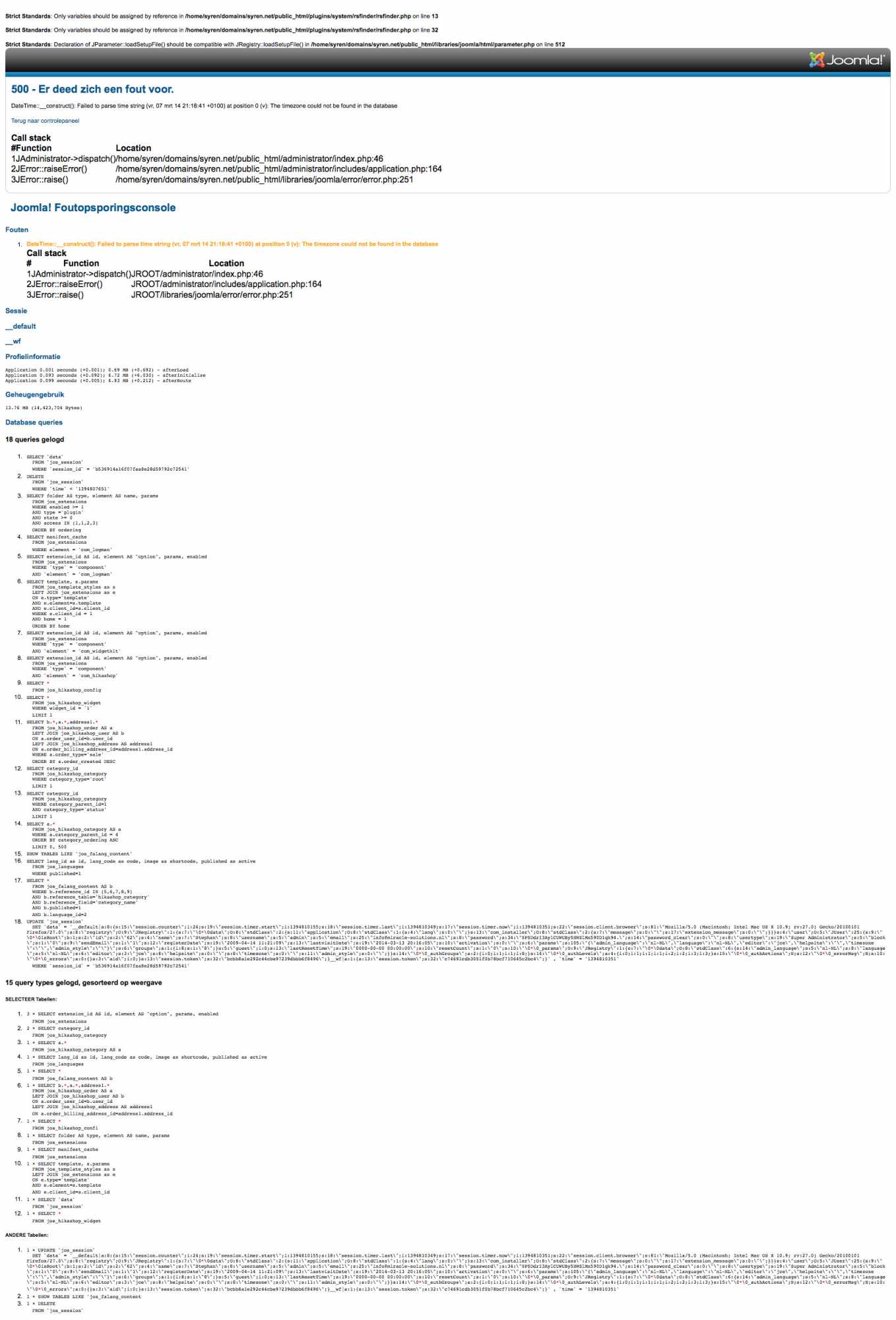

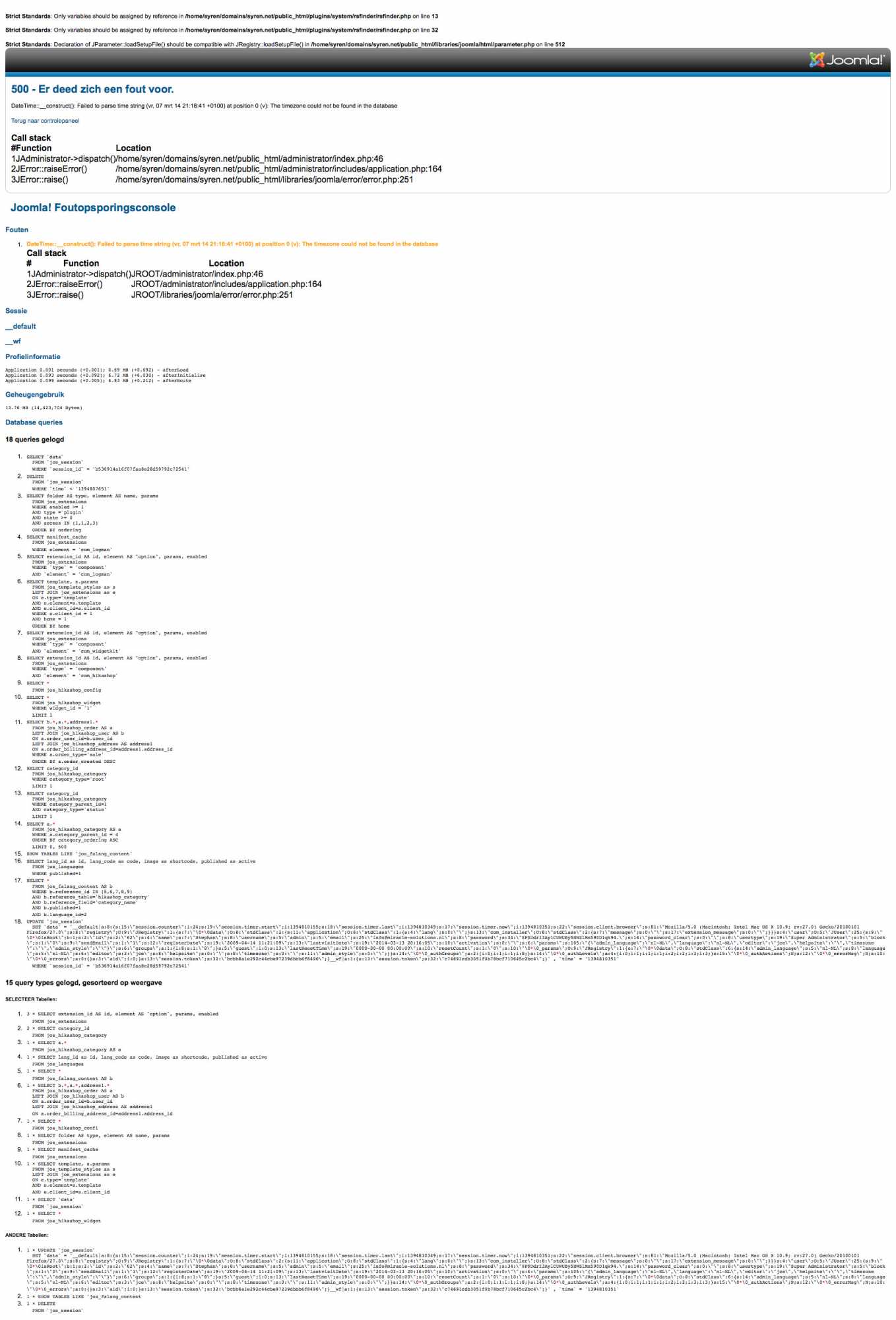

Hereby attached a screenshot of the error on the screen with all the reporting on.
I saw something about timezone. For your information: the Joomla timezone is set to Amsterdam.
12 years 5 months ago #148316
It seems like you have an error through your rsfinder system plugin, so can you un-publish it and test it again ?
