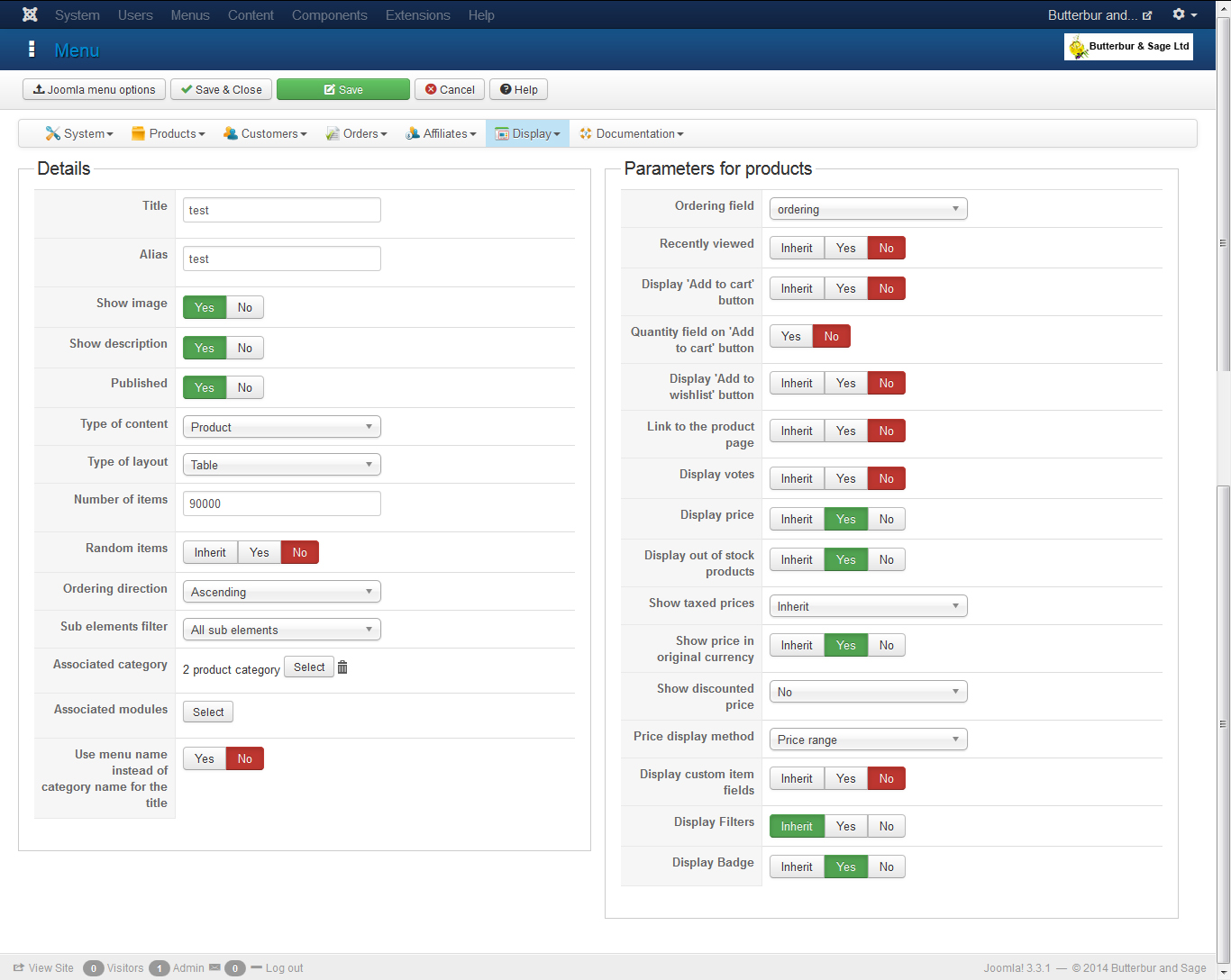

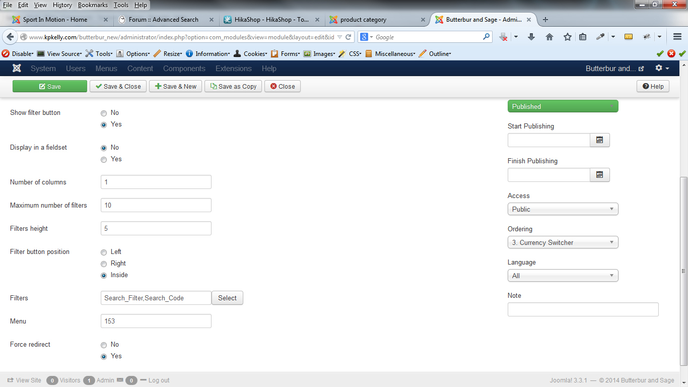

12 years 1 month ago #164848
Thanks to give us a screenshot of your search module settings, and another one for the settings of your selected product listing menu.
  • Posts: 18
12 years 1 month ago #165778
