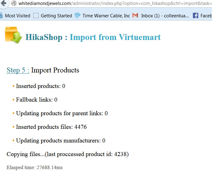

This time I got the import and let it get to step five - and left the house for several hours only to come back and it was still in the same place.
Is 5 hours not long enough? This time I screen grabbed the page before I stopped it - see attached. The categories worked again - but no products in the back end or front end - However - I just checked the tables and they are indeed in the tables? hmmm

I am aware of the Next during the import process - and as indicated in the attached image on the previous post - it was just stuck in some loop - you can tell by the amount of seconds (5 hours or more) see attached image. You will see that the images also says that 4k+ products had been imported - so it should have been completed - but the system never completed it's cycle of import.

11 years 9 months ago #178170
Please edit the file "administrator/components/com_hikashop/helper/importvm.php" and replace
		if( $max > 0) {
			echo '<p>Copying  files...(last proccessed product id: ' . $max . ')</p>';
By
		if( $max > 0 && $max > $offset) {
It should avoid the infinite loop and got in the step 6 (which will make the product prices and then the product category associations)
