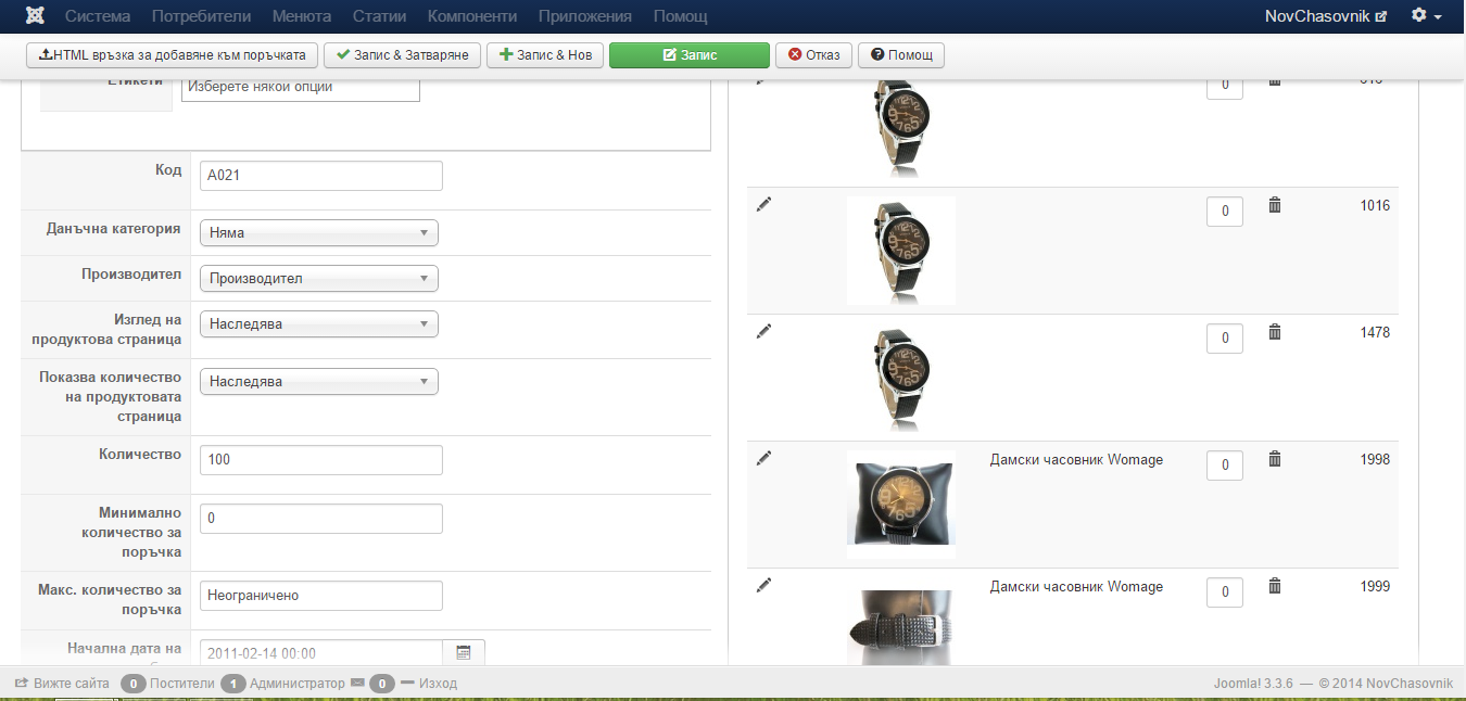

Now I have this problem. I ve migrated the products to joomla 3.0 as I sai above but now the products have more than one time first image, and when I delete one of the first product images all of them disappear. Do you have clue how can I avoid this problem? Is the same image uploader in the business version of hika as this one in the free version?

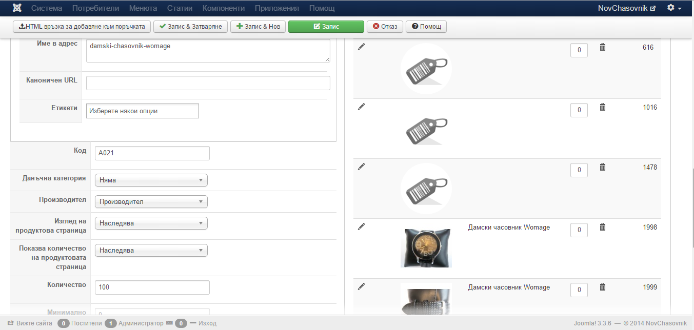

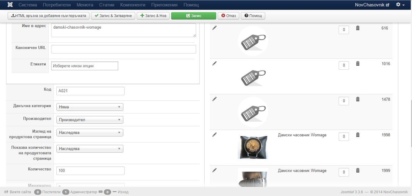

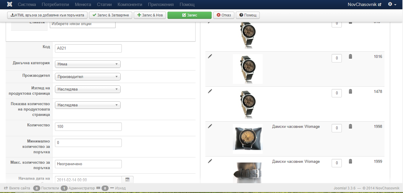

  • Posts: 22
11 years 9 months ago #181610
Here are pictures the first one is before clicking delete button and the second one is after clicked delete button of one of the first pictures and save. I ve migrated the products fom virtuelmart 1.1.19. I ve tried to add title of one of the first pictures and alt tag but the result is the same.
  • Posts: 86087
  • Thank you received: 14194
11 years 9 months ago #181667
Ok, I see what you mean.
The issue is that the images entries in the database are different but they all point to the same image on the server disk.
The system has a check to prevent deleting the same image if it is used for several products and only delete in on the disk if there are no other products using it when you delete an image entry.
However, in your case, it's other images of the same product using the same image on the disk and that isn't taken into account in the check.
Change the line:
$this->database->setQuery('SELECT file_path FROM '.hikashop_table('file').' WHERE file_path IN ('.implode(',',$oldFiles).') AND file_ref_id != '.$status);
to:
$this->database->setQuery('SELECT file_path FROM '.hikashop_table('file').' WHERE file_path IN ('.implode(',',$oldFiles).') AND (file_ref_id != '.$status.' OR file_id IN ('.implode(',',$element->$type).'))');
in the file administrator/components/com_hikashop/classes/product.php and that should avoid the problem.
