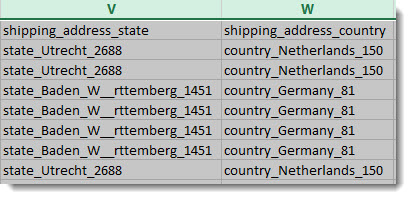

11 years 7 months ago #186924
-- Joomla version -- : 3.3.6
-- Browser(s) name and version -- : latest IE, FF and Chrome
When I look in the csv file from the mass action export is see that the states and country names are not the real names. It looks that name used in the database is shown. See image.
Is this normal?
Kind regards,
Wilfried
Last edit: 11 years 7 months ago by wilfried. Reason: SOLVED
11 years 7 months ago #186977
These are the values stored in the #__hikashop_address table, so the mass action is get this value directly from Database.
You can potentially use a regex in order to keep only the middle part (the english name).
For that you can edit the file "plugins/hikashop/massaction_order/massaction_order.php" and in the function "onProcessOrderMassActionexportCsv" add:
		foreach($params->elements as $i => $element){
			foreach($element->address as $j => $row){
				if(isset($row->address_state)){
					$row->address_state = preg_replace('#^[^_]*_#','',$row->address_state);
					$row->address_state = preg_replace('#_*[0-9]#','',$row->address_state);
				if(isset($row->address_country)){
					$row->address_country = preg_replace('#^[^_]*_#','',$row->address_country);
					$row->address_country = preg_replace('#_*[0-9]#','',$row->address_country);
after:
$params = $this->massaction->_displayResults('order',$elements,$action,$k);
