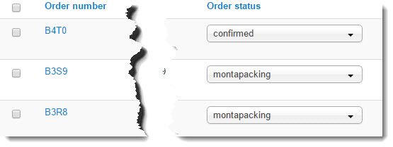

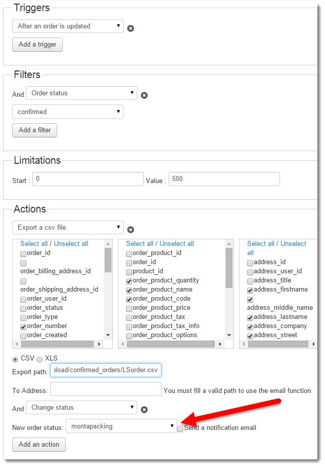

I have made a massaction that when there is an update (confirmed) to an order that I want to produce a csv file for the packaging company and after the csv file is created I want the status to be changed to montapacking (see images).
When I created an order and when the order is payed (changed to confirmed) the csv file is being created automaticly so that is OK, but the status doesn't change to montapacking.
What am I doing wrong?
Example of order page. The last order is not changed to montapacking.
Kind regards Wilfried

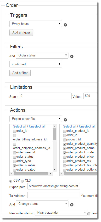

  • Posts: 75
11 years 7 months ago #187202
I even tried both (defined right after each other) but I can't get it to work with the triggers as described in the picture above. I also tried it with a default status (shipping) but no luck either. The csv is being produced but the next action isn't triggered.
I now made an hourly trigger of it and that seems to work. It produced the csv and sets the statusses right. I can use that for the production site, but I preffer the triggers after creation.

  • Posts: 75
11 years 7 months ago #187259
Thanks Jerome,
That is why I had set the trigger to After an order is Updated to completed, that indeed is set by the payment plugin. After payment (completed) I want to carry over the order to the packaging company. We do that with transporting a csv file to their ftp server. After the creation of the csv file I want to set a status that the order is carried over to the packaging company. So that orders won't be exported to csv anymore.
The strange thing is that with the situation above the csv is being created and the action after that isn't.
kind regards, Wilfried

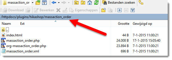

  • Posts: 75
11 years 7 months ago #187384
Hello xavier,
Did you test it with the proceed button or did you actualy create an order that goes to confirmed after succesfull payment? I ask this because it works with the proceed button but not when is goes automatically.
I am pretty sure that I use the plugin that is in the plugin/hikashop/massaction_order directory because I change the php a bit. (name created with date in it) and the csv that is created is with the date name as changed.
I have also tested it with the original php code to be sure that I didn't make a mistake when changeing the php code.
Wilfried

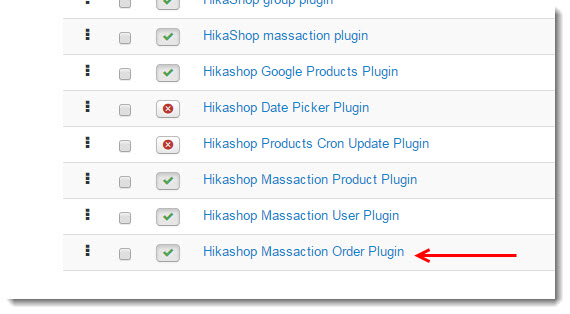

11 years 7 months ago #187415
I indeed tested by changing the order status in backend, so I just tried to proceed a common checkout on frontend and validate my order in frontend, no issues.
We now that the used plugin is this one, but we are talking about the plugin ordering ;)
In the plugin list, if this plugin is not the last one called, so another plugin can potentially manage the order status after this one, so please put this plugin at the end of the plugin list, this way it will be the latest called and the order status should be changed automatically.

Ok I know what you mean, but what kind of plugin should be conflicting then. The payment plugin has done its work because of the fact that the order has the status confirmed isn't it?
I have placed the massaction order plugin to the last position and after testing it still doesn't work.
Kind regards, Wilfried
