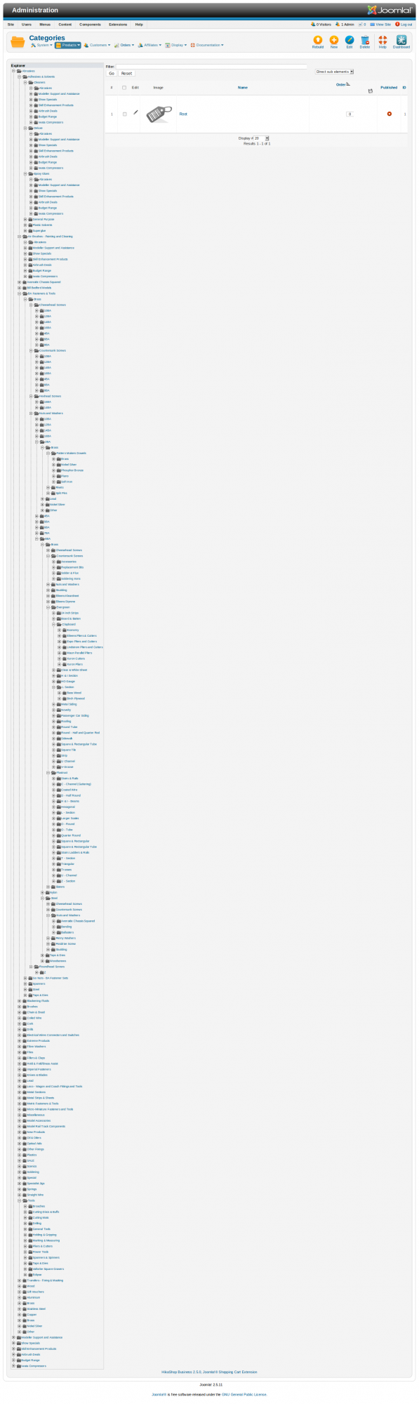

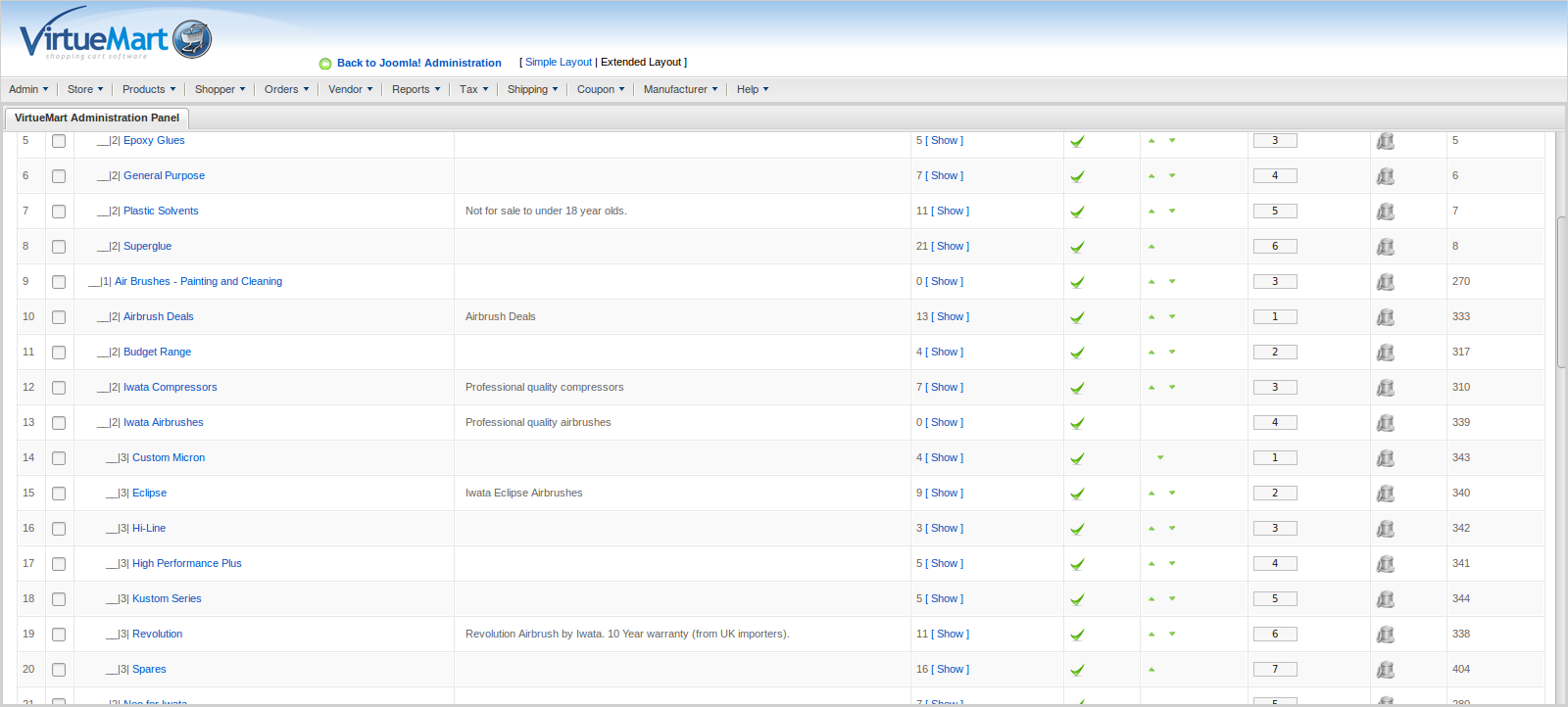

I have attached 2 screen shots, the VM is what the cats should look like, the Hikashop one is way off with incorrect duplicate entries and lost main and sub cats

Your category explorer looks strange in HikaShop.
It seems that the root category has been removed.
I don't know what happened during the import. Did you had the root and other default categories of HikaShop there before ?
Was the root category deleted during the import or after ?
If you click on the "rebuild" button of the categories listing, does that change something ?
Were the products correctly imported ? In that case, wouldn't it be simpler to fix the categories tree manually ?

The Root cat is there but the are other cats 'above' it
