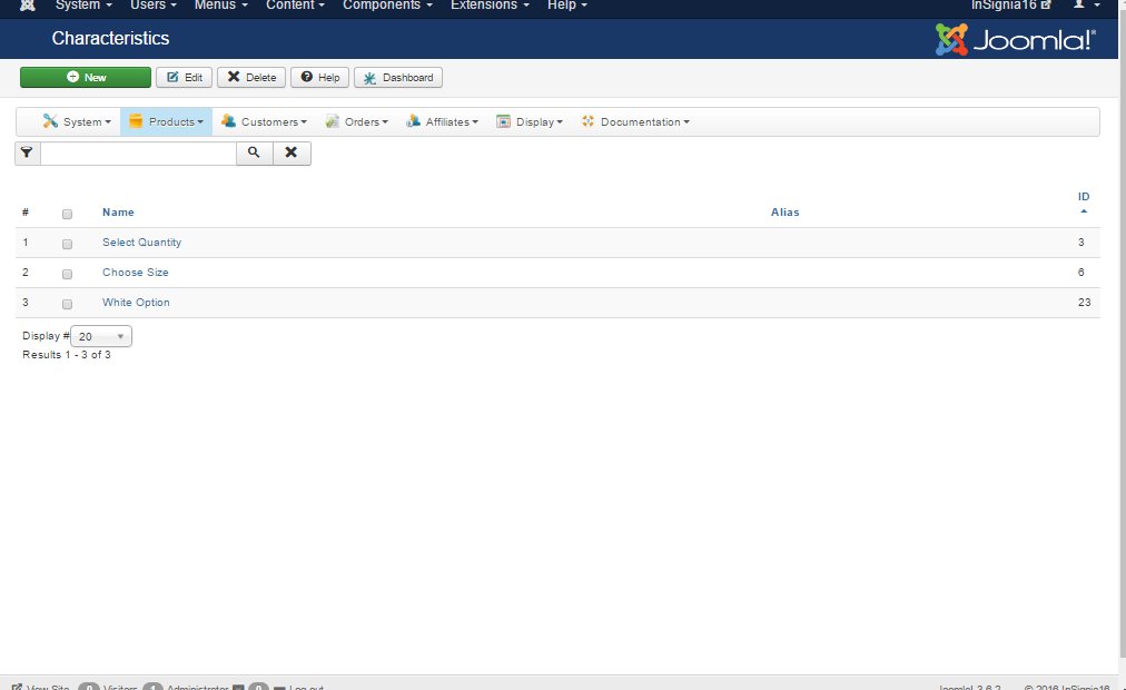

Before you import products with variants, you must make sure that all the values that you want to use are already listed in the characteristics that you can edit via the menu Products>Characteristics.
So please check on that.
The CSV itself looks fine.
  • Posts: 21
9 years 10 months ago #253079
Hi, those characteristics are already there
  • Posts: 86083
  • Thank you received: 14194
9 years 10 months ago #253083

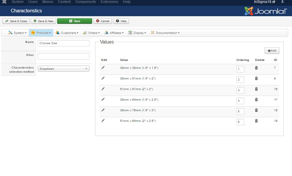

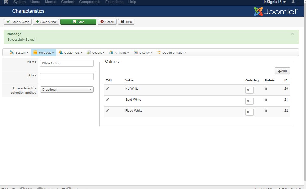

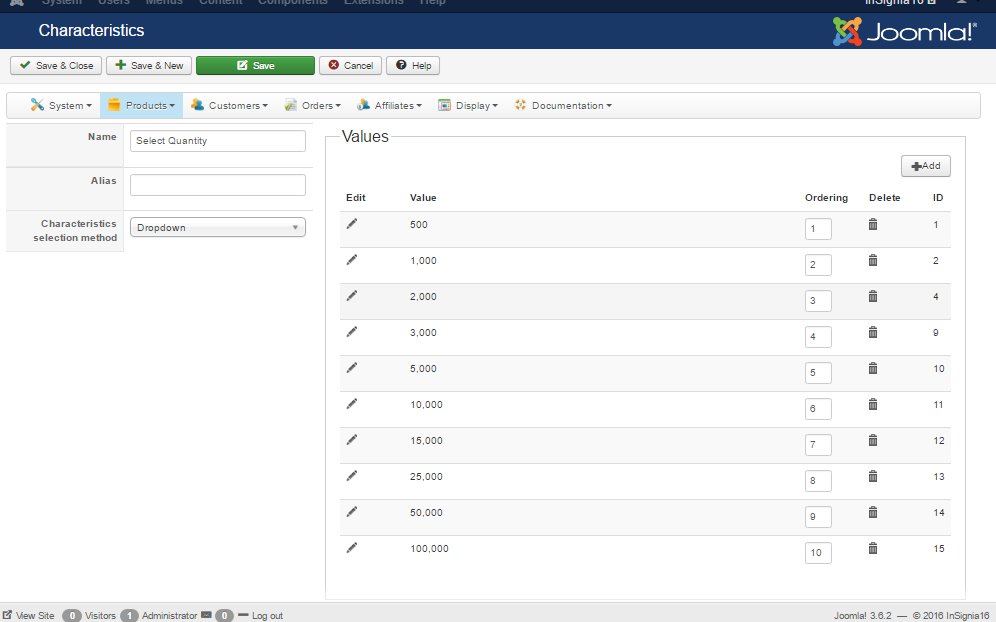

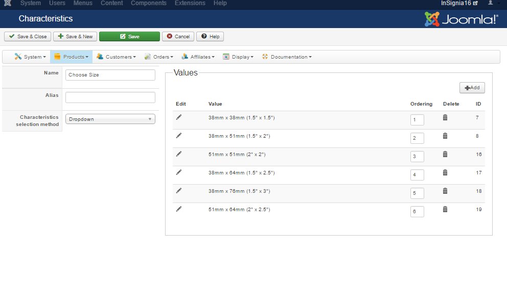

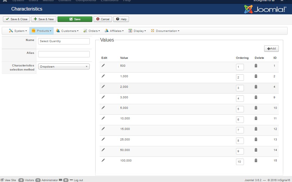

Can you provide screenshots of the settings of these characteristics please ?
  • Posts: 21
9 years 10 months ago #253130
See attached

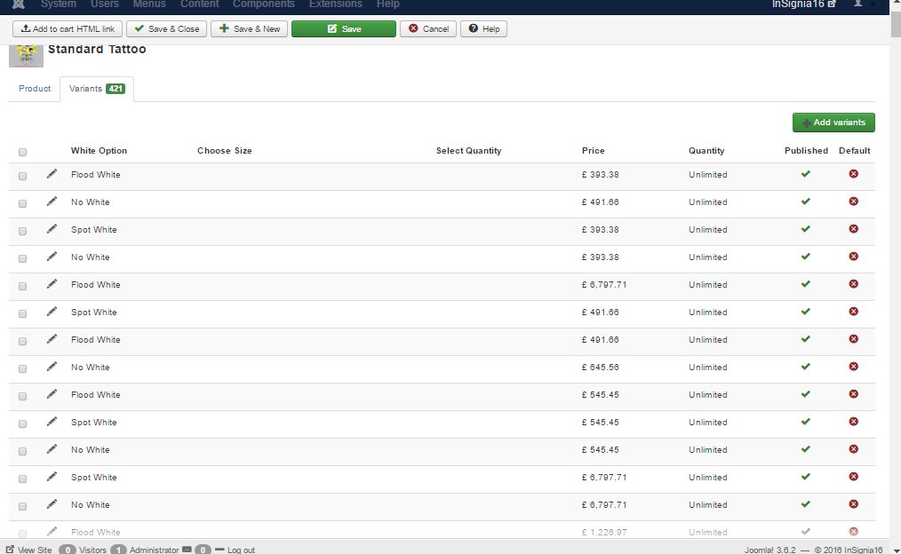

I have just imported the original export I made, it shows the dropdown options, but if I add any new products to the spreadsheet it seems to then disable the dropdowns for the quantity & size, but not the white options.
It must be something I am doing wrong when adding a product to the spreadsheet, only thing I can think of?

It looks like you don't have the values of the "Select Quantity" that you're trying to import.
Here is what you have in your CSV: take.ms/w05QW
and among them only the "500" value is present in your characteristic values screenshot.
So either correct the CSV to have the exact values that you have on your website, or add the missing values in the characteristic on the website.
  • Posts: 21
9 years 10 months ago #253224
Ok, on the quantities that did not appear on my spreadsheet, strange. I took all the commas out of the quantities as the csv would not allow commas, the quantities are now appearing, but the sizes are not appearing apart from the 2 different ones I entered onto the site when building the product, all the sizes I've added to the spreadsheet are not showing, could it be it would not import anything with a " in?
eg, my sizes show as 1.5" x 1.5", maybe I should try this as showing as 1.5in x 1.5in ?
  • Posts: 21
9 years 10 months ago #253225
I tried using 1.5in x 1.5in as opposed to 1.5" x 1.5" and that didn't change things, but now the prices on the larger quantities are not importing, very confusing as to why this is happening, any help would be appreciated

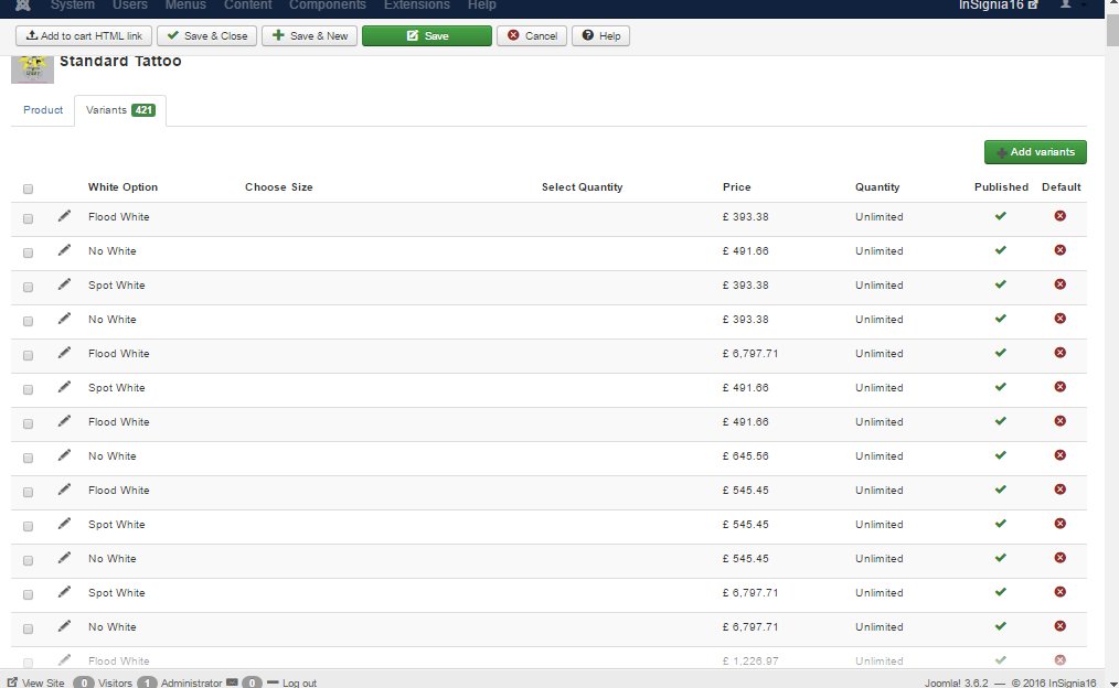

  • Posts: 21
9 years 10 months ago #253226
Update
I have found a slightly long way round, if I enter the variants into the product in Hikashop and export, I can then add the prices and weight into the spreadsheet and import, this seems to get round the issue of having the variants appear on the site, had hoped I could do everything in the spreadsheet, but at least this is a slightly quicker option.
