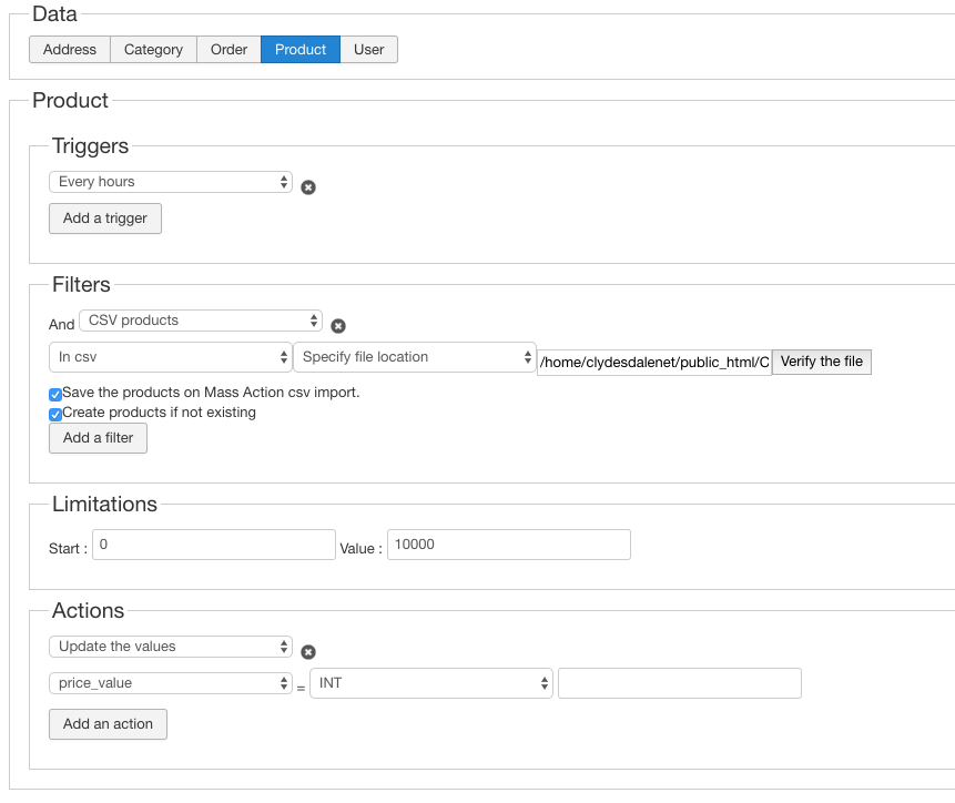

I am trying to upload prices via a CSV using the mass action tool. However I have found that the prices are displaying on the front even thou they appear for each variant in the backend.
I am using mass action but I believe I need to setup an action but I am unsure how to do this. I have read the documentation but I don't understand it enough.
Do I select an action 'update the values' then select 'price_value' But I don't know what it is equal too and what else I need to add?
I have attached a screenshot of my setup so far.

Hello, I have updated my hikashop with the latest version but I don't understand what it has meant to have fixed? I am still receiving the same problem. Was my action settings correct from before?

Okay thanks for explaining what was fixed but I am still unable to see the prices on the front end using mass action even when using the action 'display_the_results'. The variant prices display in the backend for each variant fine but nothing displays on the front still?
