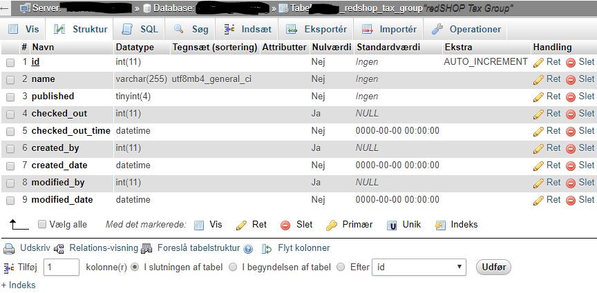

This is a column which is supposed to be in the table redshop_tax_group of redshop. Could you check in your phpmyadmin for the structure of that table and provide a screenshot of it ?
Could you also provide your version of redshop ?

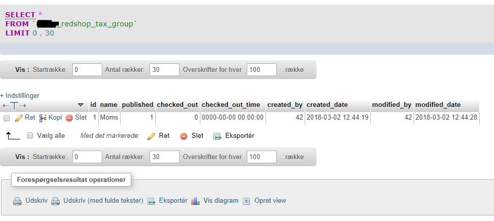

Hey
here is 2 screenshots, the version on redshop is 2.0.7

8 years 5 months ago #289429
Thanks. The table structure indeed changed.
I've added a patch for that on our end.
Download the install package on our website and install it on yours and you'll get the patch. Then, you can run again the import.
