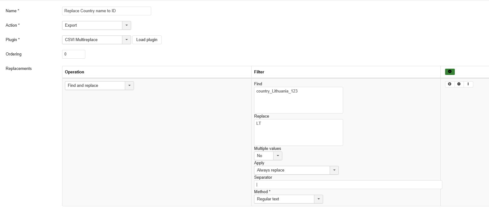

In case it will help i would like to note that CSVI component has brilliant plugin where you can find and replace fields. Please check my screenshot attached. We do replace country by it's ID or whatever we need so you could do same for each state or country.
Hope that helps.

kyratn,
Thanks for your reply. I did find the Find / Replace plugin and I'm able to setup an action to remove the 'state_' and 'country_' prefix to each of the fields. This works well, however it is the text after the state/country which begins with the _underscore and then has a series of numbers.
Because my client ships to countries around the world I would need to create possibly hundreds of actions to cover every state within each country, for instance just for the United Kingdom there are 48 counties alone. Multiply this for countries around the world and the number of actions would be huge!
Is there no find / replace action I can use so that any text that appears after the underscore is removed, I tried using _* but that then replaced everything as it applies to the entire text!
I'm not a PHP / MySql guru but would setting up nine actions that would use _1* to _9* as the find / replace option work?
Lee
