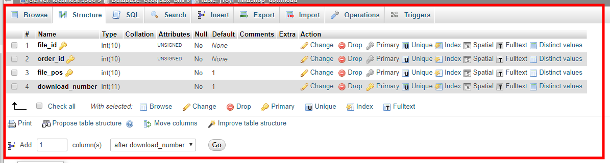

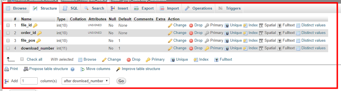

  • Posts: 127
7 years 7 months ago #303145
Thank you. I am looking inside the table: j16yr_hikashop_download but it is empty :(
Here is the structure of the download

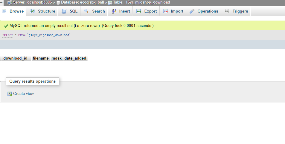

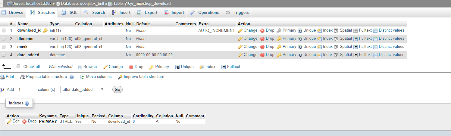

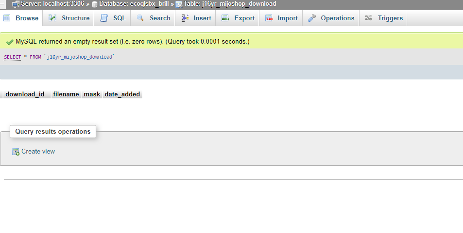

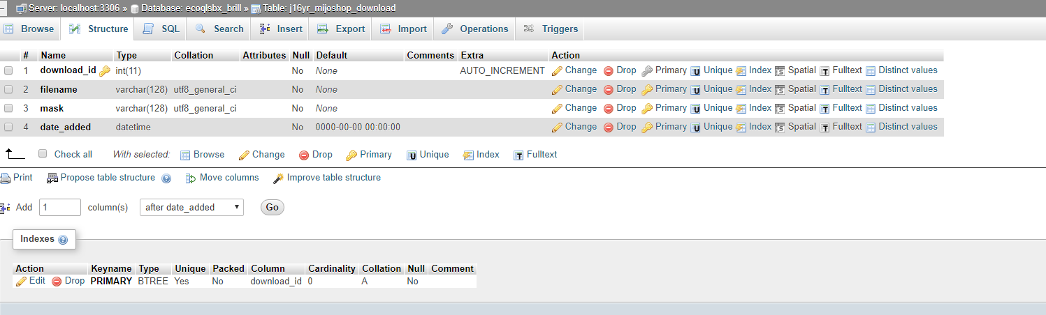

  • Posts: 127
7 years 7 months ago #303188
Sorry, my mistake. I look Mijoshop and it is also empty
Here is structure of the table
  • Posts: 86083
  • Thank you received: 14194
7 years 7 months ago #303212
The remaining column has apparently been removed from that table in your mijoshop.
Remove the line:
'download_number' => '(' . $dl_limit . '- mjd.remaining)'
from the file administrator/components/com_hikashop/helpers/import/mijo.php and run the import again and you should not have the problem.
We'll change the code there as well to avoid the problem for others in the future.
The following user(s) said Thank You: komir
