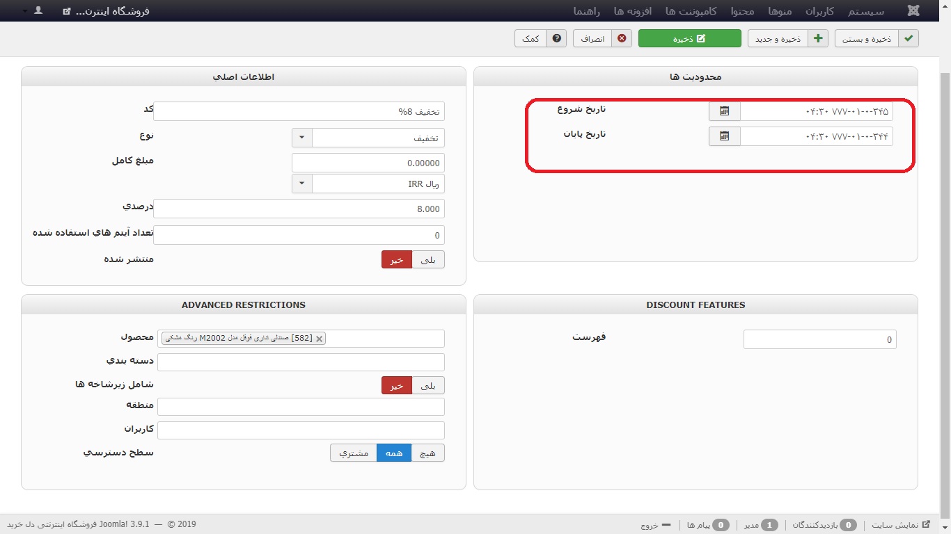

7 years 2 months ago #308624
The parts that do not work in Hijri Shams' history are as follows:
1- Download section in user profile
2- Creating copon codes and sale after editing and re-storing.
3. Reports and Chart Completely
4-Export files Which is, of course, completely in Persian and none of the columns are displayed correctly.

Regarding the date selectors in the discount edition and report edition, I don't see what is wrong.
Please understand that I can't read persian and I don't know how the Hijri Shamsi calendar works, so I'm a little lost.
Could you provide more information? What should be displayed there ?

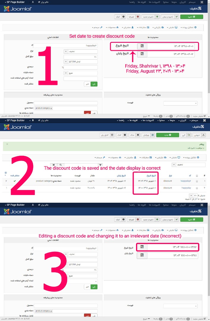

I think about the discount code with the image I have attached and the description on the image so you can see what the problem is.

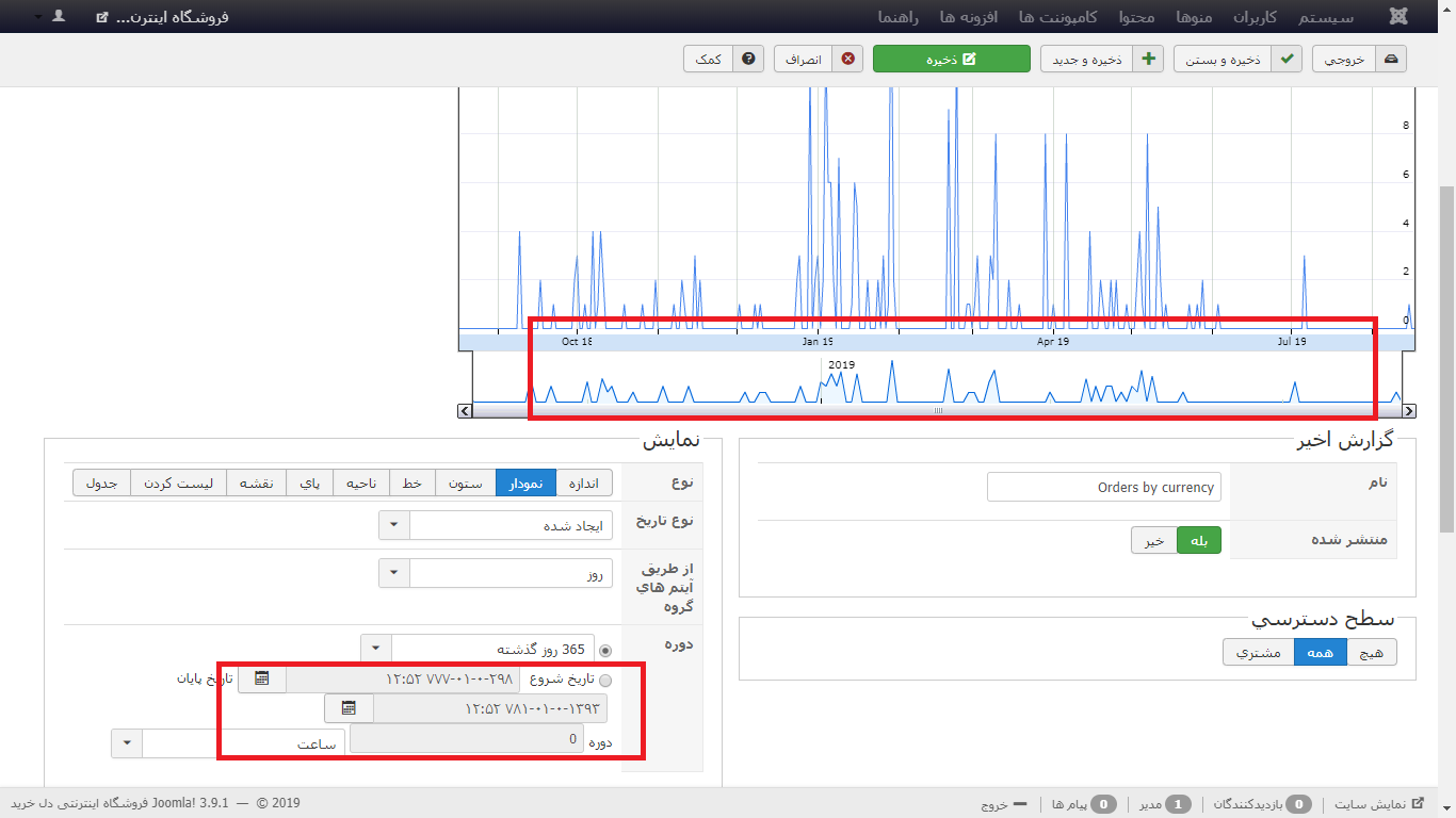

There are two problems with the reporting section.
1- In the charts, the date is displayed in AD. (Not Farsi)
2- In the settings section of the report, there is a Persian date, but it is displayed incorrectly. (Like discount code)
But let's put everything in CSV in the next post.
