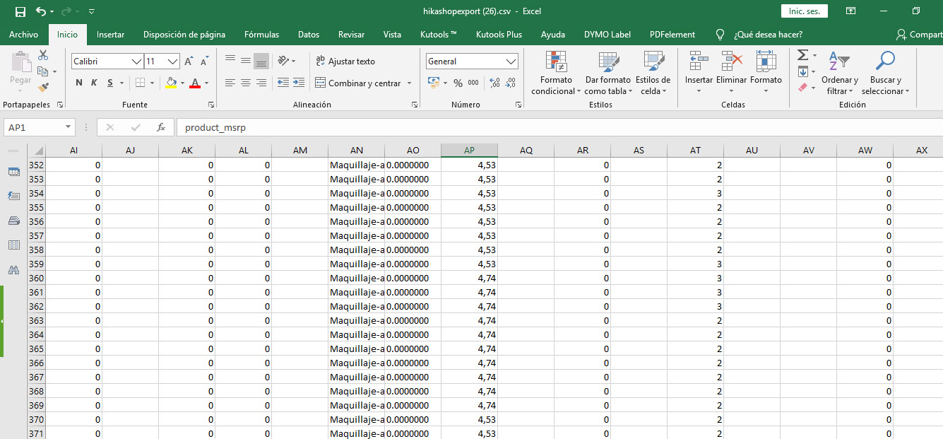

Got these 2 problems:

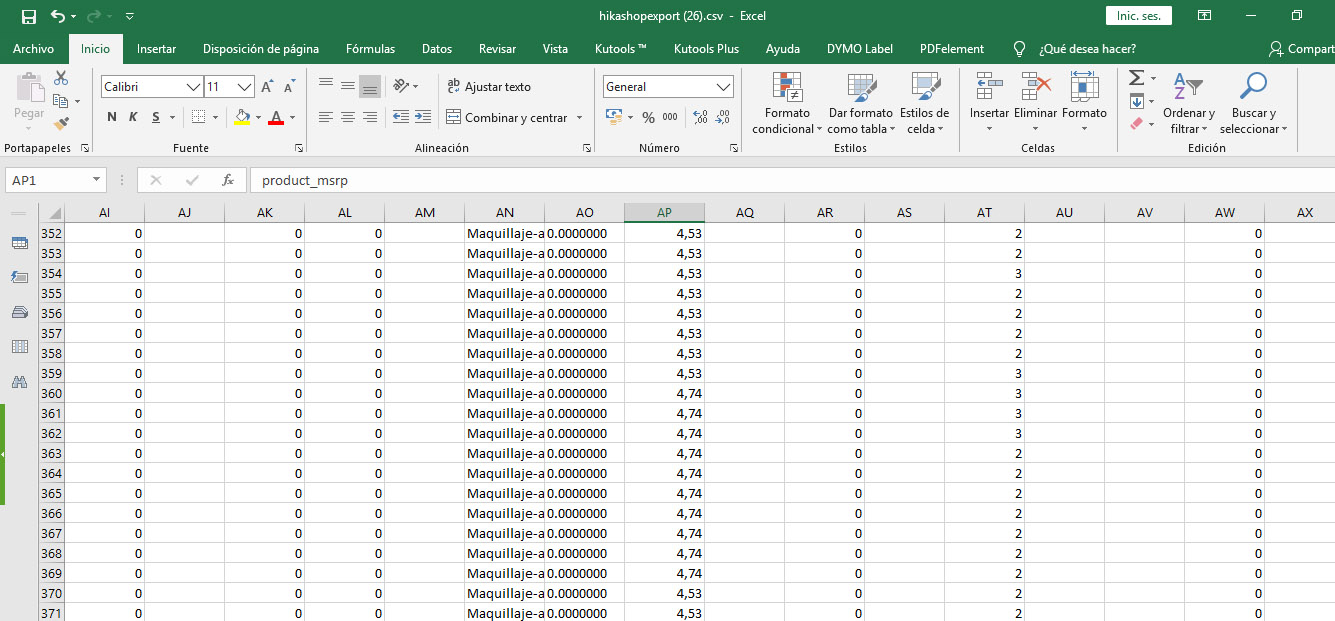

When i do a product export, the product_msrp column returns the price with a comma. So 4,53 € will be shown on the website as 4 € when i upload it again after a change. What can i do about it. See photo msrp.jpg.

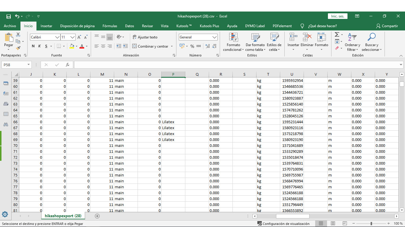

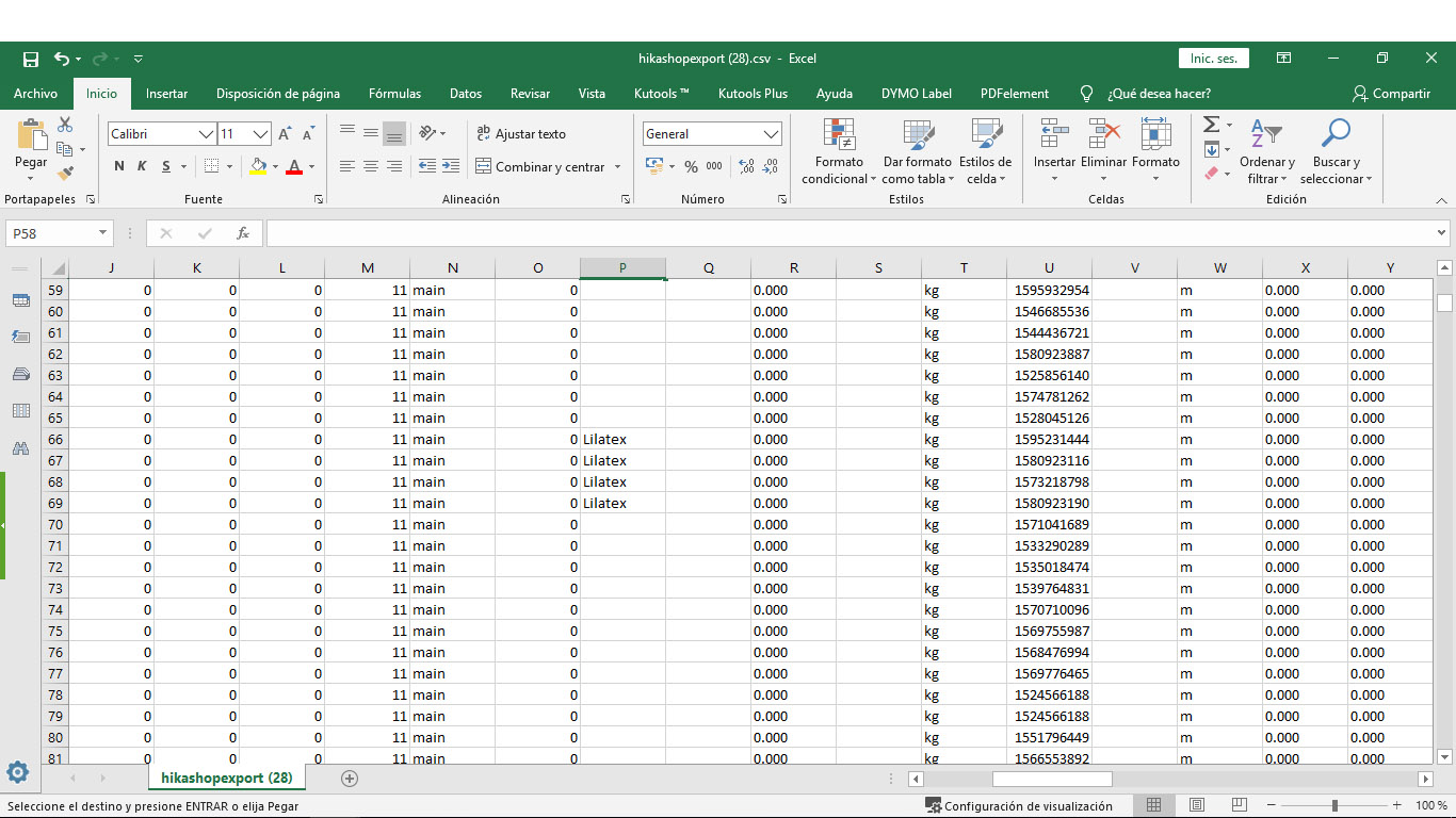

When i do a product export, the product_manufacturer_id column doesn´t return all the manufacturer ids. All OK except Superstar and Diamond FX. Am i doing something wrong.
Thanks in advance

5 years 10 months ago #322622
- The numbers will either have a comma or a semi colon as a decimal separator based on the setting "CSV decimal separator" under the Files section of the HikaShop configuration. HikaShop can import CSV files with either, but the software you're using to open the CSV file might only work fine with one or the other.
- The system will output the brand name in the "product_manufacturer_id" column or nothing if the brand is not found.
It shouldn't contain the id of the brand. So I'm not sure how you would get what you describe.

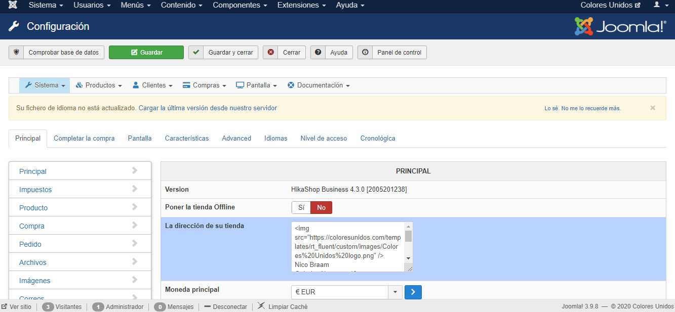

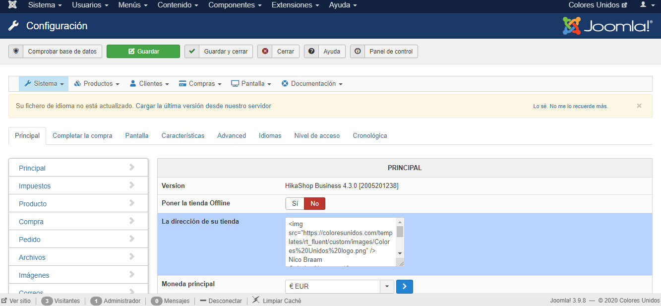

Can you confirm the situation ? And can you confirm that you're using Hikashop 4.3.0 ?
And do you have the file administrator/templates/isis/html/com_hikashop/product/export.php on your website ? If you do, does renaming that file help fix the problem with that column ?

The first problem is solved (i hope) did 5 product exports and they all were OK :)
SEE PHOTO ATTACHED
THERE IS NO PRODUCT FOLDER WHICH MEANS THERE ISNT A EXPORT.PHP FILE

5 years 10 months ago #322673
Thanks for the access.
From what I can see the problem is that you have categories and brands with the same name (diamond fx and superstar), and the element selected in the product's "brand" setting is the category instead of the brand.
It's impossible to select a category as a brand with the brand selector we've added a few years back.
But before, it was possible, and it is still possible to do it with a CSV import.
As it's only two brands, I've run a mass action for you to update the product_manufacturer_id in the database to use the id of the brand instead of the id of the category and now you have the name of the brand in all the rows of that product_manufacturer_id column in your CSV.

  • Posts: 37
5 years 6 months ago #327845
Hello again,
The product_msrp problem is solved by choosing a point at the CSV decimal separator option in the Hikashop configuration.
