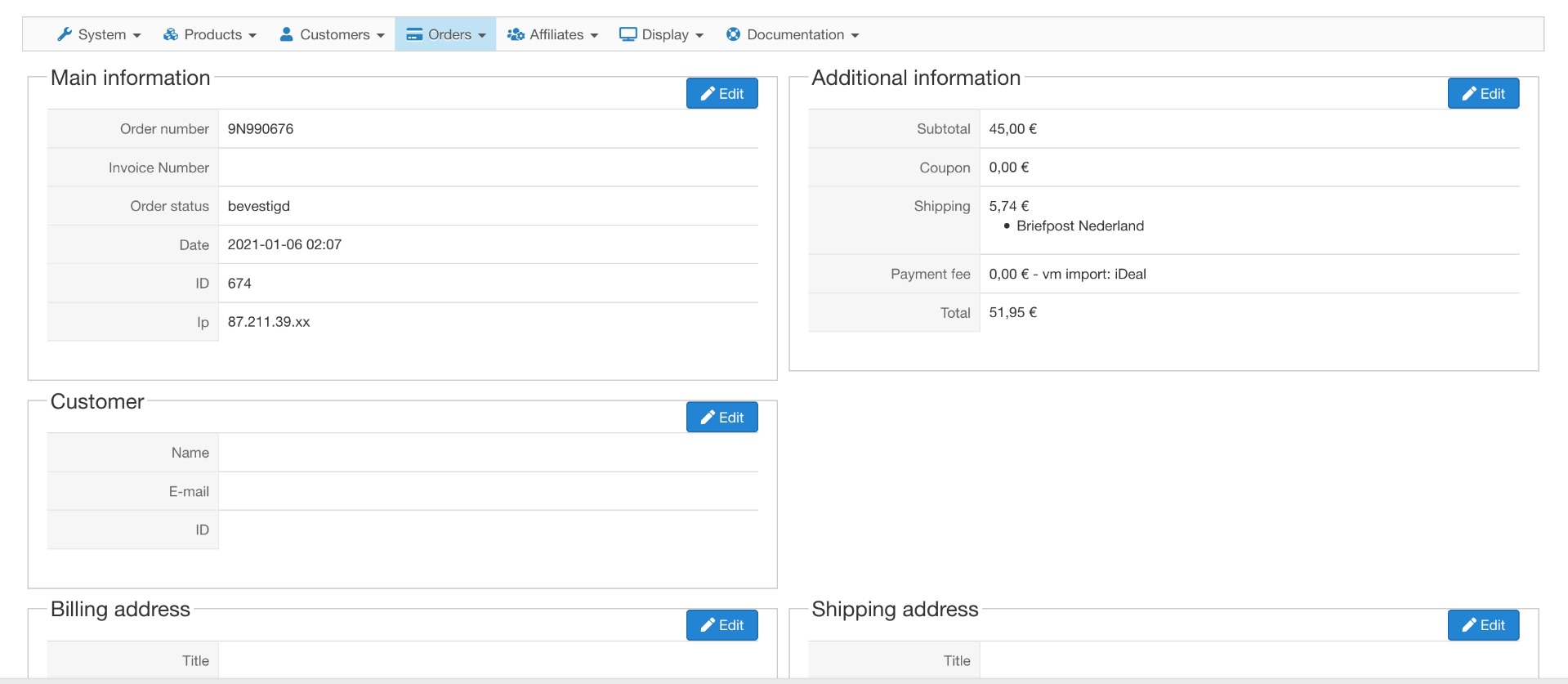

Hi there,
I did an automatic import from VirtueMart to Hikashop and saw that all orders are missing the client info. It's a shop without log-in / users, only ordering as a guest. Maybe that's the issue. Is there a possibility to import that info?

When we built the import system 10 years ago, VirtueMart didn't have the capability to handle guest checkouts.
So this capability was not implemented in the import system.
Now I don't know if VirtueMart supports it by default or if it needs a plugin, nor how the information is saved in the database.
What I can say is that it would surely require some development work to support that.
