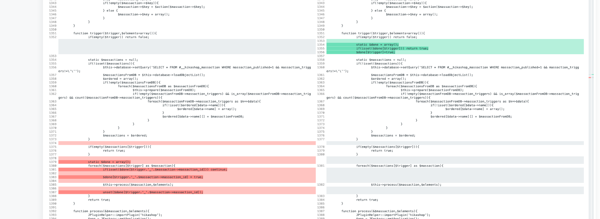

After updating HikaShop our cron job is not working properly. And we have to adjust the massaction.php
And the export is working again.
See our modified code
attached.
Many thx
Nadine
