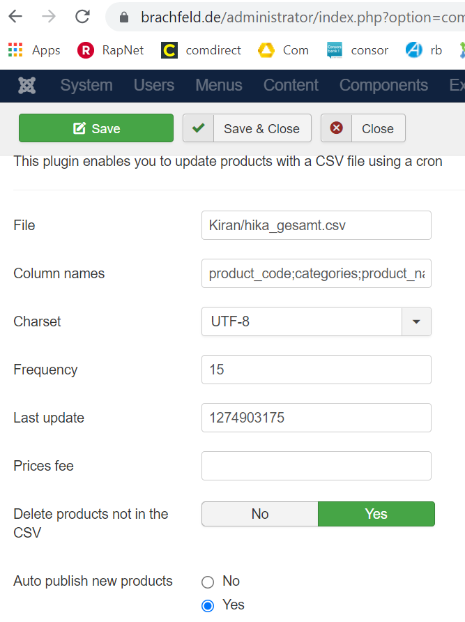

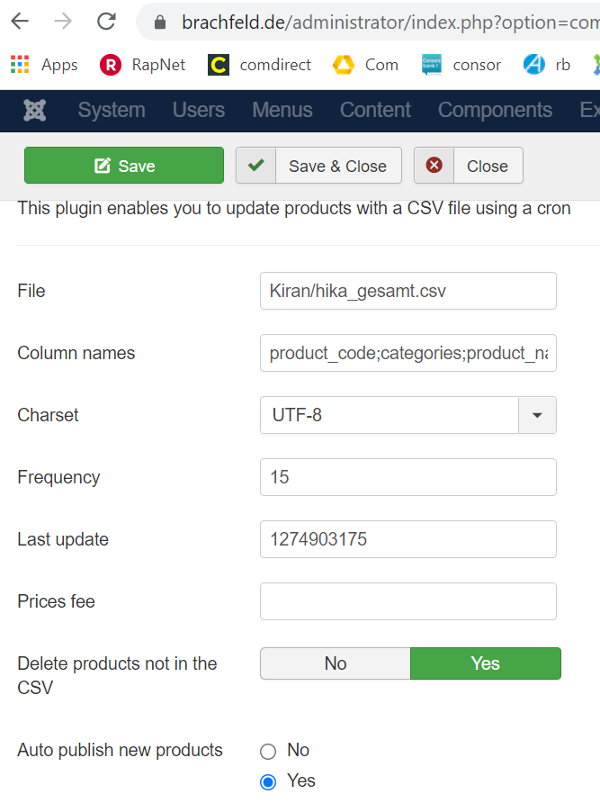

We use Hikashop Products Cron Update Plugin.
Yesteraday we upload new SSl Certificates and now we get this error:
Could not retrieve the CSV file brachfeld.de/Kiran/hika_gesamt.csv
In plugin is adress:

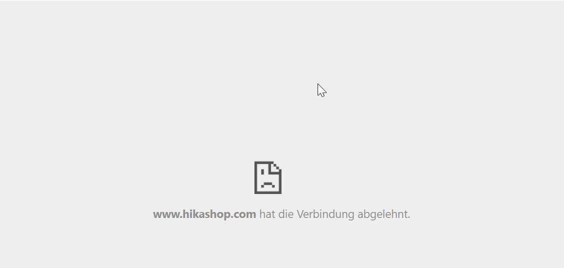

  • Posts: 25
4 years 9 months ago #336900
It doesn't help. I don't think, it is ssl problem.
If I try in cron in "Create/edit your Cron task" to activate cron I get the message "hikashop connection denied".
Rgds Robert

  • Posts: 25
4 years 9 months ago #336965
