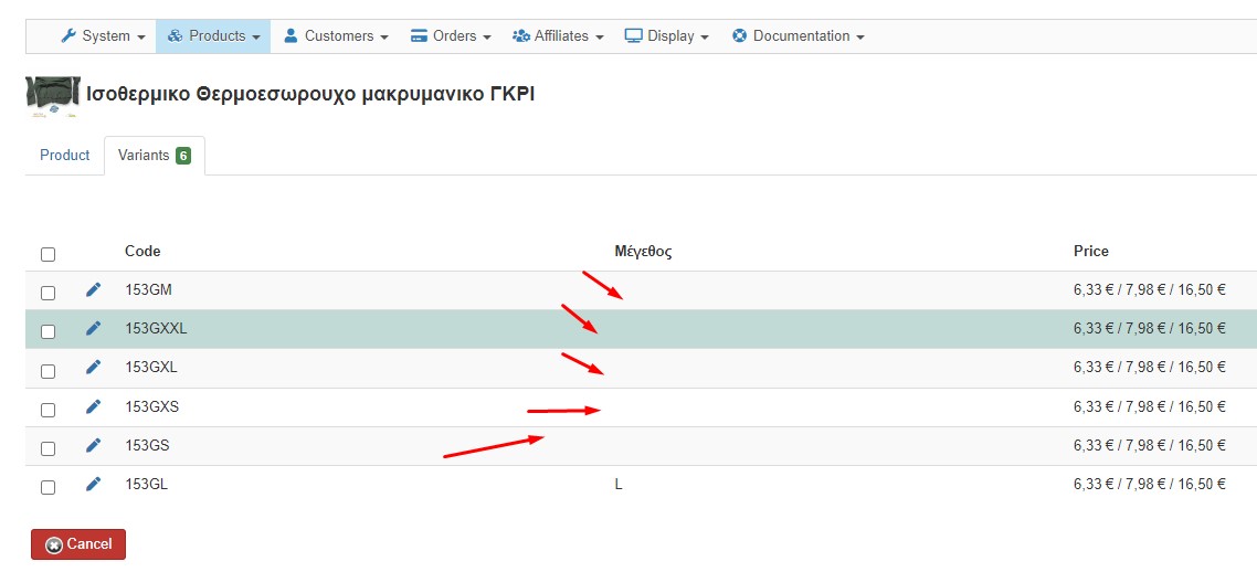

-- HikaShop version -- : 4.5.1
-- Joomla version -- : 3.10.8
-- PHP version -- : 7.4
Ιmport procedure create new product id's : 153GM 153GXS 153GXL 153GXXL while the mentioned product id already exist in database
both parent id and product id are the same
  • Posts: 86183
4 years 4 months ago #341394
This sounds like the value entered under the column of the characteristic in your CSV doesn't exist for that characteristic in the HikaShop backend.
For example, if you have an extra space at the end of the value for that characteristic, this could happen. And in that case, since the system can create the variant, but doesn't know to which value it should assign the variant for that characteristic, there would be no value displayed in the column of that characteristic for the variants with the issue.

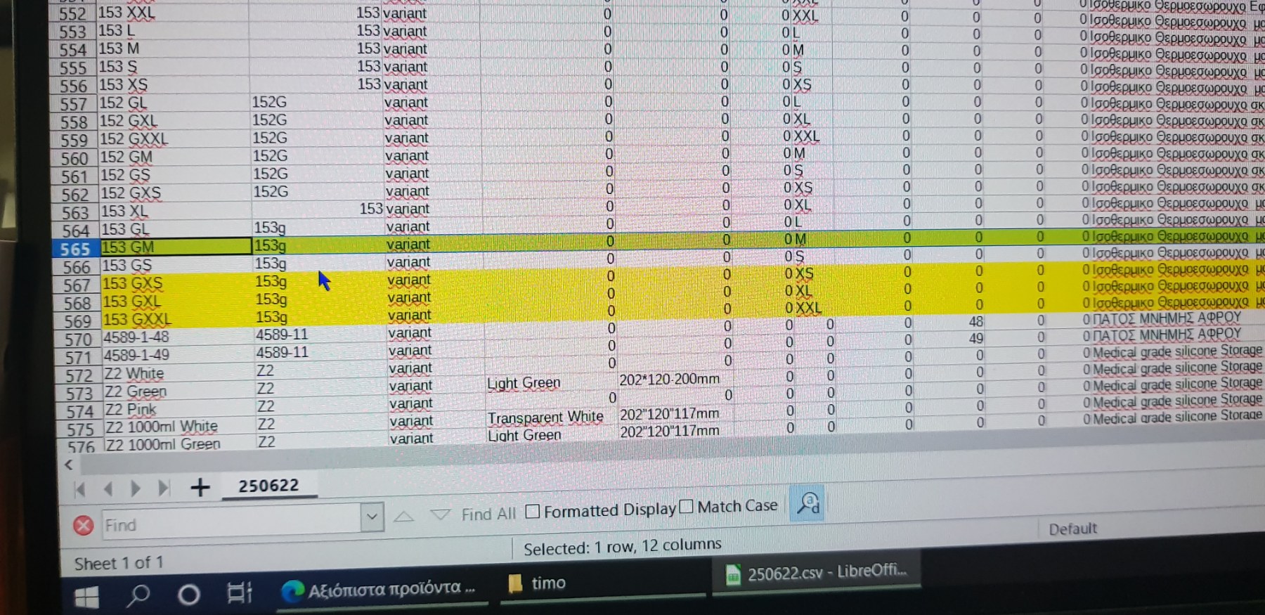

  • Posts: 1184
  • Thank you received: 13
4 years 4 months ago #341743

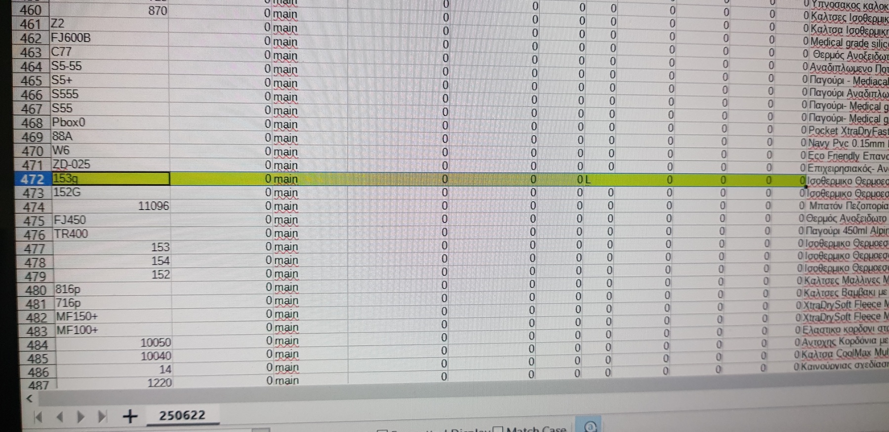

Please check the file I uploaded, I only erased the prices.
Do you see any error?
problematic product code 153g (main) 472 line
variants lines 559 to 564
  • Posts: 86183
4 years 4 months ago #341749
You're missing the columns for the characteristics of your products / variants in your CSV.
I would recommend you to check the section "Importing products with variants" of our import documentation here:
www.hikashop.com/support/documentation/7...shop-import.html#csv

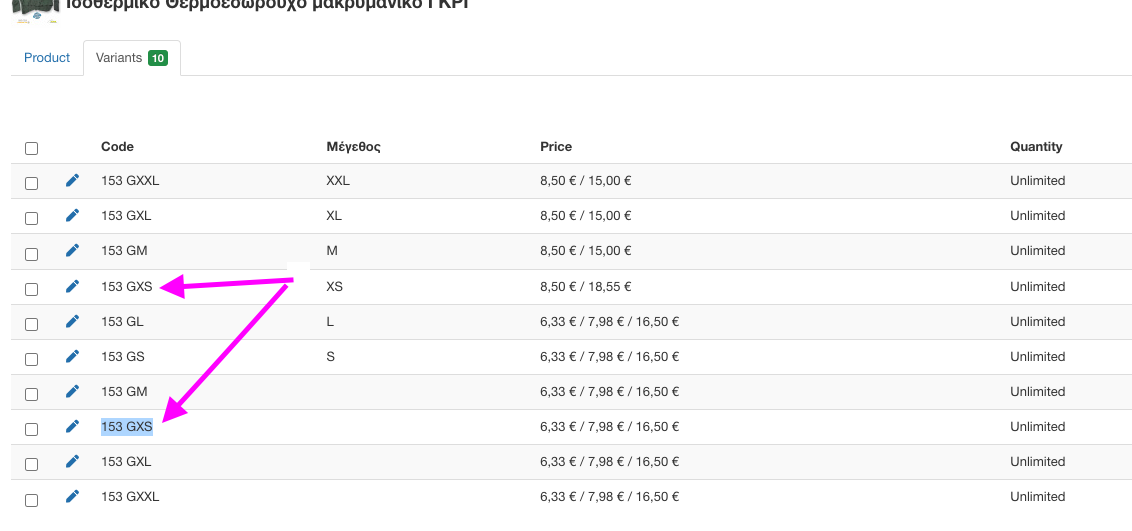

4 years 2 months ago #342842
Hello!

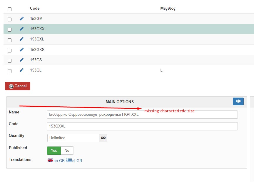

We tried to import with the new columns (characteristics) and default value on the main product. But again it created the unecessary rows
Please check printscreens and csv imported.
I can give you backend if its possible to try it yourself.
Last edit: 4 years 2 months ago by verzevoul. Reason: Not all files were uploaded
  • Posts: 1184
4 years 2 months ago #342843
  • Posts: 86183
4 years 2 months ago #342844
You can't have "0" for the columns of characteristics you don't want to use for a variant / main product. You should have a completely empty cell.
Here, the system thinks you're trying to add variants with characteristics with a "0" value.

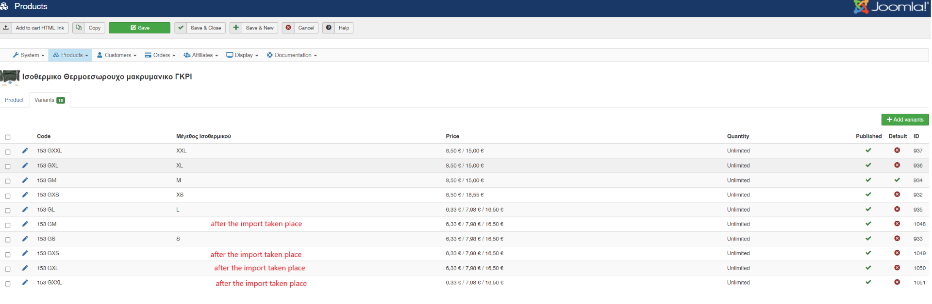

  • Posts: 1184
4 years 2 months ago #342958

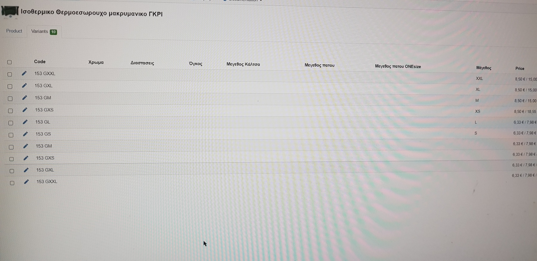

Hello Nicolas and thank you for the reply!
I tried as adviced but still these extra variants are created.
Please check my scv.
Look for the groduct with product_code : 153g
This is the main product that has the default value (L) for Large and his variants as you chech product_parent_id: 153g
But again we have dublicated entries see screenshot 2

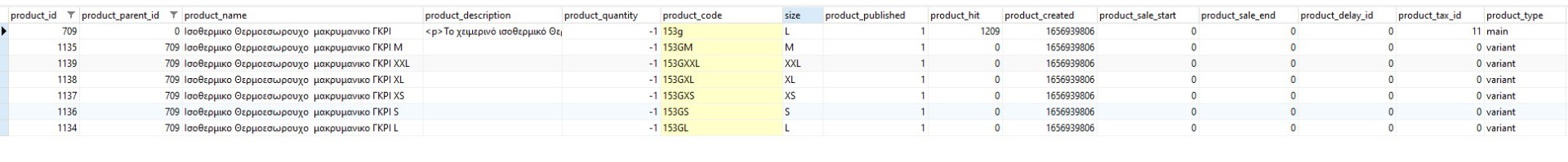

  • Posts: 1184
4 years 2 months ago #342983
If you import this csv , in my installation I get all ok in the db (see attached) but in the backend there is no
  • Posts: 86183
4 years 2 months ago #342982
Yes. It works fine on my end (minus the missing columns that I didn't create on my end like xml_show).
Please note however that you've changed the product_code of your variants. Before they had a space between 153G and the size. If the variant doesn't have the same product_code between the CSV and the database, the system won't be able to update it and that could explain why it's adding extra variants instead of updating them.
Now there is a solution to this:
If you turn off the "KEEP_OTHER_VARIANTS" setting, the import will delete the old variants when importing the new ones, so it will be as if it was replacing them (although the information not provided in the CSV and already in the variants in the database will be lost (like for example the "product_description").
Also, did you check the "values" of the characteistic itself in the menu Products>characteristics to make sure that the values are exactly the same as you have in the CSV file (no extra space) ?
Last edit: 4 years 2 months ago by nicolas.

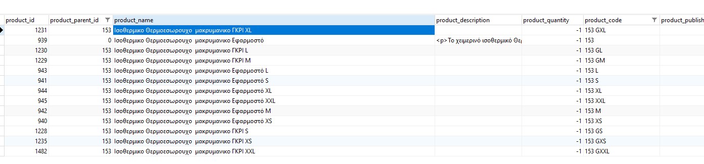

3 years 8 months ago #348313
Hello Nicolas!
In this matter we still get a problem .
Whan we import csv as we already discussed we have as parent _ id the product code. And in some cases it doesn t work. I think it doesn t work when the value is int. Is it true?
Because for examle you see attached the product with code 153 that has some variants. They where created in the database but with the wrong parent_id.
It should be 939 because id 939 has product code 153.
But if its code was 153f (for example) not just int, import i think works.
Is it true? How can we overcome this?

Indeed. If you provide an integer, then the system will think you're referencing a product_id and not a product_code and so it will first look for the product with that product_id and only if it doesn't find it, it will look for the a product with that product_code.
There are three ways to overcome this:
- don't use a number for the product_code
- use a number which isn't a product_id
- delete the code:
if(is_numeric($parent_code)){
					foreach($products as $k2 => $main){
						if($variant->product_parent_id == @$main->product_id){
							$parent_code=$main->product_code;
from hikashop/administrator/components/com_hikashop/helpers/import.php so that it doesn't look for the product_id, only product_code
