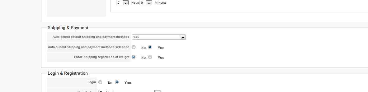

  • Posts: 61
12 years 9 months ago #121448
administrator -> hikashop -> settings -> Shipping & Payment
Auto select default shipping and payment methods = Yes
administrator -> hikashop -> Shipping Methods
Configure and Publish One

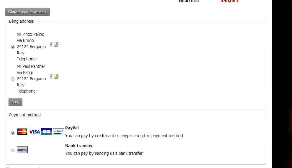

  • Posts: 49
12 years 9 months ago #121555
Hi Jerome,
i don't know what you mean.
This is what I see in the checkout. See the picture enclosed.
I can create a lot of addresses, but how can I select one as the shipping and the other as the billing address?

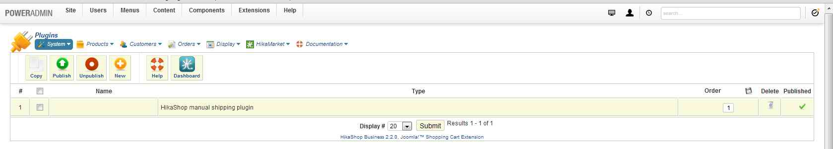

  • Posts: 49
12 years 9 months ago #121568
Hi anlicor,
I think I have done everything as you has written.
See the enclosed screenshots.
  • Posts: 49
12 years 9 months ago #121581
Hi anlicor, hi Jerome,
it works !!!
I had to set YES also the Option: Force shipping regardless of weight.
Thank you for your help!
