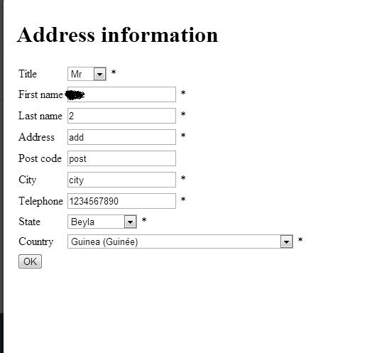

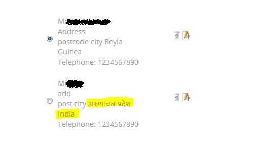

-- Error-message(debug-mod must be tuned on) -- : Address edit popup does not populate correct state and country in drop down at back end. And at front problem is different, when we edit address it select the correct country and state but not of one which is selected.Like if there are more than one address if we select second one it populate state and country of first one.
