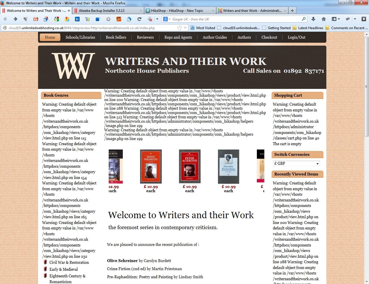

I have just restored my site to a new host and their is issues when i preview the site. The actual site is still running on the old host at the moment. Attached is a screenshot of the errors which mostly point to view.html.php file.

12 years 11 months ago #125924
HikaShop 1.6 was not PHP 5.4 compliant so it will display warning notices.
You can update HikaShop yes. You can also deactivate the PHP notices which should be disable in production mode (much better).
It is not real errors, just warning notices ; it does not generate any kind of problem instead of display something in your page.
  • Posts: 55
12 years 11 months ago #125947
I updated and it worked but now i have another error which im sure is down to permissions probably.
Where the thumbnails of my images should be i get the below error.
Warning: file_put_contents(/var/www/vhosts/writersandtheirwork.co.uk/httpdocs/media/com_hikashop/upload/thumbnails/200x200/byron.jpg): failed to open stream: No such file or directory in /var/www/vhosts/writersandtheirwork.co.uk/httpdocs/libraries/joomla/filesystem/file.php on line 418
Hope you can help
Dave
12 years 11 months ago #125950
You should have a "media/com_hikashop/upload/upload/thumbnails" directoy which should have write access for your website.
We update the product page in order to use the new thumbnails features (which are already used in the backend for the image gallery).
I think it is a permission problem.
  • Posts: 55
12 years 11 months ago #126086
Thanks,
For some reason I didnt have a "thumbnails" directory just "thumbnail". I created the directory and I had to give it full permissions for it to work and also had to give full permissions to the "thumbnail_79x50" directory for recently viewed items module to work. I have reset the permissions back and it appears to be working, though im sure other permission errors will pop up as well.
