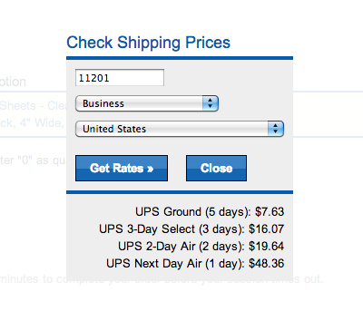

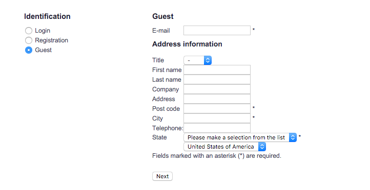

  • Posts: 75
10 years 6 months ago #229946
Hi Jerome
The UPS shipping fee only need the zipcode for the shipping cost calculation.
Is the a way to have in the second step after "cart" of the checkout process some kind of "guest" registration only with a field for the zipcode for the shipping cost calculation. The next step is then
"shipping" with UPS shipping cost. After this step then the proper "login" or registration. And after this then the cart with shipping cost.
Thank you
