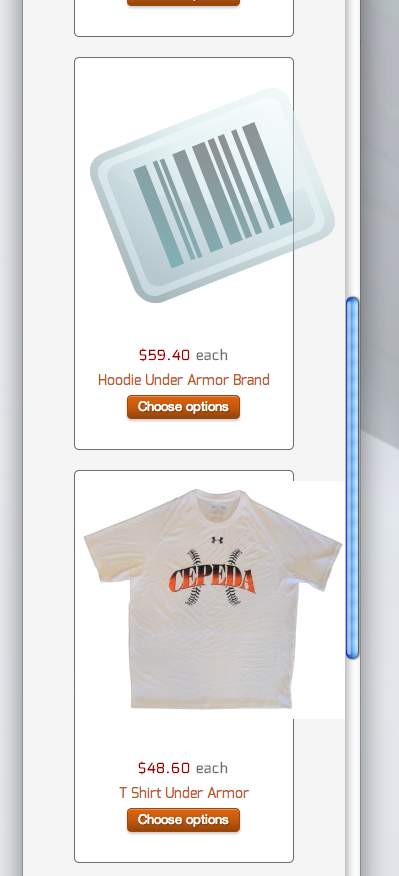

The template I am using is by rockettheme called Rt_chapelco, and it is responsive and using bootstrap. The images throughout the site change size automatically at the brows changes size but not in the hikashop store. I have enabled the Use bootstrap design radio button in the display tab of the configuration, is there something else I am missing? Why don't the images change size in the store section of the site?

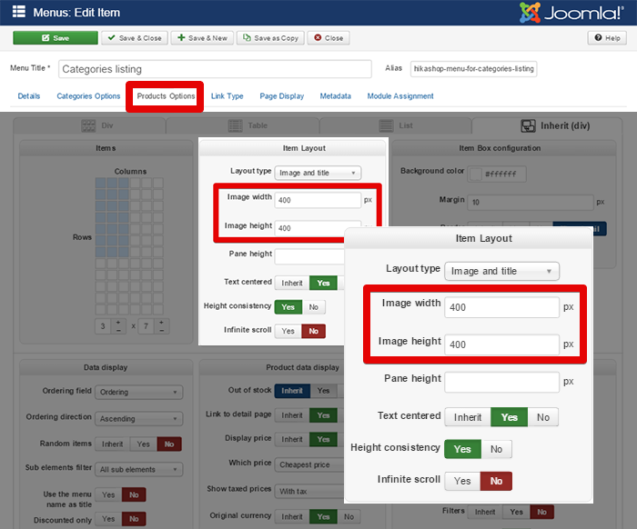

So, can you check in your Item Menu configuration, if you have some image size configuration ?
In Menus => Main Menu, and select your concerned listing, then go in Products Options tab :
Here, if you have some size configuration that will "break" HikaShop responsiveness, and so maybe add Css order won't be required.
Awaiting news from you.
