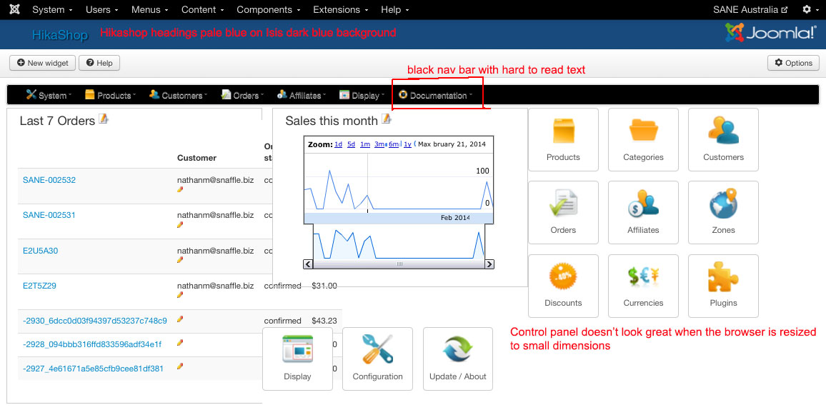

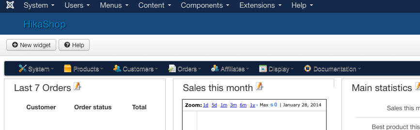

I've come across a strange problem with a fresh install of Hikashop 2.2.3 on Joomla 3.2.1 to do with the Navigation bar in the administrator area.
As you can see from the attached screenshot it has a black background applied to it, which makes it very hard to read. I've had a look at the code in the admin area and there is some extra CSS being added in to the Head section of the administrator area which is overriding the default Isis template css (which should be just a light grey gradient with black text). The extra code is as follows:

I think you misunderstand me... I'm not talking about the nav bar being dark blue, but the header area at the top of the administration area where the Joomla logo is and component title. I get this problem on all of the 3.2/Hikashop sites I have.
I've attached a new annotated screenshot of my admin area and have removed my CSS fix so you can see the issue I'm having with the nav bar being black.
While doing this I resized my window to take a smaller screenshot and also noticed that the control panel interface doesn't resize very well so have made a note of that too.
I'm pretty sure I don't have any extensions installed which affect the admin interface but there is clearly something not quite right with the CSS.

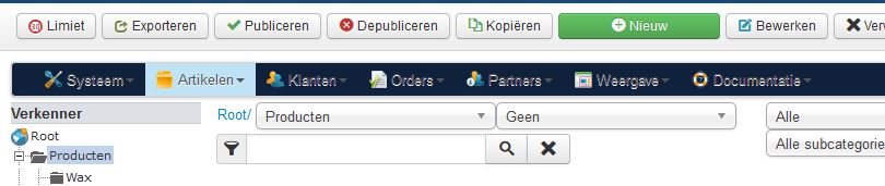

Same problem here, navmenu difficult to read
After update from Hikashop 2.3.0 to 2.3.1

12 years 3 months ago #157027
Isis have a very nice bug : it safe the color even if you don't specify one.
It means that if you save one single time the option of isis, it will force the color of every navbar in the backend.
You can't remove the color from the configuration, just not possible.
So you can :
- edit the configuration in the database directly
- put some extra CSS in your HikaShop backend css file, to force the navbar color to a... real nice color.
#content .navbar-inner {
	background-color: #fafafa;
	background-image: -moz-linear-gradient(top,#ffffff,#f2f2f2);
	background-image: -webkit-gradient(linear,0 0,0 100%,from(#ffffff),to(#f2f2f2));
	background-image: -webkit-linear-gradient(top,#ffffff,#f2f2f2);
	background-image: -o-linear-gradient(top,#ffffff,#f2f2f2);
	background-image: linear-gradient(to bottom,#ffffff,#f2f2f2);
	background-repeat: repeat-x;
	filter: progid:DXImageTransform.Microsoft.gradient(startColorstr='#ffffffff', endColorstr='#fff2f2f2', GradientType=0);
	-webkit-box-shadow: 0 1px 4px rgba(0,0,0,0.065);
	-moz-box-shadow: 0 1px 4px rgba(0,0,0,0.065);
But I really want to insist that : it is a bug of isis template and nothing related to HikaShop.
I don't want to add this code into HikaShop because it will break the CSS of other template.
