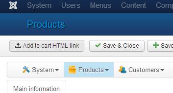

We used to have an 'add to cart html link' button just as it shows in the documentation here...
www.hikashop.com/support/documentation/i...ct-form.html#toolbar
But after upgrading to version 2.2.3 when we edit a product in the back-end, there is no longer an 'add to cart html link' button available. Why would this not be showing? Has it been removed or moved in version 2.2.3?

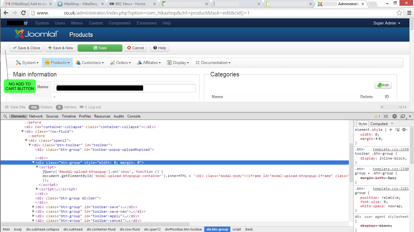

12 years 7 months ago #141528
Thanks for the reply...
Le button n'est pas la!
Regardez the attachment. It's not a major problem because I know the structure of the add to cart url already so I can just make it up from the product id, but it would be nice to have it back for other users. It was there in the previous version (2.1.3 I think it was).

12 years 7 months ago #141581
Le bouton est toujours présent de même que le code qui le génère (vous pouvez vérifier par vous même dans administration/components/com_hikashop/views/product/view.html.php en cherchant "ADD_TO_CART_HTML_CODE"). Etant donné que vous semblez être le seul à avoir le soucis, il se peut que cela vienne d'une mauvaise configuration ou d'une erreur survenu pendant l'update.
