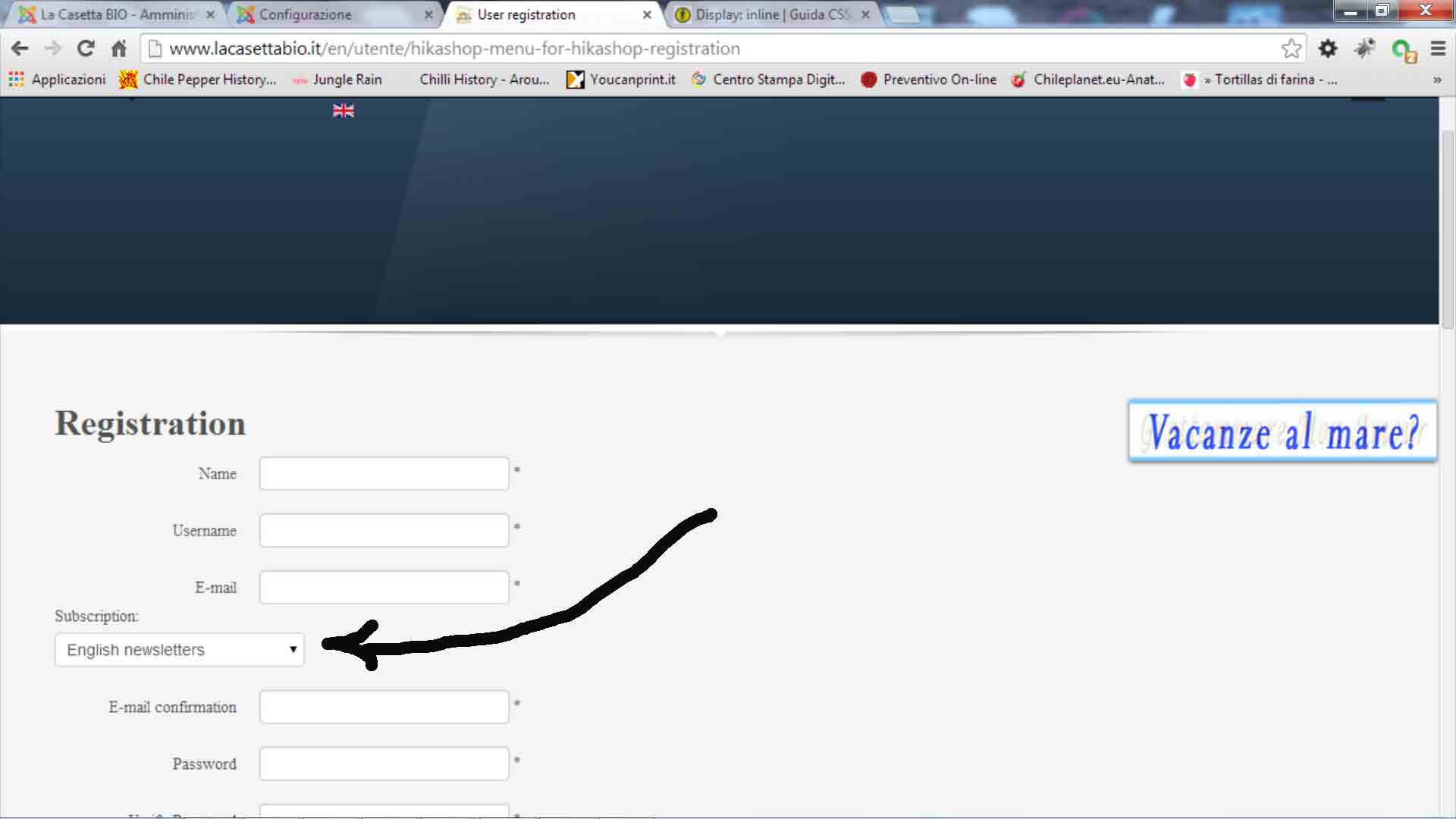

The first one is on the registration user form (screenshot 1):
the Subscription is out position. I use the "AcyMailing : (auto)Subscribe during Joomla registration".
I had no issue like that before bootstrap.

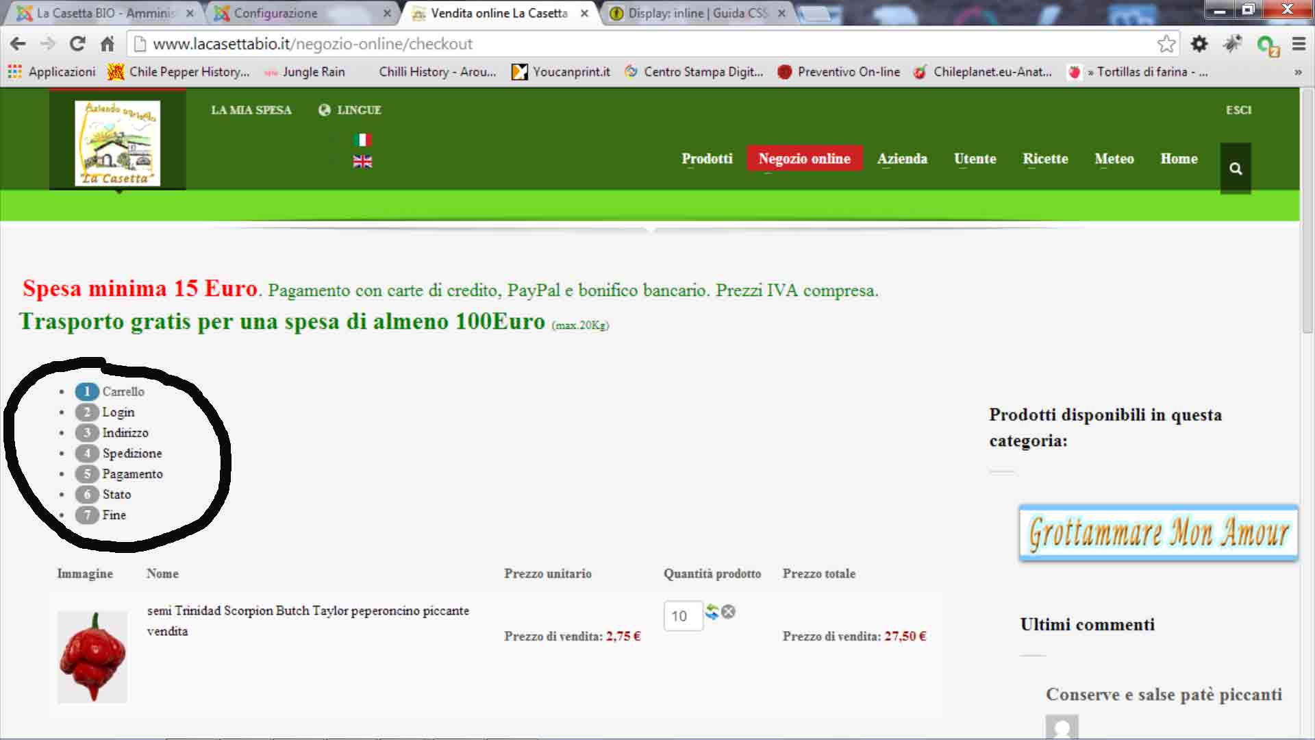

the second one is the breadcrumb. (screenshot 2):
it is vertical and i had it horizontal before bootstrap.

12 years 7 months ago #142330
The first point is generated by the Acymailing plugin. You have to active the bootstrap design in Acymailing too :)
For the second point I think that you have a customize CSS file. Our CSS file include the rules to display the new checkout bar.
If you use a custom CSS before the HikaShop update, you don't have the new CSS rules so you don't have the part for this.
You can look at "hikashop_wizardbar" in the original CSS file.
  • Posts: 719
12 years 7 months ago #142339
thanks for your answer.
first point: do you know where i could active the Acymailing bootsrap?
second point: yes i have a custom css file. I tried copying all the code "Hikashop_wizardbar"
[from the original to custom.
Now it seems to work.

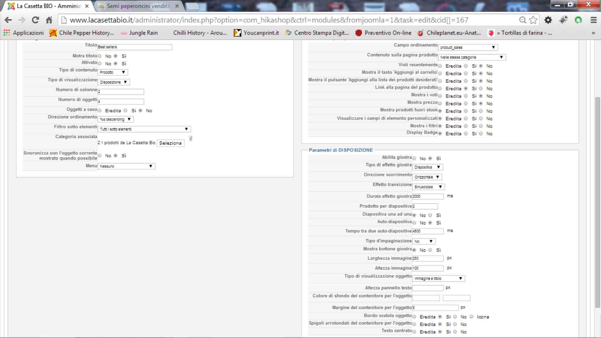

  • Posts: 2334
  • Thank you received: 403
12 years 7 months ago #142485
Interesting!
Could you give us a screenshot of your module configuration so we can visualize what it should look like?
Also, does it work with bootstrap disabled?
