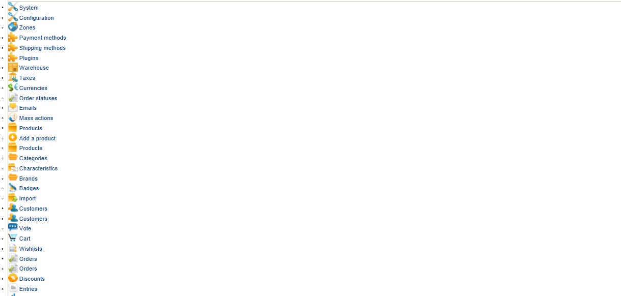

whys does my Hikashop menu look like this?

-- HikaShop version -- : Newest
-- Joomla version -- : 3.2.2
-- PHP version -- : x.x.x
-- Browser(s) name and version -- : IE

12 years 6 months ago #144584
This is usually a problem with the cache of your browser after an update. Please clear your browser's cache and try again.
PS: Please post your messages in the correct section of the forum.

I tried that and no luck. I also logged in with safari and it looks the same. Ok I will

12 years 6 months ago #145073
Do you use a special template ? If you don't use the default one, please change to the default one and try again.
Also, you can try to change the "menu position" option of the configuration of HikaShop, that might help.

In the front end I do have a special template. . Is that the one your talking about or is I the backend template?

12 years 6 months ago #145109
I'm talking about the backend

Hathor is my default template for the back end. and I cant find "menu position"

Can you set a different back-end template and try it again so that we can see if the problem is coming from your back-end template or not.
Thanks :).

I changed it to isis and its the same

Because you under Joomla 3, the menu is using bootstrap.
It is possible to deactivate bootstrap in the backend and use the "classical" menu, but at this moment, you won't have any bootstrap in the backend.
