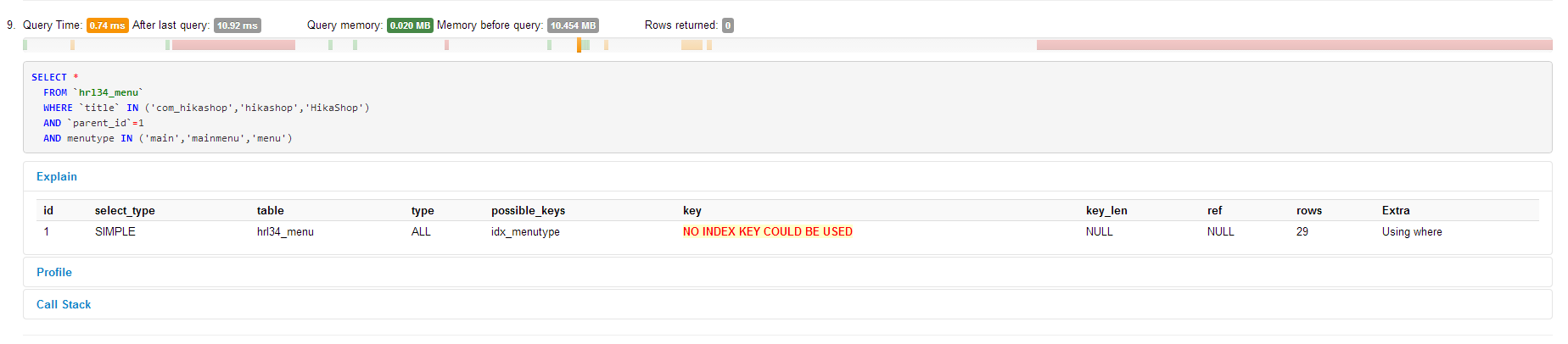

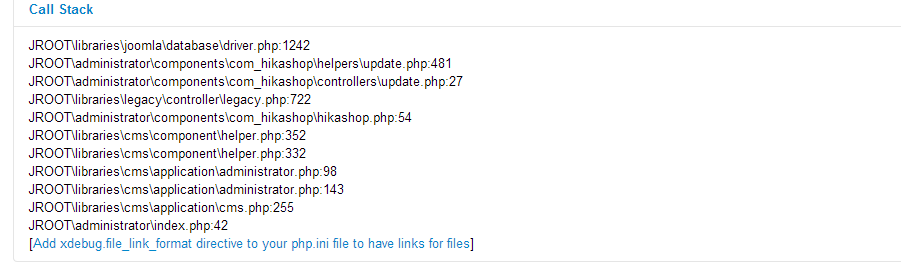

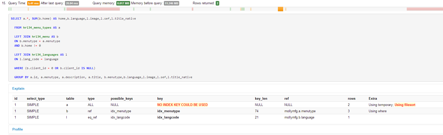

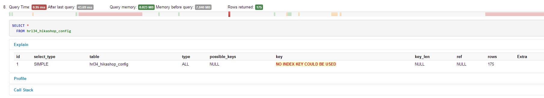

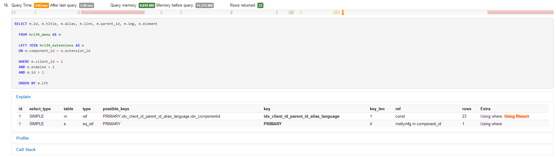

And I am sorry but, any of your screenshot help to understand the problem.
None of them are the query which creates the error so... It does not help us to help you.
