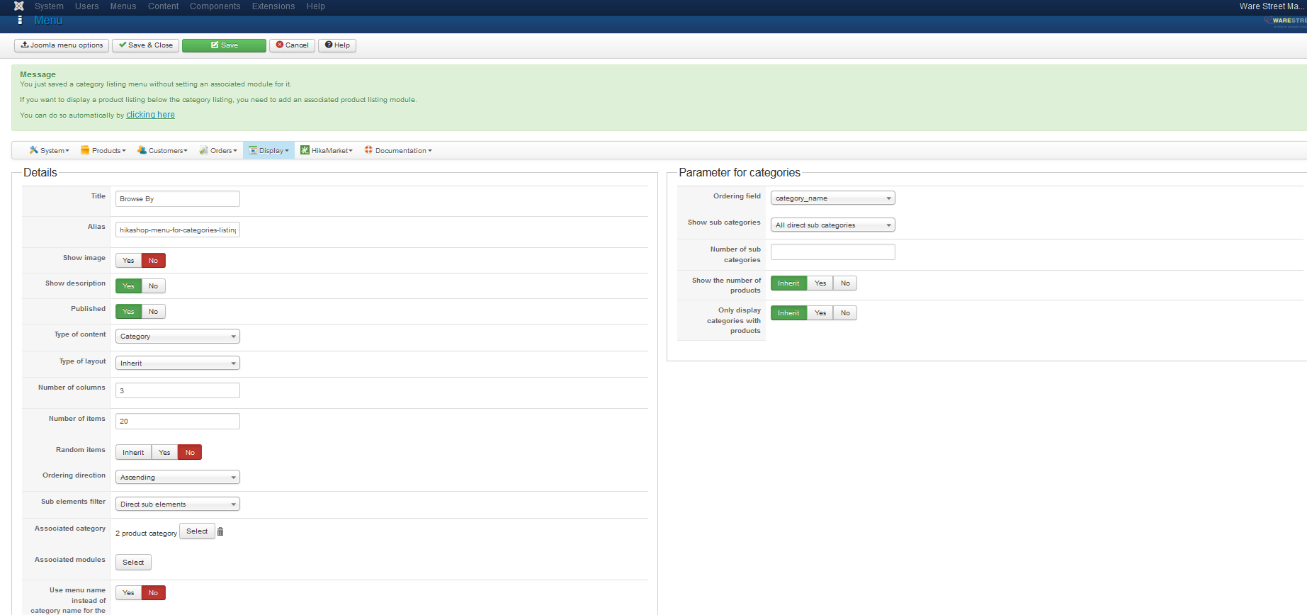

Hmm, that is what i was thinking however i have done this (please see attached) yet the products are still showing.

Are you sure that this screenshot comes from the options of the menu with the id 919 that we can see on the link that you gave ?
Because from all I can see, that's why you see it there.
Note however that removing the products listing module there is probably not what you want to do... Because otherwise, when you click on a category, you won't see any product. What you probably want to do instead is to keep that module there and instead change the "sub elements filter" option of the module so that it displays only the products which are directly linked to the current category.

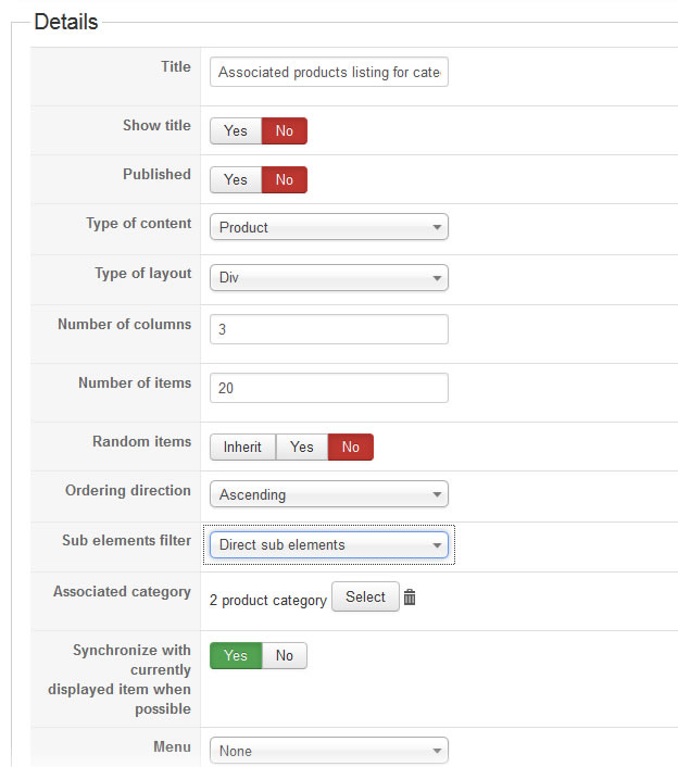

When i check for this module number 783 I can see the Associated products listing for category listing menu 1018 module. However i do not see an option to not display products? This module is not supposed to be associated with the menu item as i have removed it from the associated module for that menu item.

In the options of this module, you can set the main category for the category option and set the filtering on direct sub elements.
That should not display products.
Thanks to the browser console we can see that it's this module which is displaying the products.

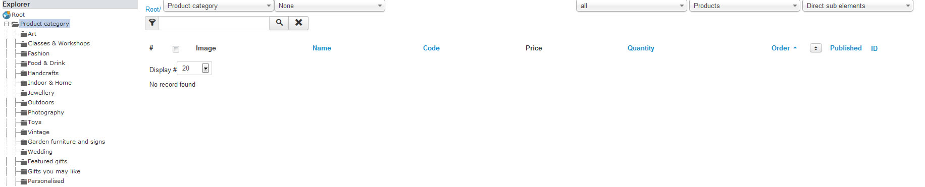

Yes 783 is definitely the one, i can adjust the number of products displayed etc and see the changes reflected. I have already set the display settings to direct sub elements only... which as you can see (attached) has no products in the root level of the main products category so shouldn't be displaying anything.
